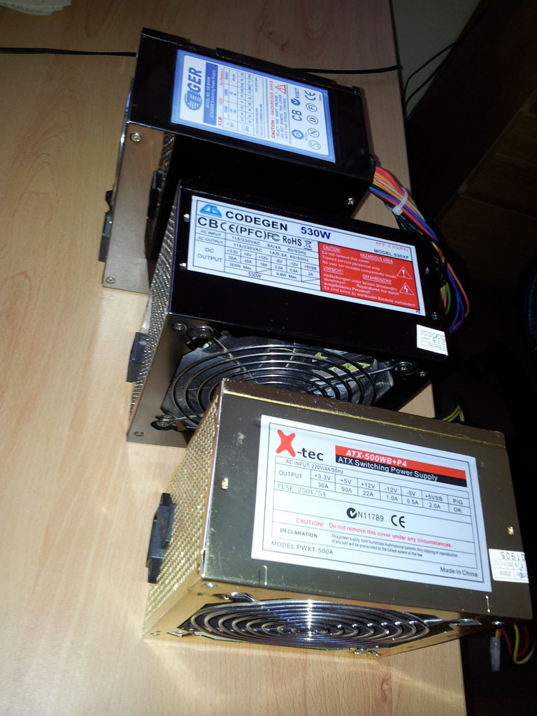

These "modern looking" low end PSUs are criminal. Half-bridge primaries were bad circa 2007, in 2013 it's abysmal... This collection of beauties were powering a C2D, i5-750, & i7-860...

c_hegge wrote:Bipolar switching transistors <snip> have much slower switching times than MOSFTEs
That's the key, switching speed. You can build a higher powered PSU with half-bridge, but the pennies you save there cost elsewhere. You'll need decent heatsinking, more bulk storage & larger main transformer. For example a Delta/Newton 350W dual P2/3 era PSU (~2000), employed a 10A bridge, 2x 1000uf primaries & ERL39 transformer all for only 15A@12V & 35A@5V. Now, the VRD specs were quite different then, but when circa 2010 half-bridge designs have 4x1.5A diodes, 2x560uf primary caps & ERL35s all on ATX spec 2.01 PCBs yet tout >20A@12V - call me unimpressed. That's without even looking at the secondary side.
c_hegge wrote:That's bad. I really wouldn't use those with a high end PC (or any PC for that matter)
Yeah. A friend upgraded his P4s to the Lynnfields. Thought he'd save a few bucks by reusing his components. I installed Seasonic S12 550w units a week later...
OT. I had an inkling you were doing the crappy PSU roundup pre-Christmas & was going to contribute a few of these units. Just didn't get around to it. I'm happy to send them to you for the next installment of measured torture.
