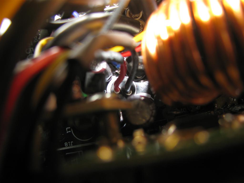

I kind of fixed one of them. I removed one of the two 470uF -12V filtering capacitors, and added two fairly beefy capacitors in its place - a 3300uF and a 4700uF. It's back down to just under 150mV now, which is still high, but miles better than it was.

The 3300uF is a Panny FC, the 4700uF is a Panny FR.
I can't figure out exactly what is causing it, though. I suspect it's some oscillation in the feedback loop, but my oscilloscope just isn't designed for probing around inside a PSU.
