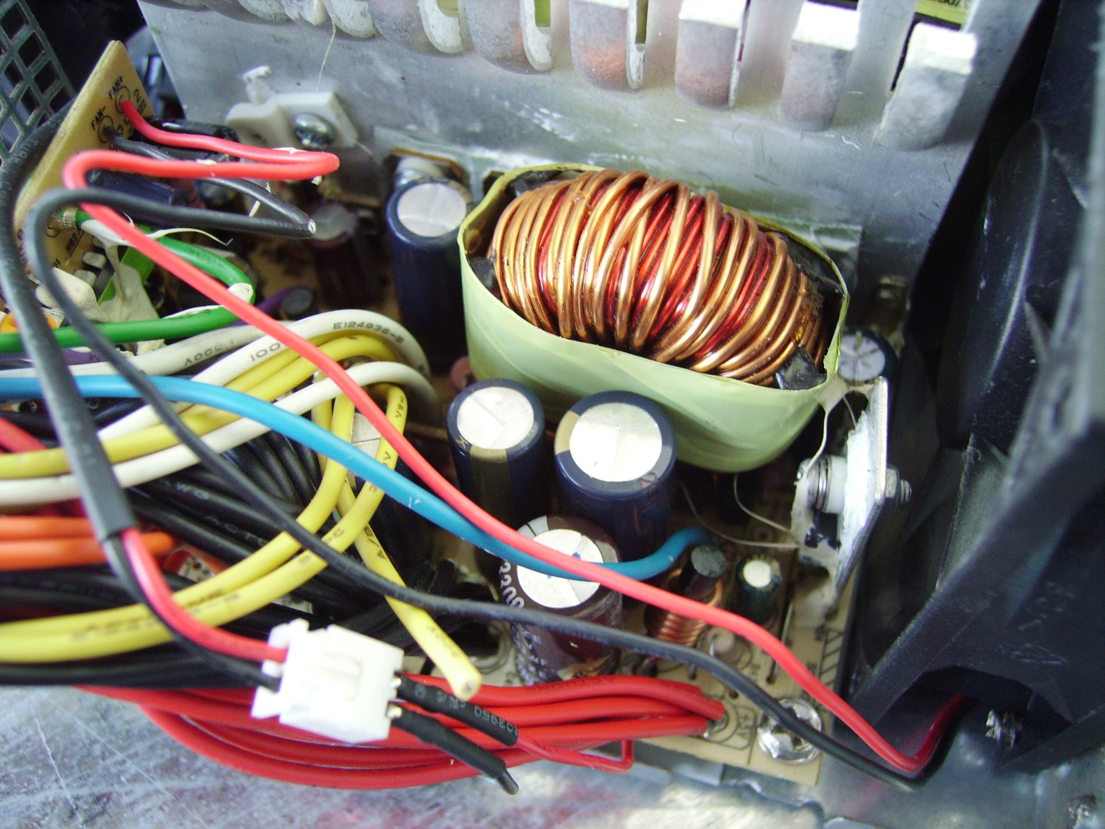

I'm surprised the power supply still worked given the discoloration caused by the hot load resistor next to that tiny Teapo.... if the PCB is really darkened, Chicony must have not chosen an appropriately spec'd resistor for the -12V rail. They have done that before in some old 200W Dell Hipros as documented by momaka a few years back on badcaps.
There was no lubricant left in the ADDA sleeve bearing fan, you say? So it must not have been spinning very fast at all until high loads? Or was it spinning about as fast as other temperature controlled and newer AD0812HS-A70GL fans you see used in PSUs?
And it looks to me like +3.3V has its own transformer tap separate from the +5V rail... do you mean that the extra transformer tap is in fact sharing the +5V rail's transformer pin judging by the underside of the PCB? Or maybe it does have its own transformer tap but is still connected to the +5V output? My reason for asking is that linear regulating +5V to +3.3V would waste tons of power.
That primary heatsink doesn't look bad to me at all... good thing that fan isn't mounted on the other end of the PSU, otherwise that passive PFC would be blocking lots of airflow to the primary side!
"It’s located on the other side of the heat sink, and, in most power supplies, is the first capacitor to fail, which is probably why Dell opted to use a Japanese part.".... not a surprise... when +5VSB is on the power supply is internally shut off otherwise which means no airflow and a much higher ambient temperature even with the very low load, especially with that diode being so close to the +5VSB capacitor. Also, you can't expect great efficiency when +3.3V is taken from +5V... I also think the FYP1010DN is freewheeling for the +12V rail. I don't know if that would make it good for 30A in forward topology? More like 26A at the most as evidenced by the review, perhaps closer to 24A-25A in warmer weather. It looks to me like they used an N-Channel Stripfet known as STP40NF03L to regulate the +3.3V rail. It also looks like Chicony's soldering quality has improved over time. Their soldering was not always this good and used to be average. I am also extremely pleased to see such low ripple (though voltage regulation could have been a tad better IMO), to be expected with linear regulated +3.3V. Any 3300uF Teapo SCs in there or was it 2200uF from what you saw (I spotted some 1000uFs in there)? And what was the bridge rectifier?
Also, was the Chemi-con capacitor a KZH? And was it 2200uF or 1000uF? ^^; Also, the power factor is somewhat low for a P-PFC unit... and judging by the datecode of those Teapo capacitors and the main and/or flyback transformer, this is a 2005 or 2006 power supply? One last thing... you don't think a wire grille would be more open for the fan? :P
EDIT: Also, I noticed that the fan is blowing/sucking cold air in the PSU rather than blowing hot air out... not sure if that's more or less effective. Did you catch what series the Nichicon primaries were?

Wester547 wrote:There was no lubricant left in the ADDA sleeve bearing fan, you say? So it must not have been spinning very fast at all until high loads? Or was it spinning about as fast as other temperature controlled and newer AD0812HS-A70GL fans you see used in PSUs?
I've seen that lots of times from ADDA. They usually don't give them any lubricant from the factory. They work fine at first, but don't last long
Wester547 wrote:And it looks to me like +3.3V has its own transformer tap separate from the +5V rail... do you mean that the extra transformer tap is in fact sharing the +5V rail's transformer pin judging by the underside of the PCB? Or maybe it does have its own transformer tap but is still connected to the +5V output? My reason for asking is that linear regulating +5V to +3.3V would waste tons of power.
You're right. I have fixed up that bit. The 3.3V rail does have it's own transformer pin (it was the freewheeling side that was shared :blush: ) I don't know how I made that mistake. In any case, though, it definitely uses linear conversion, which probably explains why it was so inefficient, despite being a forward design.
Wester547 wrote:That primary heatsink doesn't look bad to me at all... good thing that fan isn't mounted on the other end of the PSU, otherwise that passive PFC would be blocking lots of airflow to the primary side!
It is shorter than what most use, but I agree that it's very thick, and its fine for this PSU
Wester547 wrote:I also think the FYP1010DN is freewheeling for the +12V rail. I don't know if that would make it good for 30A in forward topology? More like 26A at the most as evidenced by the review, perhaps closer to 24A-25A in warmer weather.
I think 30A would be just fine. It has a massive heat sink, and there's no way it's gonna heat up anywhere near 150*C. I've pulled the rectifier's ratings (and more) lots of times in forward topology. In this case, I would say the primary side was beginning to max out. Since this is group regulated, the unit was probably trying to keep the 5V rail in spec, but letting the 12V rail drop (which is common when a PSU is adapted from an older design)
Wester547 wrote:It looks to me like they used an N-Channel Stripfet known as STP40NF03L to regulate the +3.3V rail. It also looks like Chicony's soldering quality has improved over time. Their soldering was not always this good and used to be average.
Interesting. I don't think I've ever seen a bad soldering job from Hipro, even in older units. They do occasionally leave component pins a bit too long, but they've always been miles better than some others (*cough* CWT *cough*)

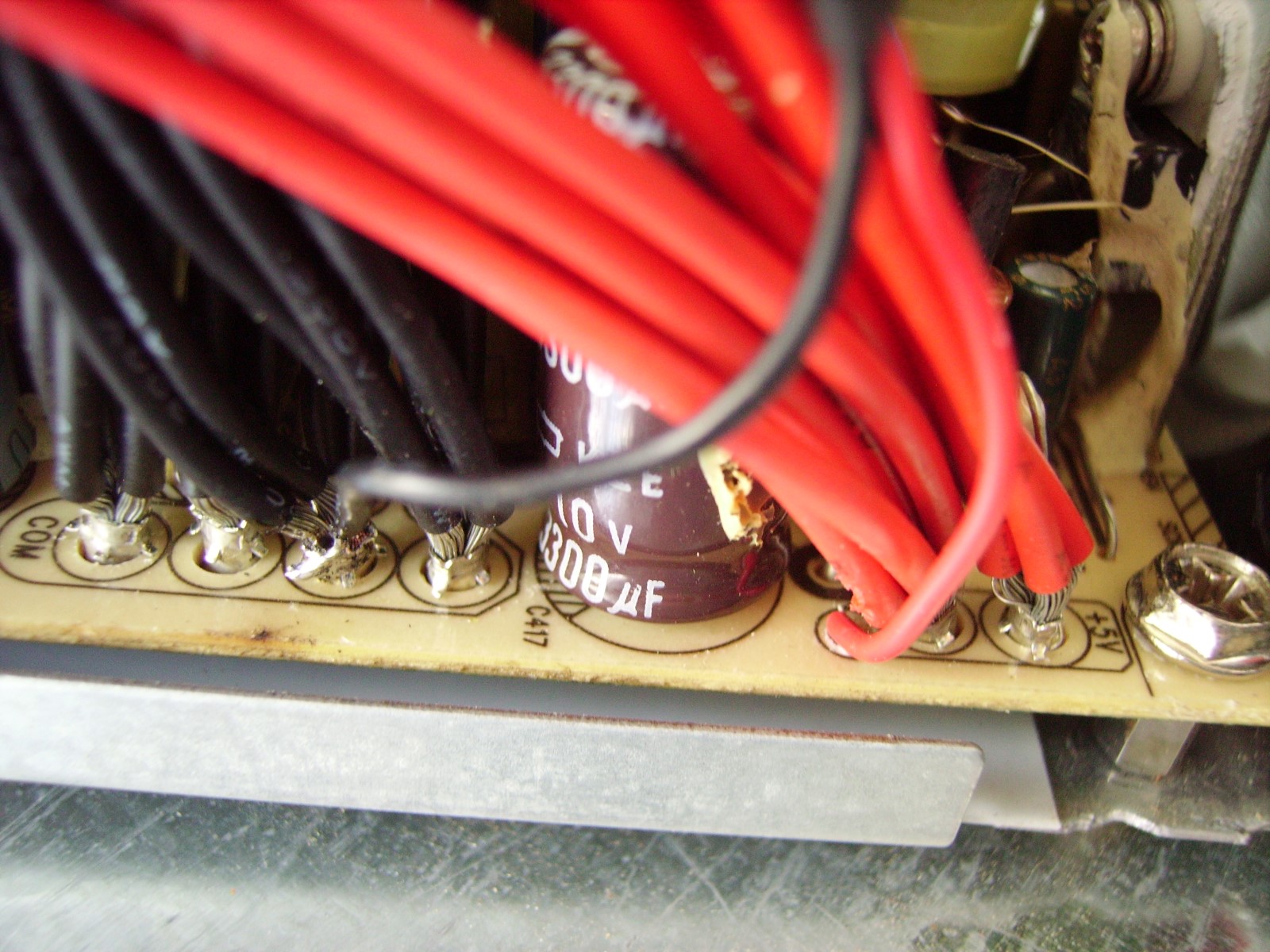

Wester547 wrote:( Any 3300uF Teapo SCs in there or was it 2200uF from what you saw (I spotted some 1000uFs in there)? And what was the bridge rectifier?
Two 2200uF on the 12V Rail, a 4700uF and a 3300uF on the 5V rail, and three 1000uF on the 3.3V. I'm not sure what the rectifier was. The part number side was stuck on to the heat sink. Knowing Chicony/Hipro, though, probably 6A
Wester547 wrote:Also, was the Chemi-con capacitor a KZH? And was it 2200uF or 1000uF?
2200uF 10V KY Series
Wester547 wrote:Also, the power factor is somewhat low for a P-PFC unit
That's pretty normal to me. I think 230V usually causes better efficiency, but a lower power factor than 110V.
Wester547 wrote:and judging by the datecode of those Teapo capacitors and the main transformer, this is a 2005 power supply?
Maybe, but it doesn't seem to have had a lot of use. Most stuff from that era would be packed with dust and have bad caps by now.

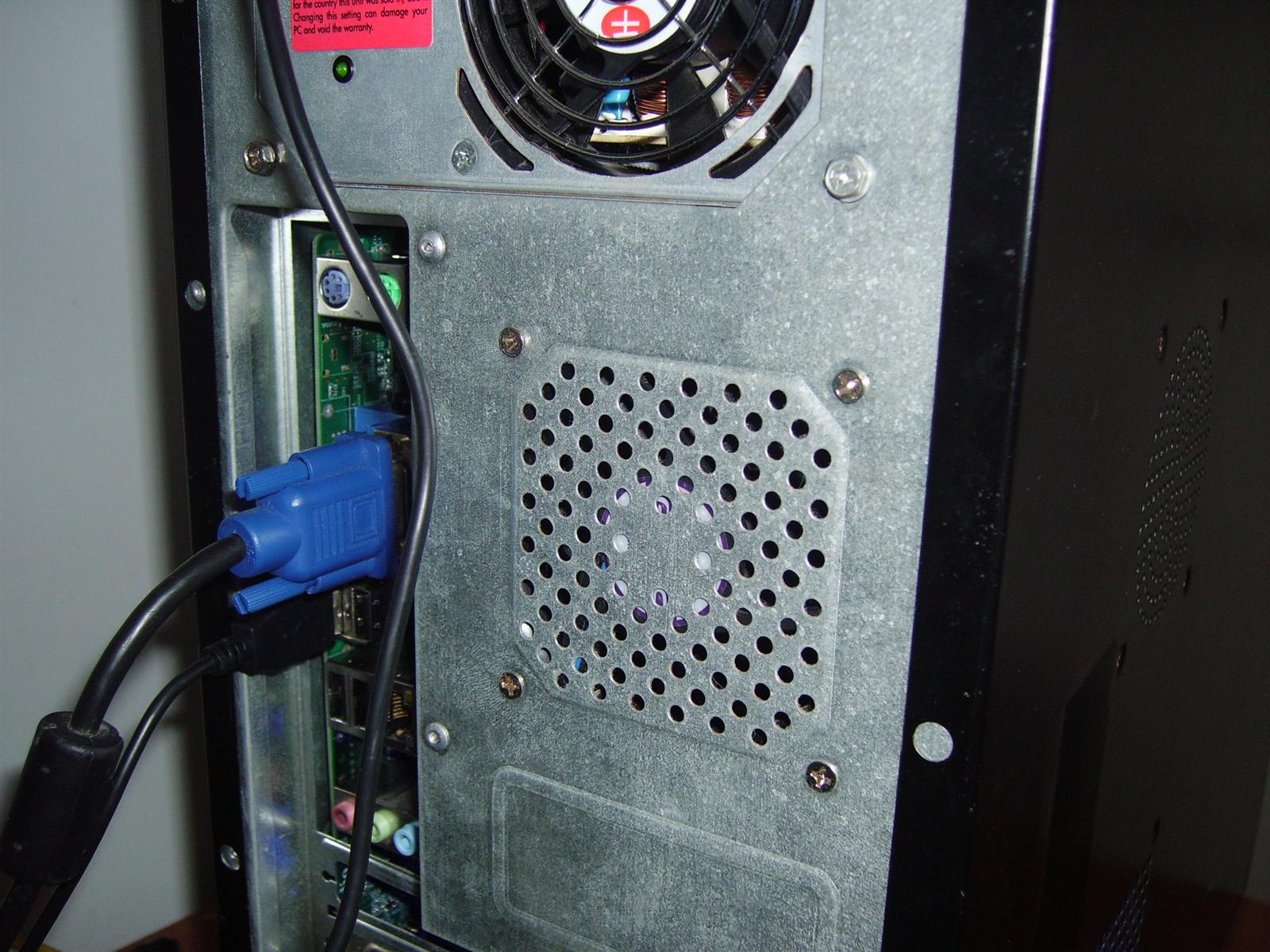

Wester547 wrote:One last thing... you don't think a wire grille would be more open for the fan? :P
Yes, I agree, but honeycomb grilles are a close second. I don't think it's enough of a problem to really knock it for. At least it's not like this...

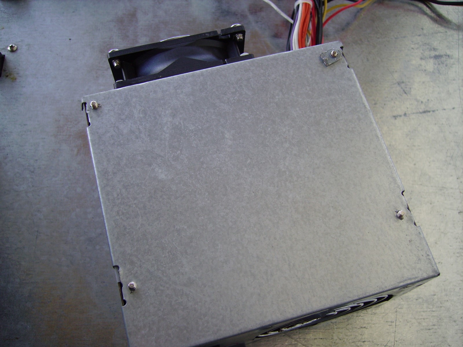

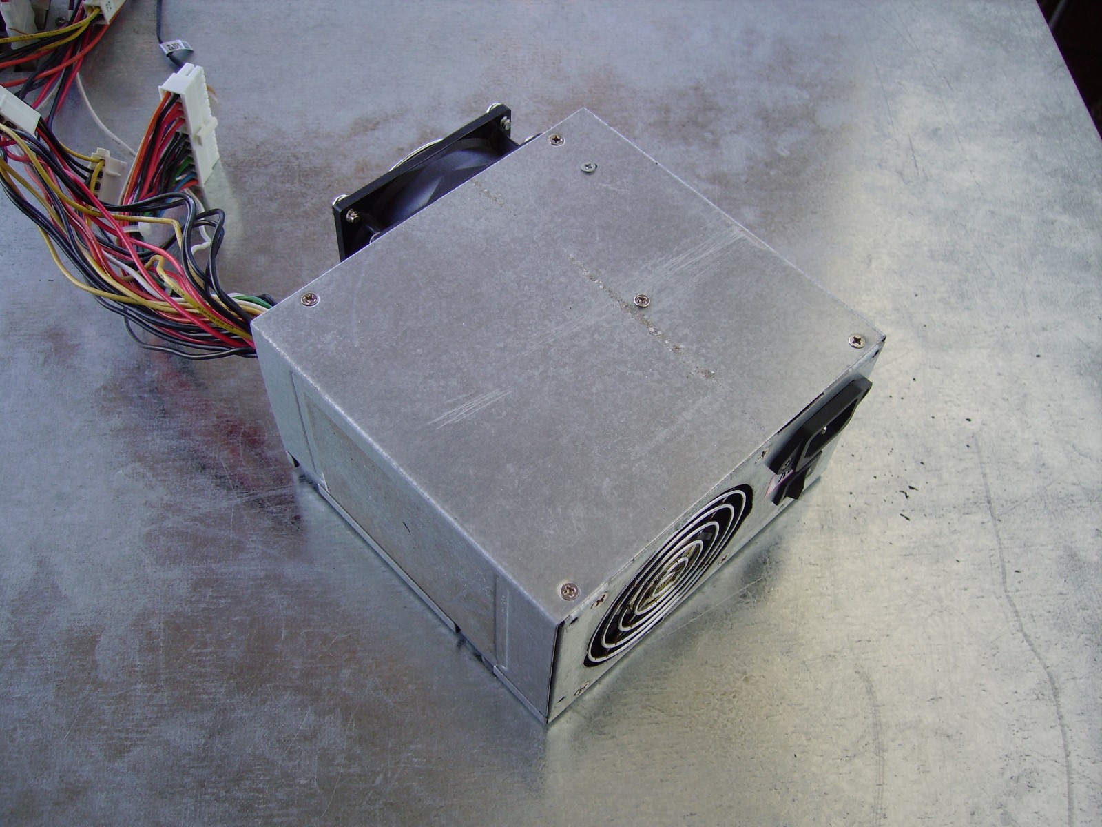

Here's what became of this PSU.

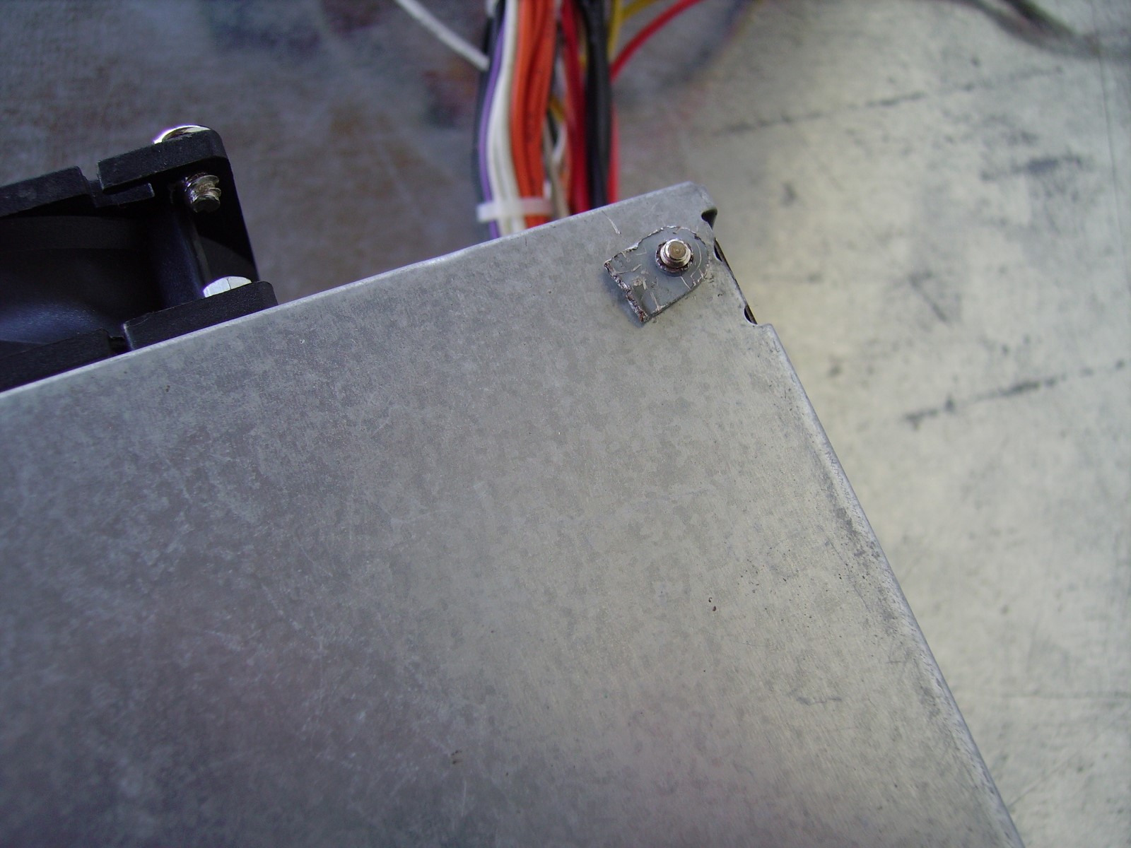

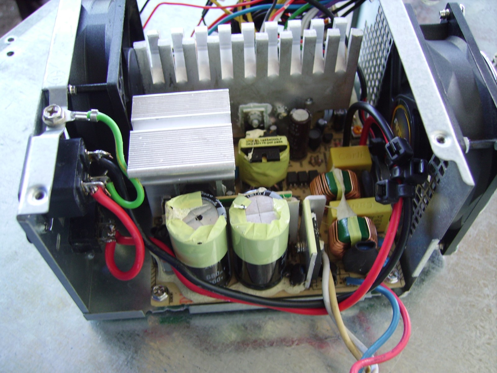

It was rebuilt into a new case. The case came from a gutless Deer PSU (a Mirage branded 500W). It even had screw holes in it for a second front 80m fan
Unfortunately, the screw holes were a bit different, so I snapped off the original screw hole tabs, and drilled some holes in the bottom of the case and installed motherboard standoffs
Erm, I made that hole a bit too big. I used one of the tabs as a nut.

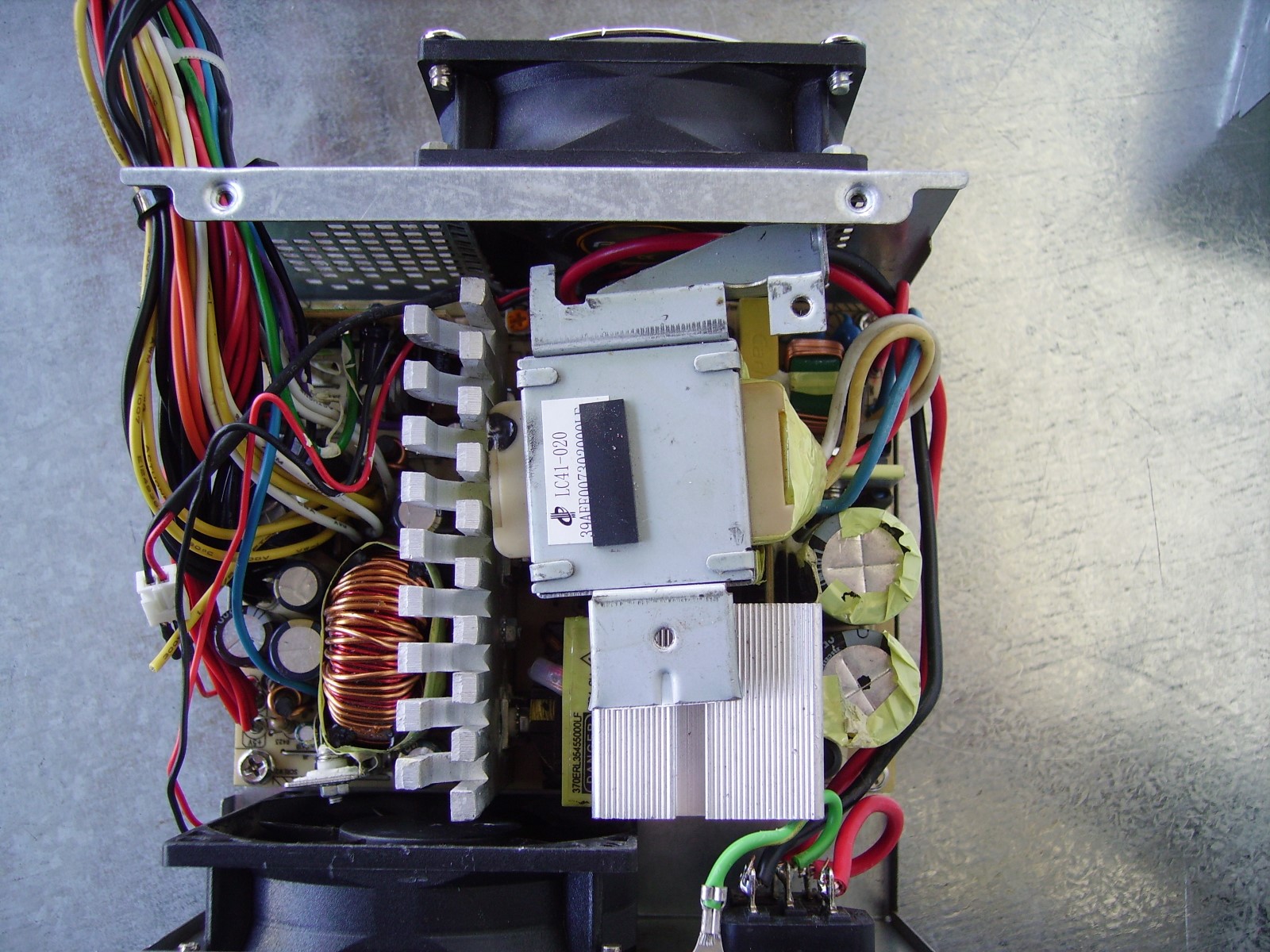

Internals
PFC Choke out of the way
If you know me, you know that those Teapo caps didn't have a chance. The only ones I left in place were on the -12V rail
I originally wanted to solder the second fan to the fan controller, but it couldn't supply enough current for both fans. With the two connected, they would only get 2.8V each and run so slow that you could still see the blades, so I left the rear fan connected to the controller, and I soldered the second connector to the 5V output.

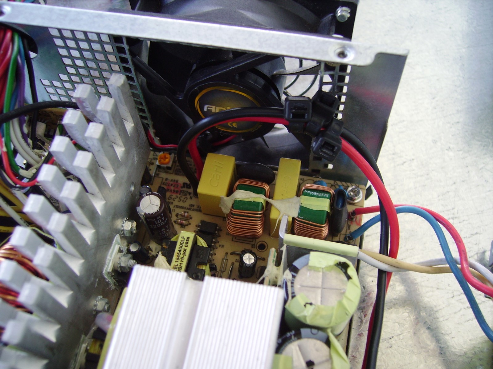

The primary side. Yes, I did cut out the grille in front of the fan
The AC wires were too close for comfort to the cut out area of the grille. I used the zip ties to stop them from rubbing on the metal
