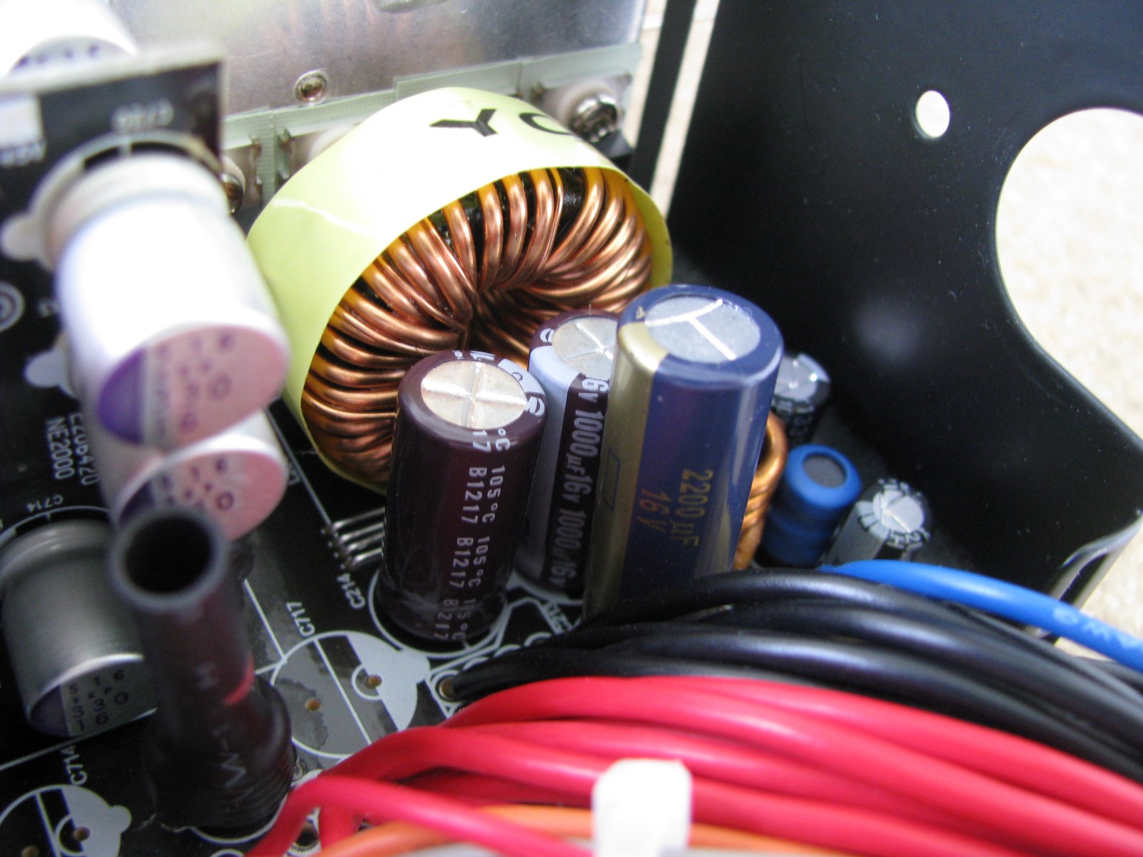

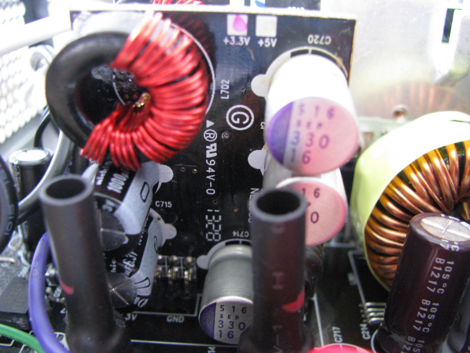

I did recap it. For the 12V, I used a 1000uF 16V Nich PW for the cap before the coil, and a 2200uF 16V Panny FK after. It was only about 10mV lower on the 12V rail, and no better at all on the other rails. I also polymodded the VRMs with 330uF 16V OS-CON SEP, and 1000uF 6.3v Fujitsu RE caps.

The 12V section. Two Nichicon PWs before the coil, and a larger Panny FK after.
The 3.3V VRM. I used Nichicon HM for the two 1000uF caps on that one. The 5V rail got the Fujitsu RE polys

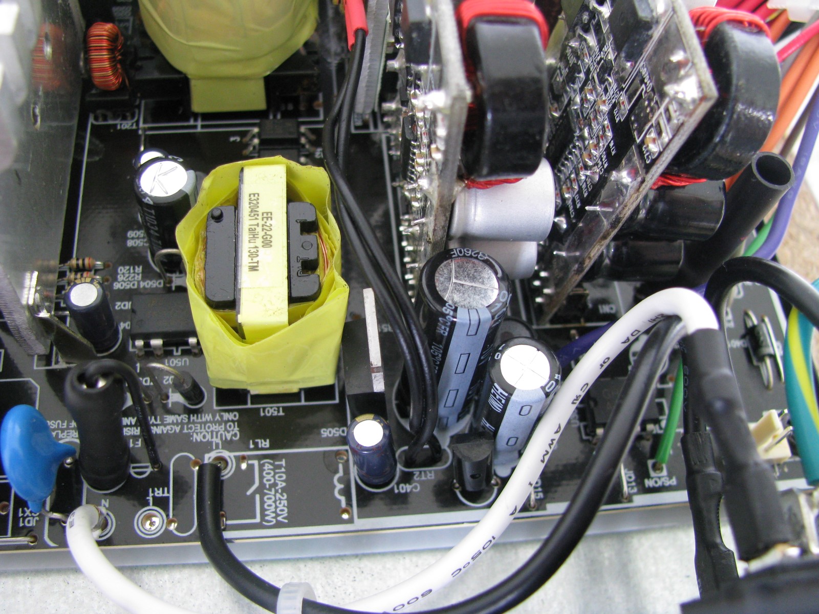

The 5vsb. Note how I also leaned the rectifier away from the cap
