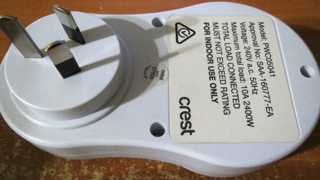

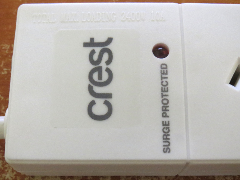

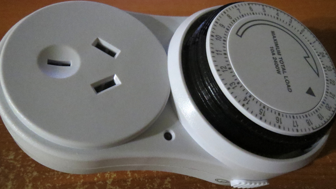

Crest PWC05041 (Cixi Yidong Electronics TA‑7)
Postby LongRunner » February 19th, 2023, 8:03 am

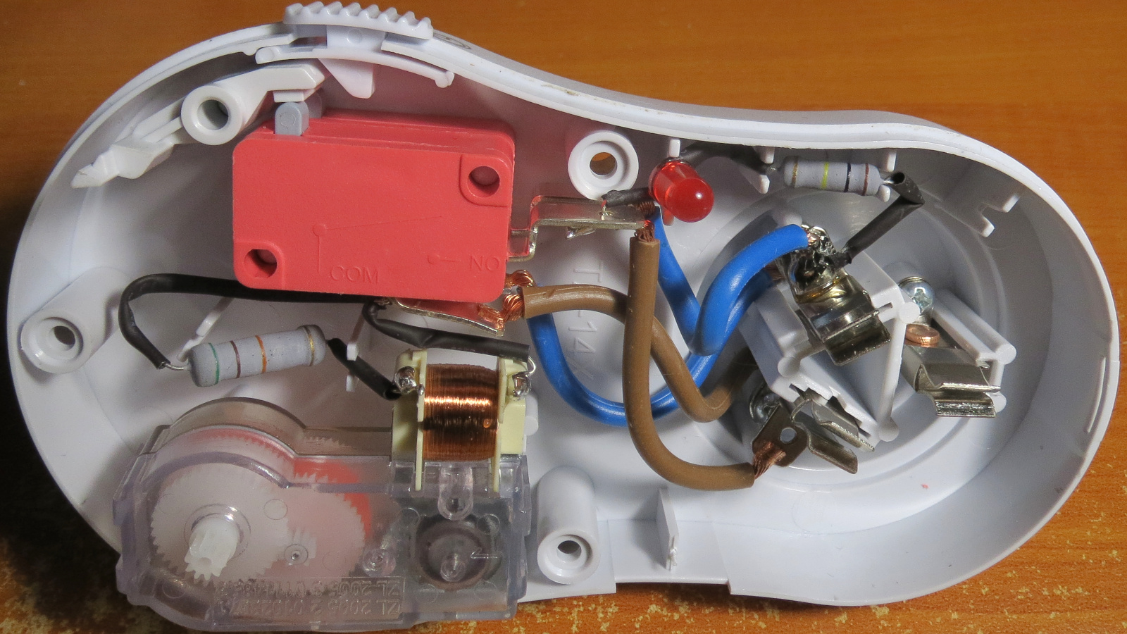

Superficially, it's your standard 24‑hour rotary time switch with on/off tabs per 15 minutes. They tried to keep me out with yet another weird screw type (with 3 slots in a triangular formation at the perimeter), but my divided‑blade screwdriver (out of which I cut the notch myself) engaged them anyway :mrgreen:.
Switch open.JPG (216 KiB) Viewed 164433 times

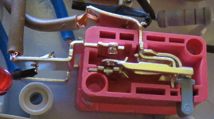

Switching is double pole using two red microswitches rated for 16(2)A 250V. Their only steel part is the dummy (normally closed) contact, which is OK by me. (You'd think they could have announced double-pole switching as some other brands do, but now you know anyway.) Being two separate switches (with independent snap actions) does theoretically raise a concern that one could switch on some time before the other, but when I tested it they do click on in tandem. These are branded Cixi Yidong Electronic Co., Ltd, which indeed manufactures the whole device (it looks nigh-identical to model TA‑7 here, although searching the approval number instead gives results mostly of the form *TA‑14). The load wires are spot‑welded to their terminals, only the motor and LED connections are soldered here (very shiny solder though). The timer mechanism is unremarkable, using a typical teeny 10-pole (600RPM at 50Hz) synchronous motor of minimalist design (omitting 4 poles from the stator) with a gearbox.
A tad pinched at the LED anode, but I'm still willing to count the screw post as basic insulation and deeply-recessed screw hole as supplementary.
The LED series resistor is 100kΩ ±5%, but there's no rectifying diode so it will dissipate 576mW at 240V (typical) or 734mW at 264V and −5% tolerance (worst case); the resistor is accordingly 1W judging by its dimensions (11mm long, 3.6mm diameter), although it will get hotter than comfortable for the (ABS?) housing so would have been more-appropriate with the rectifier. Also, it actually measures 110kΩ so must be mismarked (I've verified my DMM against spare 100kΩ ±1% metal film resistors), not that this relatively-minor error would do any damage. The input measures 54.4kΩ across, which comes from a 51kΩ ±5% 2W (15mm long by 4.8mm diameter) resistor (measures 50kΩ) in series with the motor coil (4.39kΩ cold); this resistor will get moderately warm, dissipating 723mW typical (at 240V assuming the motor is 48V) up to 921mW at 264V and −5% tolerance, but nothing tragic.
59mm wide at the plug/socket portion, the unit won't fit beside a plug in a normal outlet but does fit comfortably in the end socket on Crest's power‑boards, which is more than I can say for some other time switches (Arlec PC844, Kambrook KD84) with large square or rectangular bodies (71mm and 69mm wide respectively).
That just leaves a load test: Since the switches are 16A rated I applied that straight away; it got quite hot, but survived alright so 10A will be fine.
Conclusion
It was close to being decent, but the missing rectifier in the LED circuit lets it down. No worries, I have plenty of 1N4007s which I can add myself…
UPDATE 2023-03-01: Jackson Industries also sell it as the PTT1155 (despite being Crest's competitor otherwise), so you might as well have their lower price.

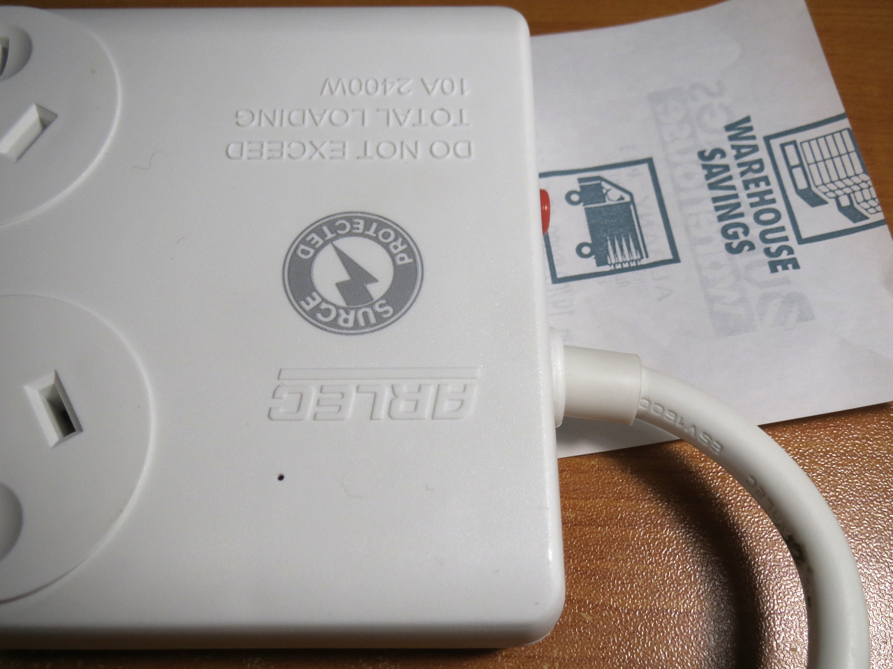

Arlec PB12PP (not listed on Arlec's site)
PB12PP cord end.JPG (374.88 KiB) Viewed 164432 times
This is technically an addendum to my cheap power-board challenge from two months ago, as this model is a bigger sister to the CLKPB4 and CLKPB6 revision shown there (while branded different, the general design and approval number are shared, the cardboard sleeve is done in the same general style and even gives the same customer service numbers). Although not nearly so cheap, at AU$23.79 it's still quite reasonable for 12 outlets (of which 5 are wide‑spaced for bulky plug‑packs). Unfortunately the local Bunnings has run out of the decent CLKPB6 and replaced it with an inferior version (containing ordinary low-life contacts), with the CLKPB4 undoubtedly next to go; but this model remains.
The seven normal sockets are at the usual 45mm intervals, with the five wide sockets at 65mm intervals (so the mid-row sockets are horizontally 5mm apart, and 10mm at the incoming end). Unlike the 4 and 6 outlet models, there's a sleeve at the cord entrance and a surge suppressor as standard equipment.
Strangely, mounting points are absent from the back of this model (the CLKPB4/6 do have them), as a few customer reviews (on Bunnings' page) note.
It's held together with no less than 15 screws. I've also seen an 8 (5+3) outlet + 2 USB variant in Bunnings.

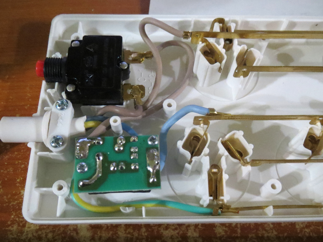

PPB12PP inside.JPG (462.53 KiB) Viewed 164432 times

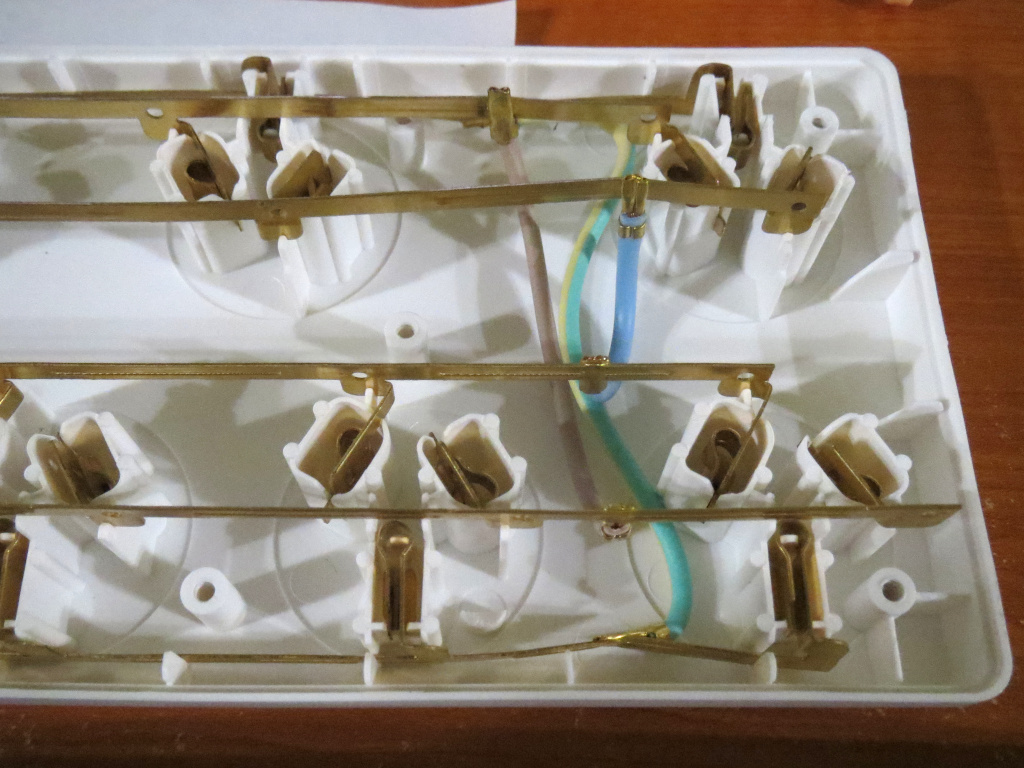

Unlike in the CLKPB4/6, the breaker connections actually are welded in this one (although both A+N go through soldering on the surge suppressor anyway).
PB12PP inside far end.JPG (300.22 KiB) Viewed 164432 times
Jammed contact.JPG (448.01 KiB) Viewed 164432 times
One earth contact was half-stuck, but it still made some contact with the pin; the same socket's neutral contact was somewhat mis-seated (the bar wasn't aligned in its proper guide slot, instead being pressed in hard enough to dig another slot), but both defects were easy enough for me to fix.
PB12PP contact standoffs.JPG (168.72 KiB) Viewed 164432 times
The contact supports are actually box sections rather than the “L” pieces in CLKPB4/6, and the breaker reset button isn't awkwardly recessed inside.
The surge suppressor is reasonably well thought-out (for an MOV one), with both thermal and overcurrent fuses like in the Crest models (although the load stays on, so in a surge severe enough to blow the fuse, it won't save your devices). The red LED is fed half-wave through a 200kΩ ±1% metal film resistor, which may be 0.25W or 0.5W based on its size; either rating is quite sufficient (144mW typical at 240V, 176mW maximum at 264V and −1% tolerance), and the epoxy-fiberglass PCB will be fairly heat-resistant (they're usually rated to 130°C, and my calculations suggest 100°C worst-case in a 40°C ambient).
The incoming neutral wasn't fully inserted and had 4 stray strands (by my count), but it should still survive the load test.

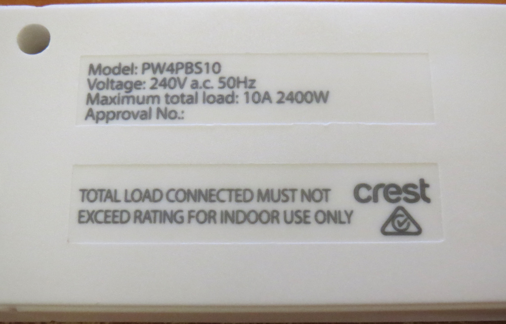

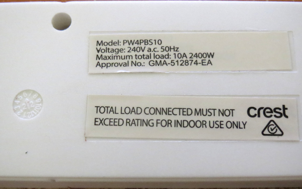

Maybe they'll add the approval number here later.

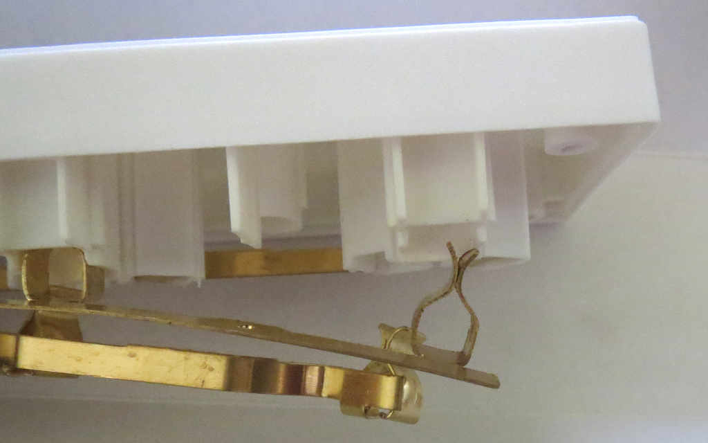

The earth contacts have different geometry from the KF‑MSD‑4A, but are still about 2mm taller than the active and neutral parts (for extra safety).

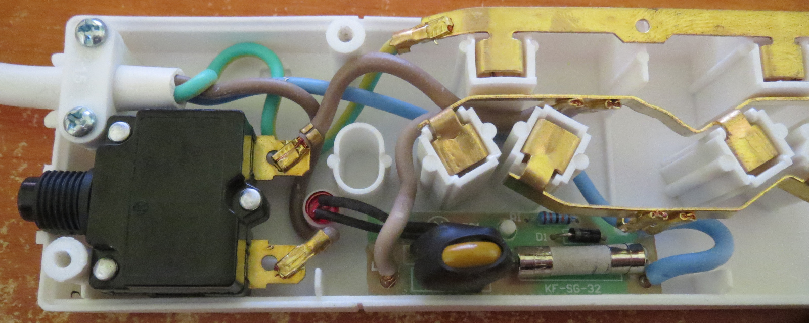

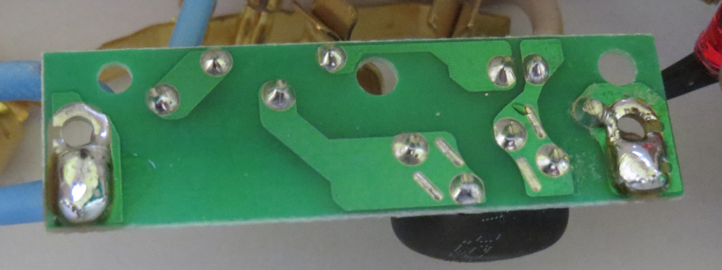

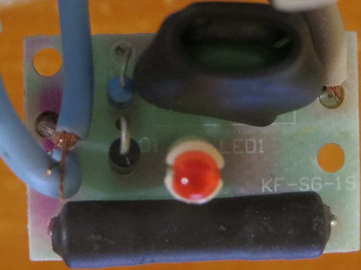

KF-SG-32 solder side.JPG (139.33 KiB) Viewed 164432 times
The surge suppressor has a different PCB layout, but the same circuit as in the PB12PP (except that the LED resistor is 220kΩ).
This time the overcurrent fuse has no heatshrink sleeve, so I can see that it's T6.3AH 250V. (Which is perhaps better than the PWA04984/5's F3.15A.)
There's one stray strand on the active wire, but that's no big deal.

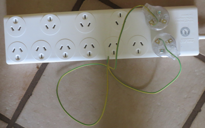

Since incoming active in the PB12PP goes to the 5 wide sockets (with incoming neutral and earth to the 7 narrow sockets), I've made an even scarier shorting lead:
Don't worry, I disbanded it after the test
Dangerous test lead.JPG (125.47 KiB) Viewed 164432 times
Overloaded to 20A, the two boards tripped in 12 and 13 seconds respectively; at 25A, 6 seconds each; and at 30A, 4 seconds each.
I did the sustained load test (11A) for both boards (plus two spares while I'm at it :mrgreen:) in series to save time; no trip in well over an hour.
Conclusions
The PB12PP cuts fewer design corners than in the CLKPB4/6, but my unit had a few more QC niggles so gets a C− again (if the quality control was remedied, it could get a C+). While you can buy more-expensive models, I'm not so sure you can get better; so it's still decent value overall.
The surge suppressor also gets a C− from me (C+ being the highest grade I'll give to an MOV suppressor, given a 20mm+ MOV and fireproofing).
Although the PW4PBS10 superficially looks worse than the PWA04984, its socket contacts are actually an upgrade and surge suppression remains equally decent (another C−). It isn't quite as well-made as the plain KF‑MSD‑4A, but the contacts are still up to par so it earns an overall C.
The only real losses are the cord length (arguably compensated by its better flexibility), and that one wide-spaced socket on the PWA04984/5.

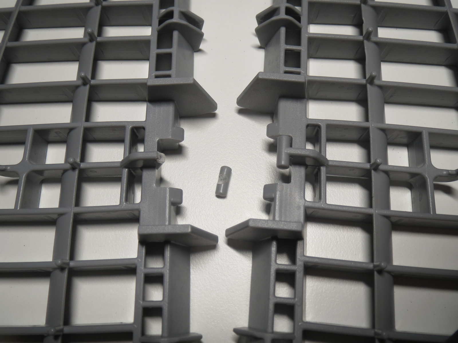

  • Ariston LFO3C22 dishwasher: Like their tumble dryer (mentioned in round 10), is made in Poland with a PATELEC cord (though H05V2V2-F3G1.0 this time) and 5-year warranty; unfortunately I've already broken one of these things (it always pisses me off when they make a relatively large and substantial piece, only to anchor it with the weediest pegs they think they can get away with):
    Broken piece.JPG (508.4 KiB) Viewed 162569 times
    The cutlery basket also has significant flash in some of the bottom holes.
    Its door also feels lighter than on the LG, but hopefully the electronics will hold up better…
