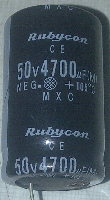

Postby Behemot » January 1st, 2024, 3:11 pm
Run into this fake wannabe Rubycon MXC, print has wrong layout, that NEG. whatever stuff is all made up, vent is also wrong. Case size is also wrong, no such as D22×35 mm exists in the datasheet (although there is a possibility of custom part). As could be expected, it rotten its electrode off and is also slightly bulging. Been added manually to bridge rectifier for smoothing 24 V inside a garage car lift (to power contactor coils).
