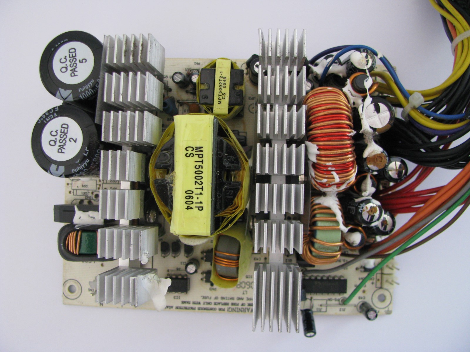

Postby c_hegge » November 26th, 2013, 8:44 pm
Here's an internal shot of my MPT-4012. It looks quite capable of the labelled 400W. It just needs a recap.
Re: Suggestion: Macron MPT-xxx and MPT-xxx2
Postby LongRunner » August 19th, 2014, 8:04 am
It's been a while, but I've found a few nits to pick with the family:
Original MPT series
  • The mains wires were of the reinforced type (UL AWM style 1617, which has both the thick inner insulator like style 1015 but also a thinner outer jacket for added safety), which is good as they can be in fairly close proximity to the secondary side of the unit (and indeed can touch the secondary heatsink — which, for that matter, was not earthed as it is in many units including the following generation — very easily). But while I appreciate the use of a mains connector, the connector they chose is not designed for wire with such a large outer diameter and while the conductors are crimped fine, Macron's attempt at crimping the outer jacket was kind of ugly. All it would have taken to do it properly would have been to remove about 5~10mm of the outer jacket from the leads where they are attached to the connector.
  • CY1 (one of the Y capacitors on the main PCB) tends to be installed with one of its leads in a hole for R1 (a bleed resistor for the X capacitor on the main PCB that was provided for but never installed as the additional filter board already has one) instead of the intended hole. Functionally, it doesn't matter as it connects to the same part of the circuit anyway, but it does look somewhat unprofessional.
  • At the upper end of the normal mains voltage range, the bleed/divider resistors across the primary capacitors are running fairly close to their power rating (they are 150kΩ ±5% carbon film and appear to be 0.25W going by the size; with the European/Australian upper limit of 253VAC, there is 178VDC or so across each resistor and they dissipate about 0.21W each). There is no discolouration of the PCBs that I've seen, so the beefy traces in the area seem to do a fair job of conducting that heat away, but I do think it's an ever-so-slightly bad idea to go that close to the rating of resistors whose failure would be the end of one of the primary capacitors. Their counterparts in my MPT-4012 appear to be identical.
  • In the earlier 80mm-fan version, which had a mains pass-through outlet, the wiring arrangement placed that outlet between the two stages of the EMI filter. This has two implications — some common-mode noise will make it into whatever is plugged into that outlet (though I doubt most common loads would be adversely affected) when the PSU is active, and if too much current is drawn through that outlet (especially with the unit in standby mode), the filter choke could get rather hot.
MPT 2 series (not that I've found another unit, but the PCB does hint at models from 300W up to 500W)
  • The original MPT series had a ceramic fuse in a holder, but all we get this time is a cheap glass fuse soldered directly to the PCB (though the through-holes for fuse clips are still provided). The NTC thermistor is clearly marked as 2.58Ω cold (though my DMM reads 3.3Ω…), so might just allow the fuse to contain itself when cold, but with the thermistor hot…?
  • The datasheet for the WT7525 suggests that capacitors of at least 1µF be installed between the current sense and voltage sense pins to prevent nuisance tripping of the OCP, and they are all provided for on the underside of the PCB, but none of them were installed. :huh:
  • Possibly as a result of realising that the mains-to-PCB connector they use isn't designed for the thick reinforced wires they used last time, this time they used single-insulated mains wires (UL AWM style 1015 as mentioned) and instead chose a non-shrinkable tube to provide the extra layer of insulation in the vicinity of the secondary side (the only reinforced wire remaining is that from the first stage of the filter to the main switch). But (in my unit, anyway) the sleeve fails to stop the active/line wire to the board from touching the top of one of the +3.3V caps (the one before the ferrite coil), so it looks like they could have done with a bit of heat-shrinkable tubing there (or simply use the reinforced wire again, but strip the jacket where appropriate). (Fortunately, you can simply use a shorter 12.5mm diameter replacement cap and avoid that bit.)
