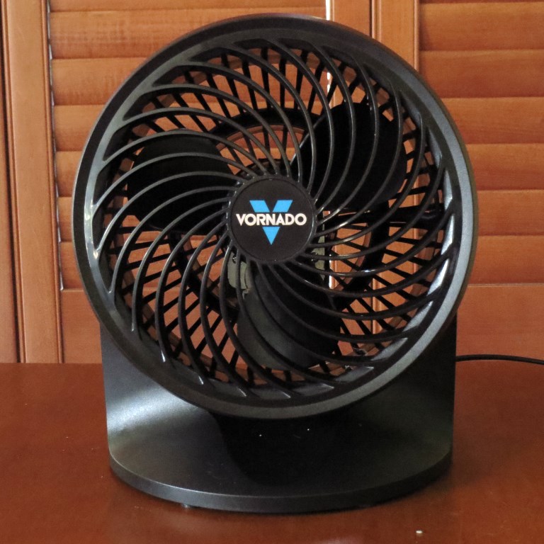

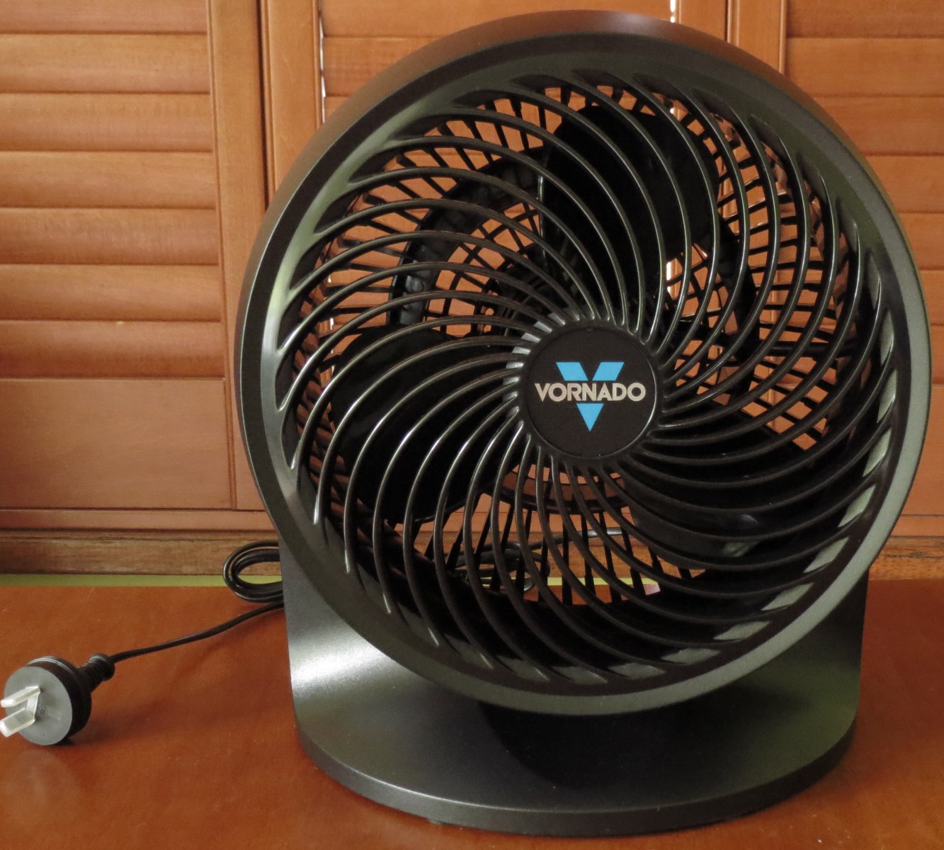

Front view.jpg (292.6 KiB) Viewed 80484 times

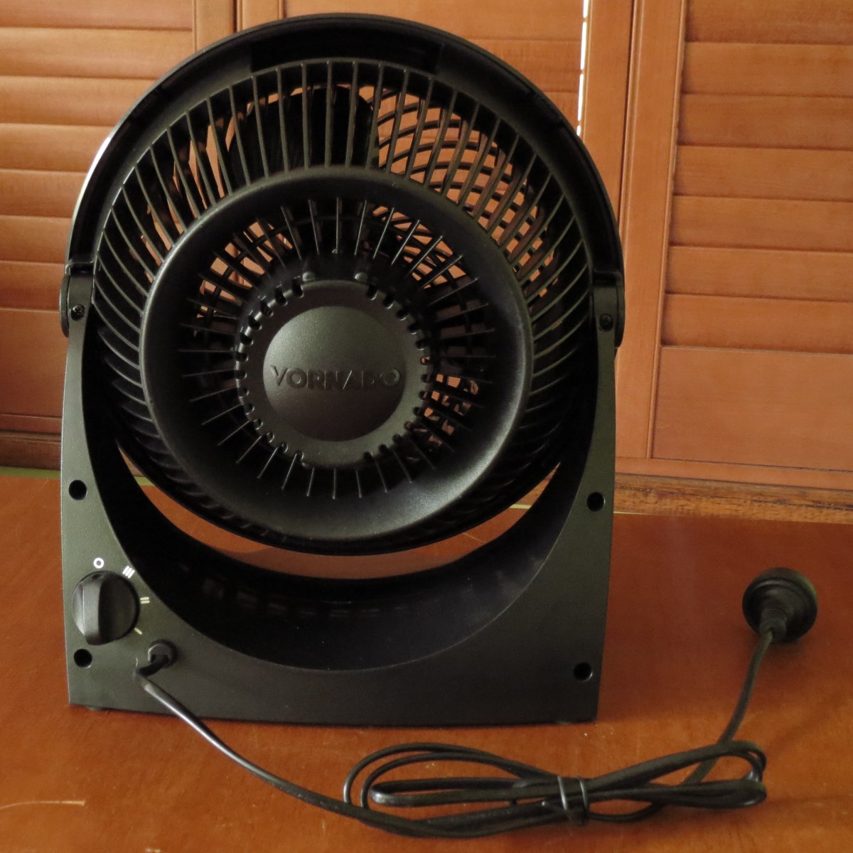

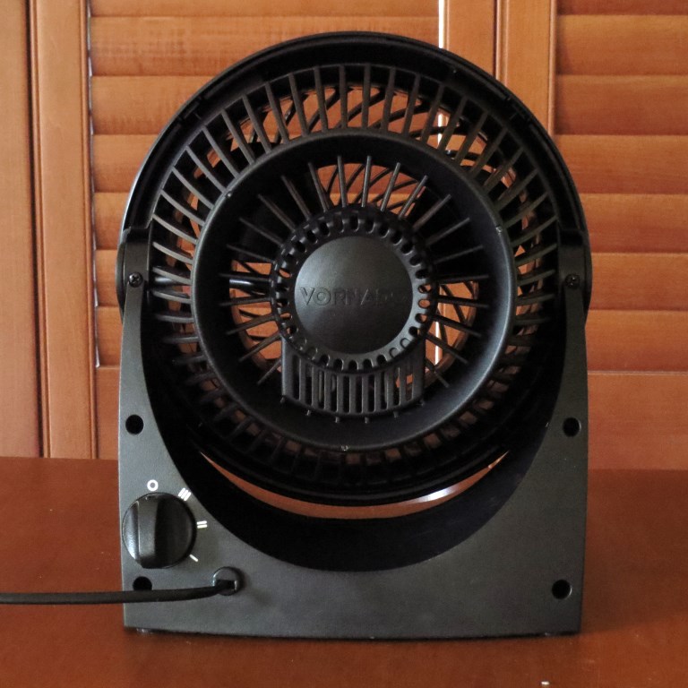

Rear view.jpg (230.94 KiB) Viewed 80484 times
Just as the front-of-box picture shows, it sure looks distinctive. (Note that the blue is more vivid in reality than it appears in these photos, partly because of the somewhat restrictive sRGB colour space and partly because of the unexciting camera I'm using.)
The label on the base mentions the power draw of 60W (on high, assumedly), a few patents and the serial number (starting with the manufacture year and month). And the speed settings are indeed in the counterintuitive reverse order; technical arguments aside, it's annoying to have to turn the switch all the way across when you only need low speed (and then turn it all the way back to the off position afterwards).

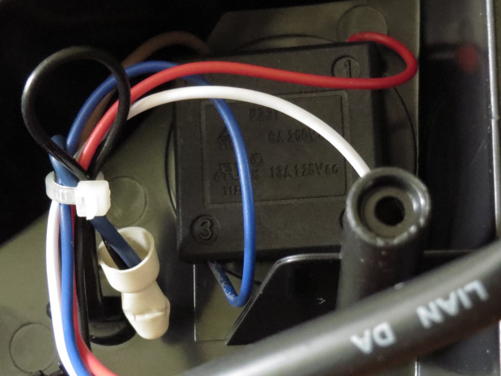

Release all six screws and the switch wiring is accessible:
Switch wiring.jpg (124.44 KiB) Viewed 80484 times
(The switch terminals you can't see labelled in the shot are marked L {active/line from the cord} and 2 {medium speed}.)
The wires to the motor are 22AWG (≈0.33mm²) and insulated for 300VAC (UL AWM 1007). The temperature rating of UL AWM 1007 is 80°C – more on the importance of the temperature ratings later. They are bundled in an outer black PVC tube (rated for 105°C, the highest thermal grade usually available for PVC – although there are conditions to running PVC that hot, notably precautions to be taken against plastic "flow") for supplementary insulation.
They are colour-coded as:
  • Black = common
  • Red = high speed
  • White = medium speed
  • Blue = low speed

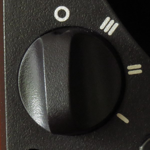

So if you want the speeds in the order 0-1-2-3 instead of the original, weird 0-3-2-1, swapping the red and blue wires from the motor will do it (I've done so in both of my units, and it does indeed work). (The manual, for the record, says about switching: To turn on unit - rotate knob one position clockwise. Turn the knob clockwise to decrease airflow. Turn counterclockwise to increase airflow. Well, whatever…)

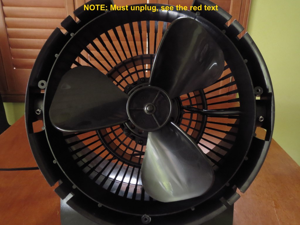

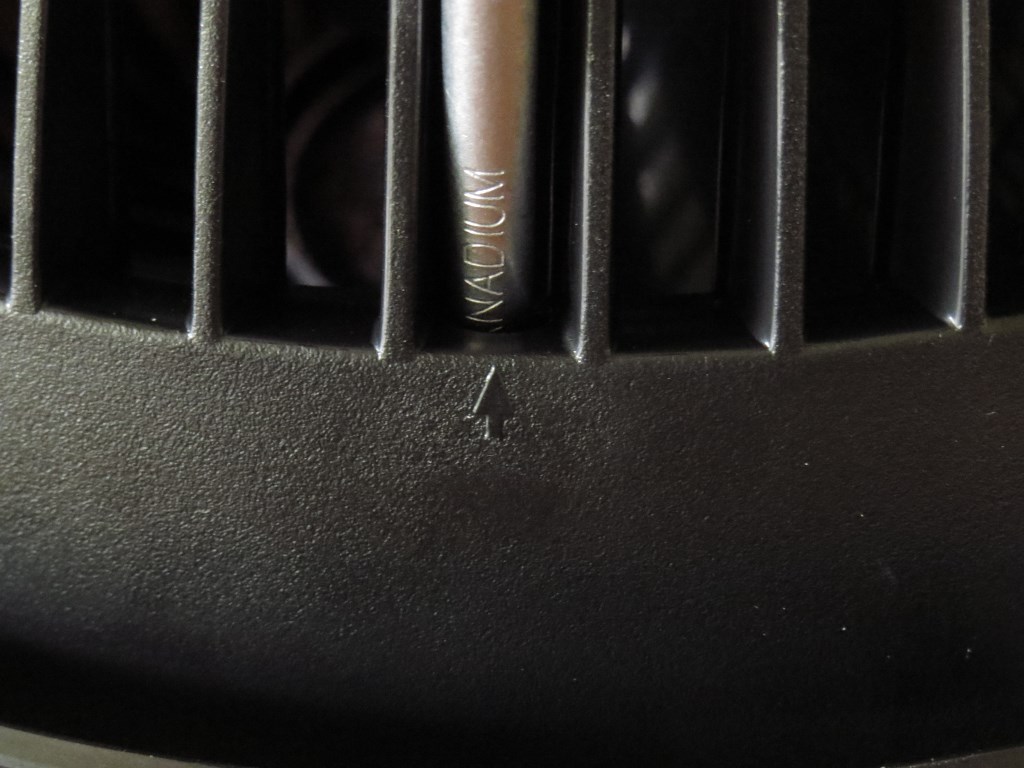

The fan head is held together by three more screws, which look similar to the four main base screws but are a little longer and with tighter threads. These are in deep recesses between the spokes of the intake grille, which are thankfully indicated with little arrows:
Screw position.jpg (129.75 KiB) Viewed 80484 times
This one is at the bottom, the other two are just above each of the joints (one per side). Then you just have to release four tabs around the perimeter, which thankfully aren't very tight so don't require precarious bladed screwdriver involvement.

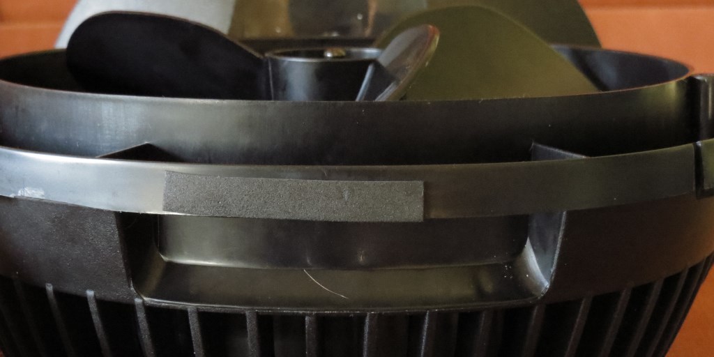

Foam strip.jpg (112.48 KiB) Viewed 80484 times

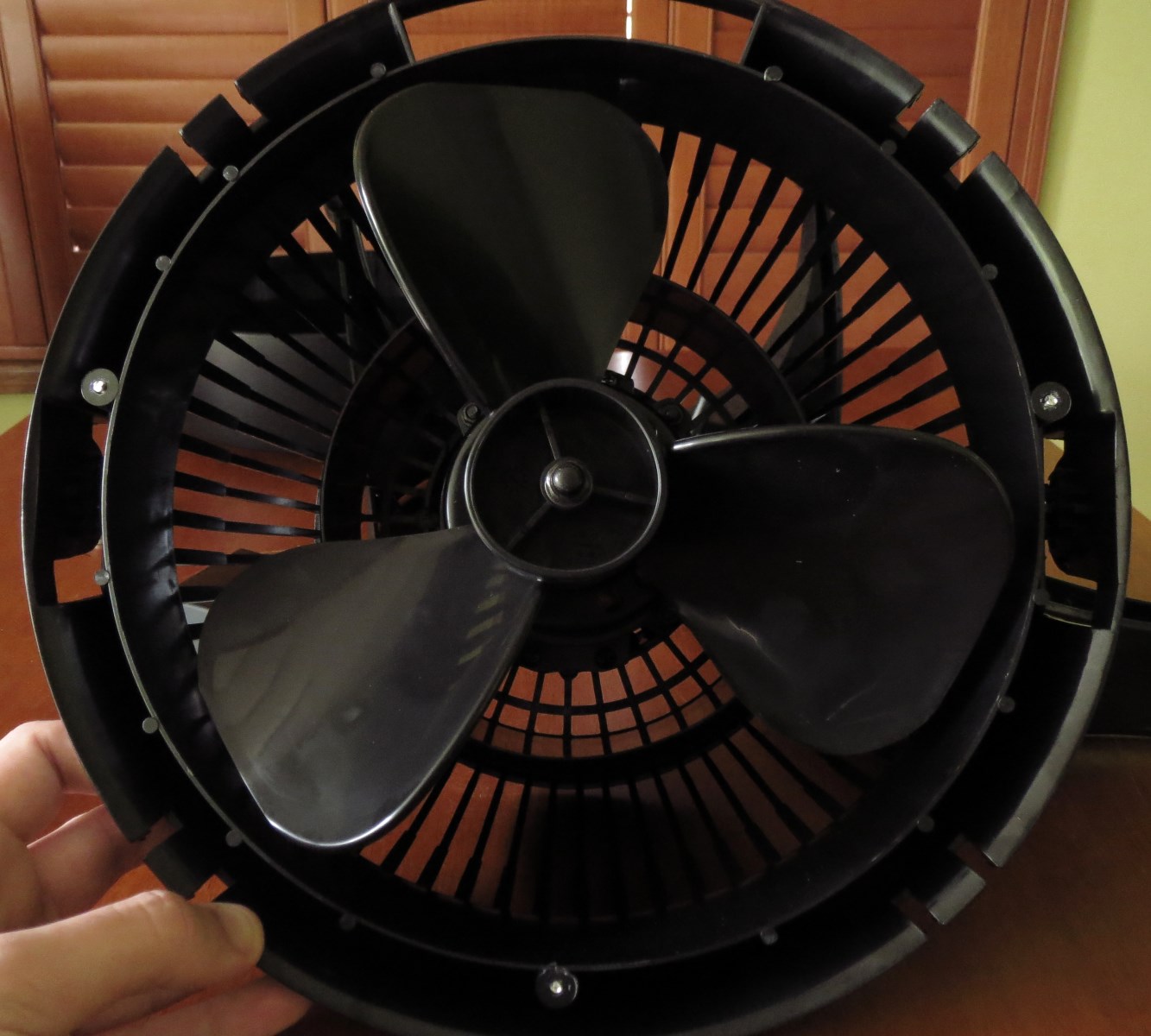

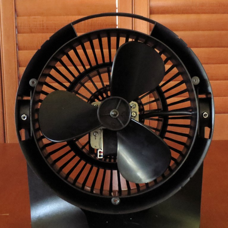

Opened look at impeller.jpg (197.27 KiB) Viewed 80484 times

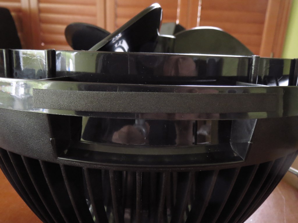

There is a thin foam strip at the top of the back part, most likely to prevent buzzing from vibration. (That photo should also give you an idea of the blade depth.) The impeller is held in place by one of those nuts that mate with a reverse-threaded shaft (common in these applications, to avoid unintentional loosening), which as usual is keyed with a flat section to prevent the impeller from ever spinning independently of the shaft.
The impeller is made quite thick and sturdy, although if you look very closely you may see that the central hub part isn't perfectly round. I also noticed that (at least in this sample) it presses onto the shaft tight enough to turn it from the friction alone, making it a bit tricky to line up the keying correctly to reinstall it.

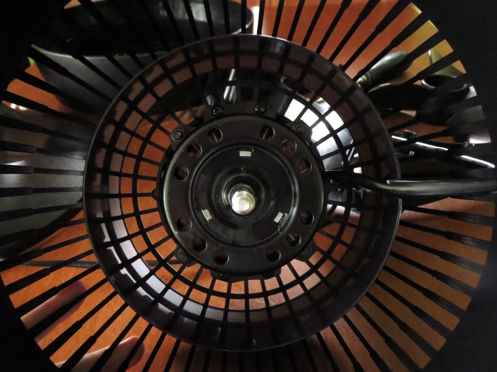

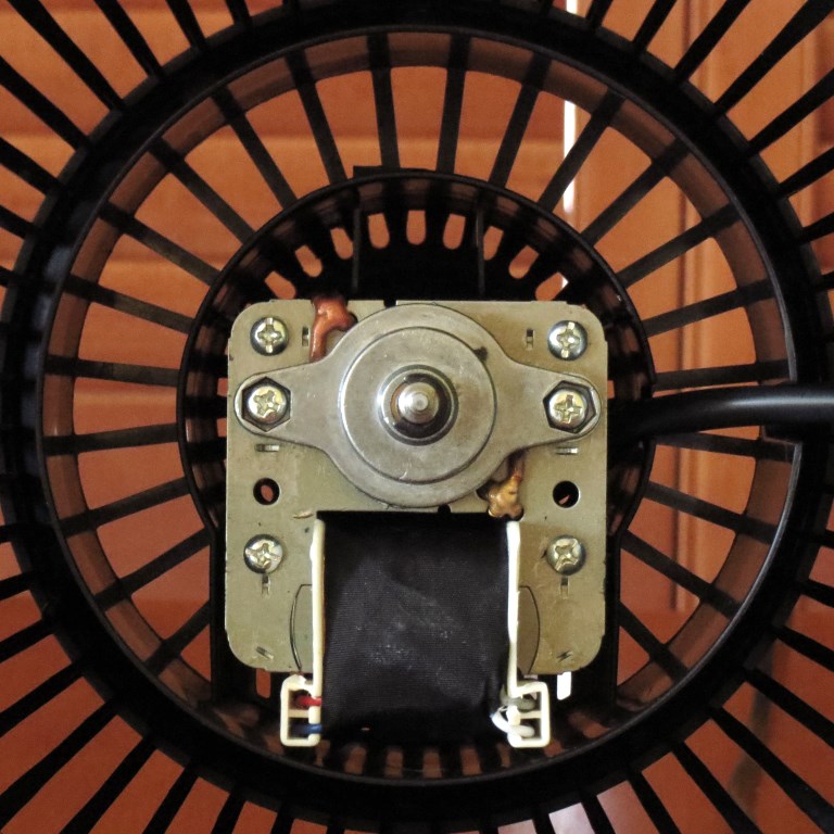

Motor view from front.jpg (163.89 KiB) Viewed 80484 times

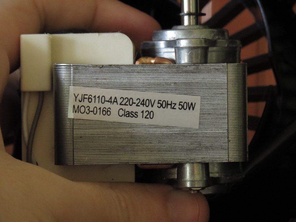

Motor
Motor label.jpg (60.77 KiB) Viewed 80484 times

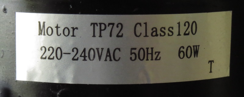

The motor is a capacitor-run type, and its label confirms the 60W rating indicated on the base of the fan. With a claimed working temperature of up to 120°C (Class E), the use of hook-up wires only good for 80°C seems a bit iffy; sure, it won't normally be at the maximum temperature constantly, but I don't think it would be prohibitively expensive to use leads insulated with silicone (150°C) or at least cross-linked polyethylene (up to 125°C for some grades). Not that this is unusual to find, but I could sure smell some of that characteristic "hot PVC" odor on initial operation. It subsides after a bit of use but still…

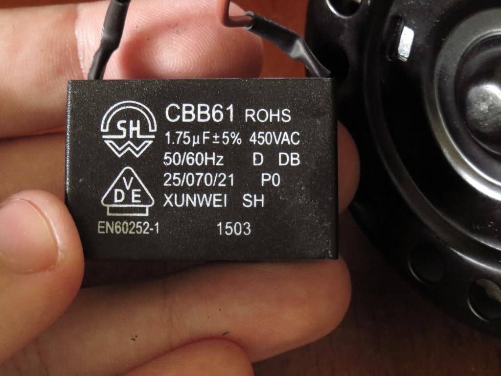

The capacitor used is a 1.75μF±5% 450VAC "CBB61" type made by Xunwei (whoever they are). A single screw mounts it to the motor casing.
I had previously examined inside the casing of the motor in my first-purchased unit and getting that back together was a bit hard, so I'd rather not be doing it again (at least, not for a while). The winding job wasn't totally beautiful either – not that I expected it to be (consider just how many turns of wire are required…).
The DC resistances across the input, incidentally, measured at 588Ω on low, 474Ω on medium, and 333Ω on high (approximate only, as I didn't control for temperature, which will increase the resistance as the windings get hotter).

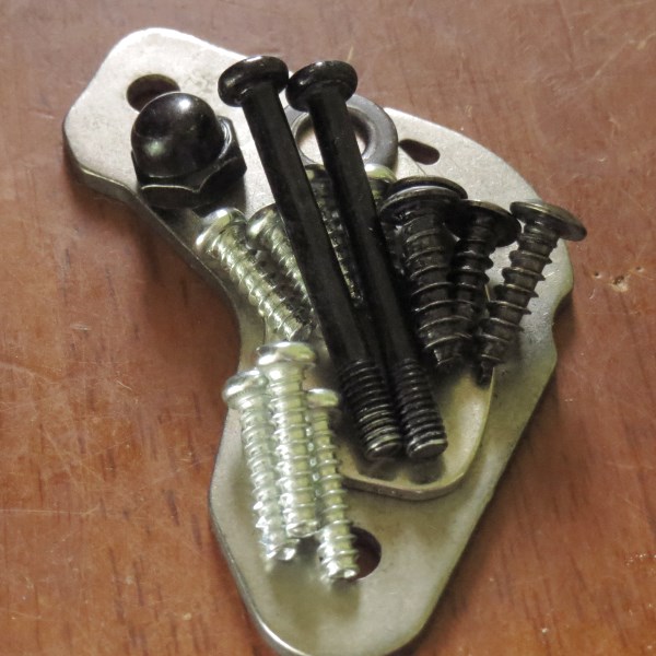

These are most of the screws used in the fan, along with the impeller mounting nut (and the flat washer used underneath it).
The front grille can be removed without having to take the base apart, as shown here:
Opened for cleaning.jpg (133.45 KiB) Viewed 80484 times
This will be enough for thoroughly cleaning the impeller, although you will still need to disassemble the base in order to be able to get enough slack in the motor wires for access to the back bearing (should you ever need to – hopefully not until over a decade of use).
Note that as the motor itself has only basic insulation between its windings and core, it is important to unplug before removing the front grille, even when leaving the base alone. (At least, according to European and Australian requirements – some other regions, including North America, are more lenient about it in small appliances.)

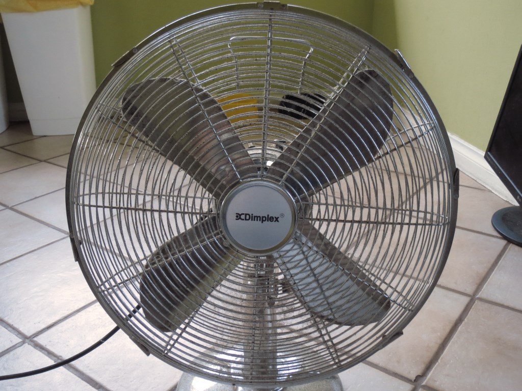

My point of comparison will be one of the pair of Dimplex fans that I mentioned in the intro. That Dimplex fan is much larger in diameter – at 40cm between blade edges, significantly bigger than even the "full-size" Vornados – but can the Vornado design make up the difference? Let's find out. Both of the compared fans have three speeds so…
  • Speed 1: The Vornado's noise output is subdued in overall level and has remarkably little tonality, although some low hum is audible under certain conditions (but nowhere near the drone of the Dimplex – although that sounds like more of a motor, instead of impeller, noise). The perceived cooling effect of the two both on this speed is similar at 20cm in front, the Vornado has a definite advantage at 50cm, and by 1.5m it's no contest. Double the distance again and the regular fan doesn't stand a chance.

Controls: C. I find the reverse order of the speed settings on the switch to be rather annoying, although I've lightened up a bit from the original score given the starting argument. Its placement at the back is also less than ideal, although I suppose they had little choice there with the basic rotary switch.
Dimplex GDC-DF40MC.jpg (222.86 KiB) Viewed 80484 times
See how crudely designed those blades are? It's like something from a full century (or even longer) ago.

Behemot wrote:That cap could be X rated I guess.
Motor run capacitors get their own classifications and certifications. (As do the capacitors used for power factor correction of old-style iron-cored ballasts for fluorescent lighting.) You can see that there's a VDE mark; is that good enough for you?
By the way, the reason for the 450VAC rating is because the phase shift (which is the reason why the capacitor is used the first place) can result in more than the supply voltage appearing across the capacitor itself. So an actual X cap (which are typically rated for 275VAC) may in fact be unsuitable there.

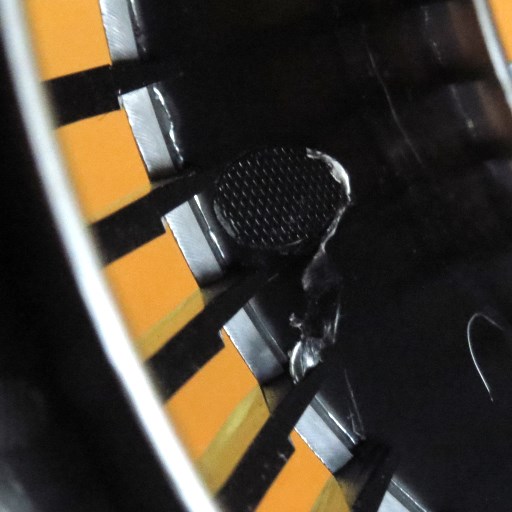

A little bit of a mess is present here (the lighting is horrendous, I know). While it doesn't really affect operation, it would be nice if they would remove it during QC inspection (or better yet, improve the moulding process so it doesn't happen in the first place).

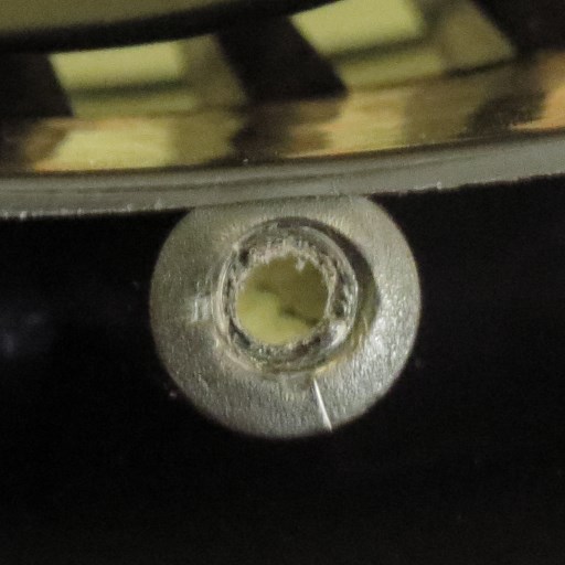

Another quality "glitch" I would prefer not to see, even if it doesn't deteriorate performance or reliability.
Stressed plastic at screw hole (A).jpg (45.48 KiB) Viewed 80393 times
Stressed plastic at screw hole (B).jpg (47.36 KiB) Viewed 80393 times
At least the mounting thread on the switch in this sample wasn't stripped (or not nearly as badly as in the initially-reviewed 633), although this was probably just down to luck. I haven't noticed the hot-PVC smell that was present during "break-in" of the 633, so it would seem that perhaps the wires don't cop as much of the motor heat here (plausible given the open design of this motor, compared to the more enclosed motor in the 633). Still, the cost increase to use better motor leads (e.g. UL AWM 3266, with XLPE insulation good for 125°C) shouldn't be more than a dollar, if that (remember, we're not talking about a discount-store PoS fan here).

As of today, the switch knob on my 533 broke. :( I'll be looking around for any replacements; the switch shaft appears to be a standard quarter-inch type, too bad it's oriented such that the indicators on commonly-available "stock" knobs would point in the wrong direction.
Of course, the arrangement of the speed settings from highest to lowest probably hasn't helped (I mostly use low speed and rarely high).

Postby LongRunner » December 1st, 2016, 3:48 am
Yes, but I'm not convinced that another original knob would fare better (I wouldn't expect many random failures of such a simple part, barring truly dreadful QC, so this is probably a design weakness).
Maybe if I source a knob that fits and then ask for a refund to cover the cost of it? (Retaining the broken original knob as evidence.)
Or better yet: Notice the subject of my latest mini-review? Maybe if I could step up and design a stronger replacement knob for the Vornado family, in much the same fashion as that example… I could use the (so far intact) knob from my 633 as a reference (it's the same knob on both of them, and presumably on various other Vornado models as well).

Postby LongRunner » December 5th, 2017, 2:23 am
Another year later, another knob has broken (on the first 633, still in use by my sibling); so I had to give another one (originally on the second 633, then moved to the 533) as a temporary replacement.
On the upside, I found a Shapeways offering for a replacement knob (albeit rather crude in design), so I've ordered 3 black + 1 white (for another 633 since purchased on clearance, which is currently my "main" unit) to try.
From further reading in the meantime, I've found that the "reverse" order of speed settings isn't a Vornado exclusive; at least in North America, it's standard practice, with the intent of ensuring more reliable starting. So I might lighten up on that part of the scores…

Postby LongRunner » December 21st, 2017, 8:54 pm
Well, they've arrived. As it turns out, they're not entirely compatible with Vornado x33 models; for a start, the switch shaft is differently dimensioned, so the knobs alone won't grip it at all. Fortunately, this can be cured by adding a shim of 1mm thick plastic to the flat side of the shaft.
The marker is also in a different position, so with these knobs on the x33 series the marker ends up 135° clockwise from where it should be (so when the switch is off, the marker points to the far-clockwise setting; and in any on position, the marker points to a blank area). My fix for this will be to make new marks with a drill, and fill in the original-designed marks with some epoxy resin or other.
Otherwise, they seem strong enough and look well-made (certainly for being 3D printed). So, I can't exactly complain, but I might add a comment there regarding use of the knob on the x33 (I'll tell you when/if I do).
