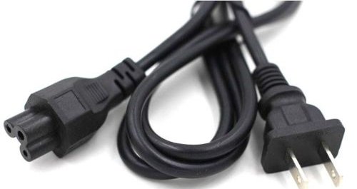

noob question here. is it safe for my CPU to use the power cord KKCK rated 10A -250V

If it's the same one I mentioned, using it is playing Russian roulette, so don't.
What does the resistance of each conductor measure?
