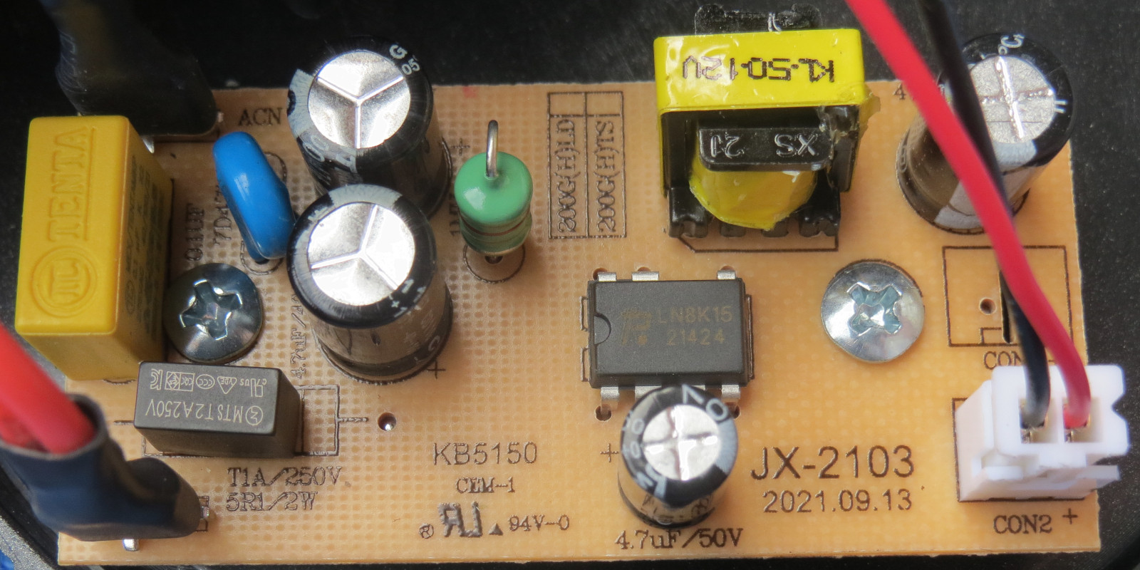

  • Onix ON-PDF15 USB-rechargeable desk fan: While I don't generally buy from this name, I was willing to make an exception this time since it was on clearance for about AU$15 while the original price looked sufficient (was it around AU$40?) to make a reasonable product; the motor is brushless (although the sleeve bearing could have been better-oiled, but problem solved with an application of my Zoom Spout oiler) and it moves air well enough for its size (vaguely Vornado-esque in design although it has 5 blades and the front grille slats aren't angled for optimal flow-focusing, but at least they swirl the right way and seem to work adequately). There's a questionable electrolytic capacitor inside, but then we never really expected the good stuff in much of any home appliances anyway. Charger is not included, so we don't have to worry if it's safe or not.

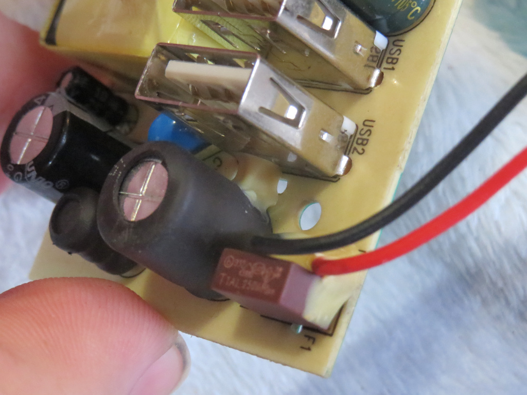

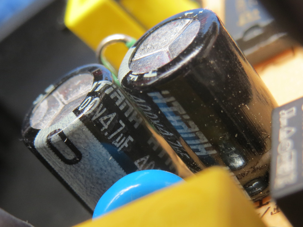

  • TaoTronics TT-DL22 LED desk lamp: The lamp itself (with 48 LEDs, 30 of 5000K and 18 of 3000K; can also combine both sets to approximate 4000K) is functional enough, but the USB charge output interferes with digital TV when loaded. :rapidfire: Not yet sure of the exact deficiency, but it would have been perfectly easy to ground the metal base for a bottom shield (and I can't imagine a suitable top shield adding much more cost either).
    The 3 electrolytic capacitors inside are again your usual mediocrity (Kehong brand, "LOWESR" but no actual series stated).

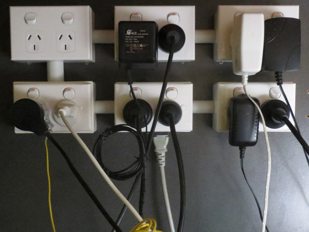

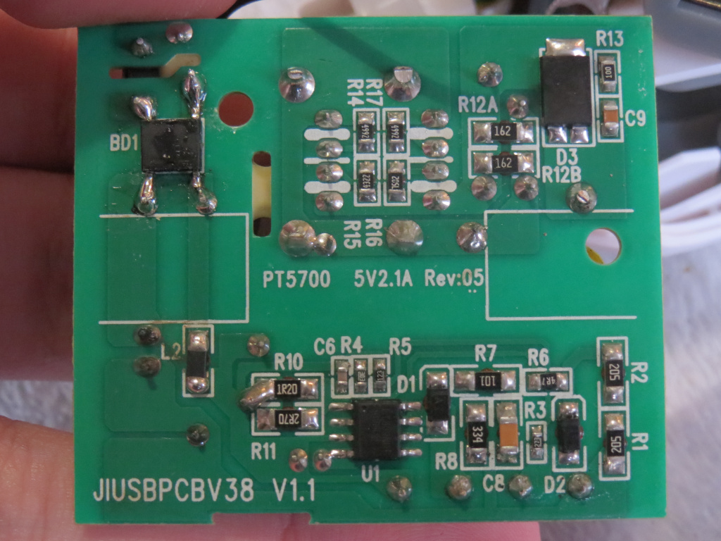

  • Crest PWA04984 and PWA04985: The most-decent (not that the bar's been set high :-/) modern power-boards I've seen so far (surprisingly available at Coles), with reasonably sturdy casings and socket contacts of ordinary design but clean brass; the PWA04984 has 4 sockets, while PWA04985 has 6 sockets and a master switch (which is actually double-pole although not stated as such); otherwise they're much the same, and on both models the left-most socket has a wider spacing (55mm) than the rest (45mm). Both contain a single 14mm MOV (claimed to absorb 175J suggesting a nominal 470V or thereabouts) from active to neutral, protected by an adjacent thermal fuse plus F3.15A HRC fuse (although with the usual arrangement where the load remains on); the indicators are green InGaN LEDs driven half-wave through 3MΩ resistors, so heating there is negligible (and they are in opposite polarities to cancel out the DC component, however small it is, for as long as the MOV remains enabled). The cord (standard H05VV-F3G1.0 with a side-entry plug, manufactured by Conghao) measures accurate to the stated 1.2m, and at 20A the circuit breaker trips in about 15 seconds.
    Viewing their (admittedly bloated) site, related models include the PWA04980 (4 individually-switched sockets) and PWA04986 (6 individually-switched sockets); and for those who fancy USB charging (up to 2.4A rated), PWA04982 (4 sockets + 2 USB ports), PWA04987 (6 individually-switched sockets + 2 USB ports) and PWA06021 (4 sockets + 4 USB) all with presumably the same MOV (though I can't guarantee without checking individually); there's also a slimmer 6 socket + 2 USB model (PWA06205) if you aren't bothered about surge suppression.
    Even more interesting is their "Connect" series which have an IEC C14 inlet instead of a wired-in cord (they also sell 1m, 3m and 5m C13 cordsets in case you don't already have 150 of them :mrgreen:); these include the PWC4100 (4-socket master switched), PWC4400 (4-socket individually switched), PWC4402 (the same + 2 USB) and PWC6100 (6-socket master switched), none of which claim any surge suppression (although all have the same wide-spaced socket on the left). Will add those to this thread if I get one (or more)…
    The two "plain" power-boards they sell (CCPB4 and CCPB6) aren't so interesting (looking like an ordinary rebranded Chinese design), but at least they're priced accordingly and hopefully-compliant (the only recall under the brand was back in 2002).
So, it looks like non-electricians aren't out of options there.

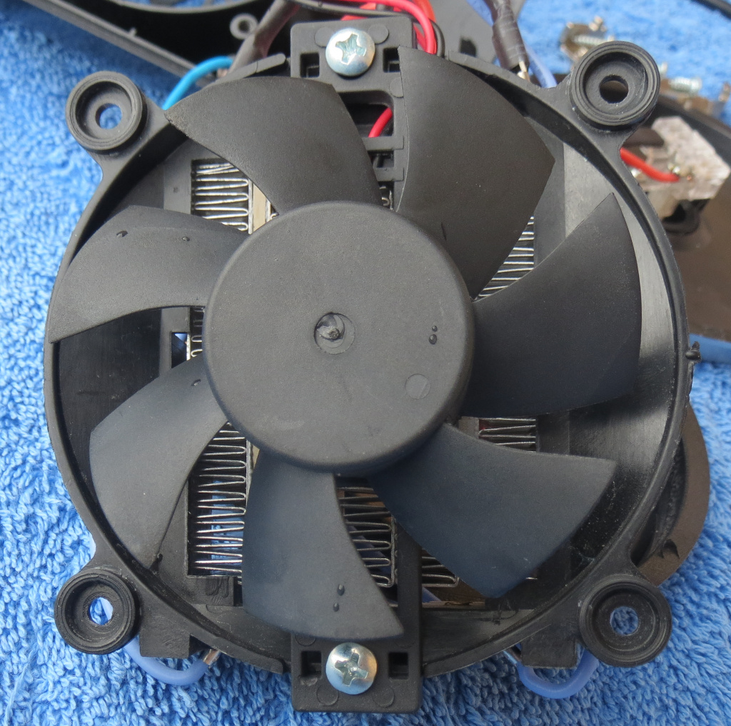

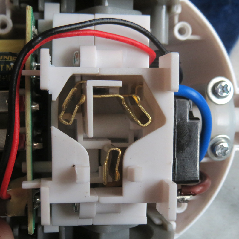

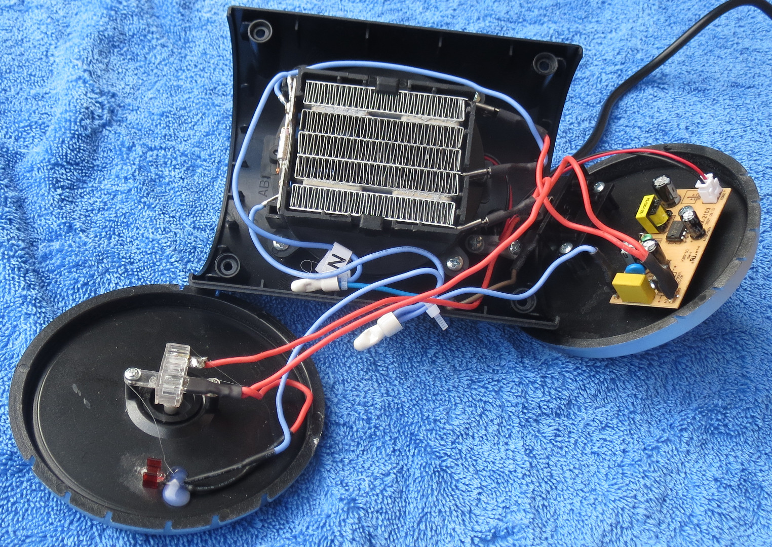

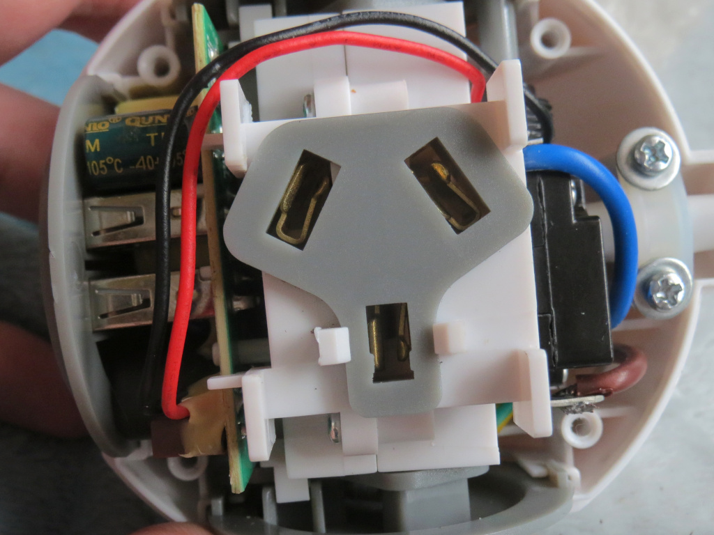

  • DēLonghi HSX3324FTS: A solid convector/fan heater like I've been quietly desiring for some years (my Mum used to have a Goldair Turbo-Convector model 8050 in her office, from ≈1997 to about the mid-2000s; while those had the fatal flaw of plastic top grilles, I did like their neat layout and thicker steel front and back panels compared to the modern norm). Even the thermal cut-out (Klixon TH11CA181) is exactly the same as in the old Goldairs, although without the warning buzzer (advertised as "Sensortronic" back then). It also has a (proper) tip-over switch (unlike the cheaper models) and timer, and mica sheets (for enhanced electrical insulation?) inside the casing besides the heating elements. The PBT (+ 30% glass fiber) blower housing is shielded from direct heat exposure by the metal plate mounted to its front (I can actually keep my hand on the case area directly behind the blower), and the heating elements themselves are in very good form (and hardly buzz at all when on).

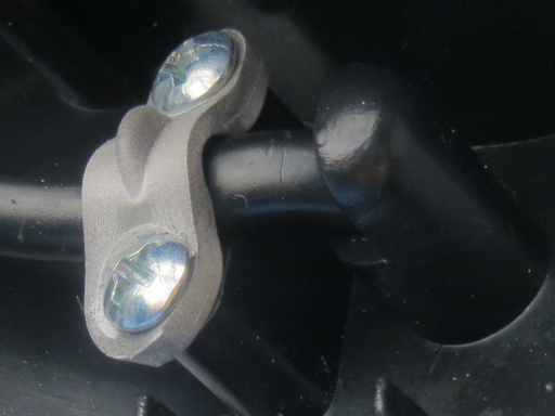

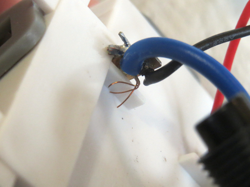

    One small design niggle is that one of the motor wires (which connect through a pair of bus-bars along the element assembly, being on the opposite end from the controls) is a bit short and therefore taut; still, I'll give it this:
    It's relatively expensive at AU$169 RRP, but I think the build quality is worth it (anyhow, in its lifetime it'll use way more in electricity). Power is 1000W low + 1400W medium (2400W on high), though blower operation is restricted to 2400W mode by the shared rotary switch.

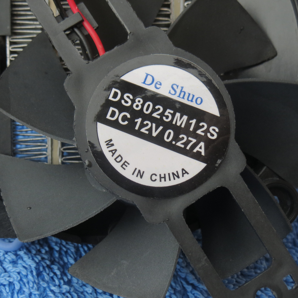

  • Technics SU-Z780: Found it among some "rubbish" while on a walk late in May, once home it was clear someone already "had at" it in more than one place: The original custom fan (using a DC brush motor, as this was around 1989 so brushless fans were presumably relatively expensive), with its motor knackered, had its wires cut out and controlling transistors removed from the main PCB. The output relay had its contacts bridged by solder blobs (not because the relay was bad, but because the power module had been replaced with one lacking the control pins for the relay); I salvaged it for future use and jumpered it out more-tidily with copper wire (pairs of 0.5mm strands from a piece of 1.5mm² TPS cable as used on Australian lighting circuits; would have gone with tinned if I had a suitable spool). The other needed repair was to resolder the speaker terminals; and the potentiometers will need contact-cleaning before I'm done with it, but apart from that it seems to work fine (testing into load resistors home-made from sections of a salvaged fan-heater element, with another fan temporarily bodged-on).
    The replacement fan will be a Nidec D08K-24PH (I have several) salvaged from a Kyocera laser printer; the next step is to make the voltage regulator (from the internal unregulated +42V or thereabouts, a bit more than the 7824 is good for but an 8.2V 1W or 5W Zener diode should drop the input enough for it) and perhaps a new control circuit. I'm also cutting a larger hole for the 80mm fan, but this is hard (and noisy) work so I probably won't do it again if I ever repair another of these…

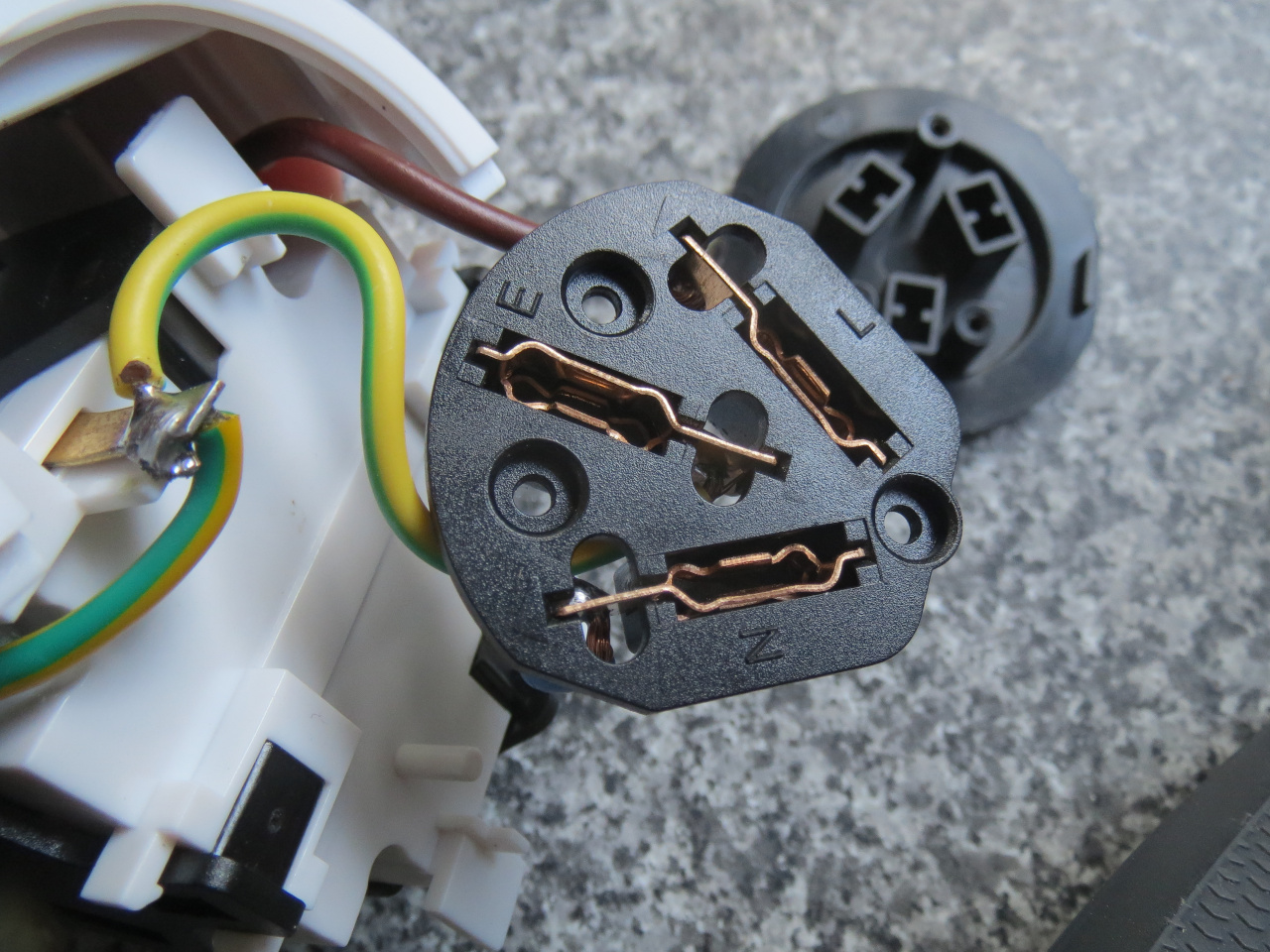

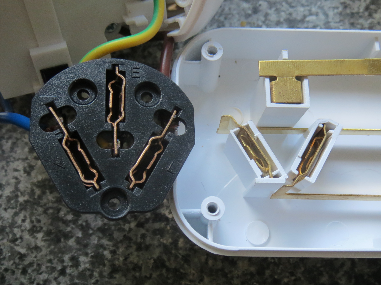

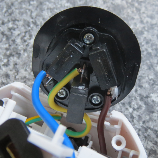

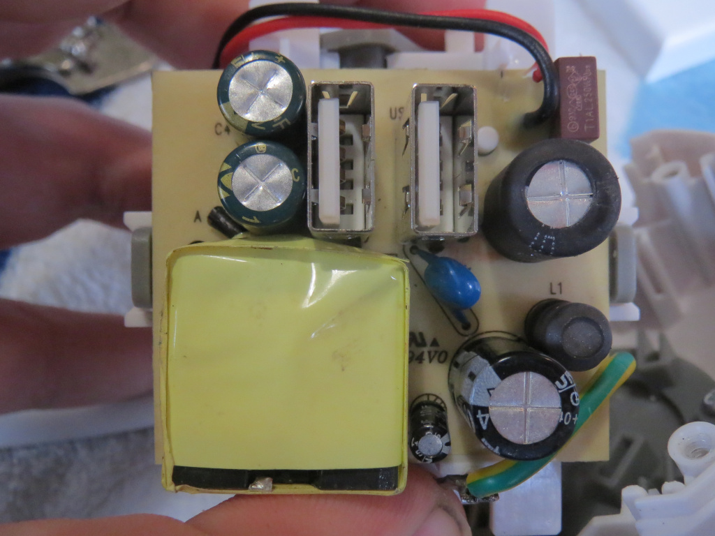

  • Go Travel 095 (Schuko to AS/NZS 3112): So close to decent… :-/ This one is discontinued with its replacement being model 544, anyway I found it in another op-shop also for AU$3. The casing is PA66 according to the card and contacts are quite sturdy brass (0.6mm on power contacts, 0.8mm on earth clips; it indeed passes the rated 10A fine) albeit with aluminium (?) rivets, but the Schuko earth clips are a bit short and only make contact at about the same time the power pins do (and were overall quite loose as originally formed). :silly: It seems that the Australian standard for these includes no requirement for the foreign sides to comply with their respective standards. Original price was indicated as AU$12 (about fair for the materials used).
    Also, the company is a bit weird in selling both half-decent designs and death-dapters. :lol2:
    UPDATE 2022-08-20: Now that I have a better model, I've decided to recycle the brass contacts and fire-test the casing. It did take some perseverance with the glow-wire (which probably also gets hotter than officially required) but I managed to ignite it, and it continued burning for over 11 minutes!

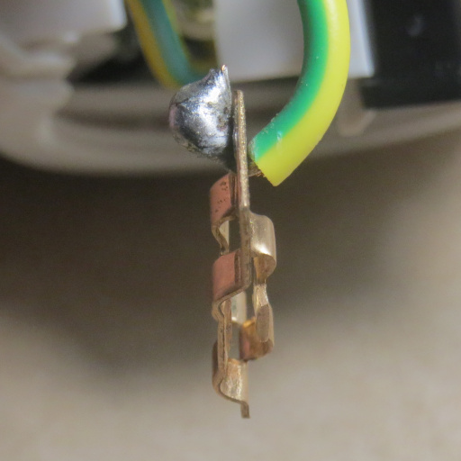

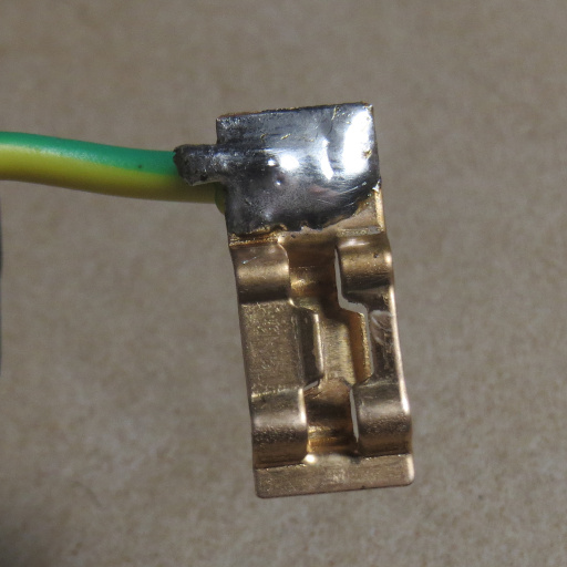

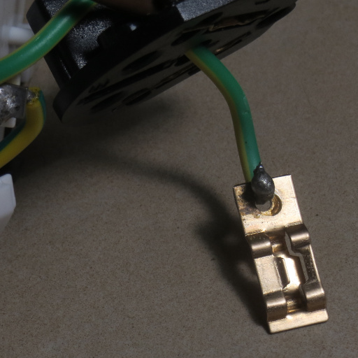

    Curiously, inside the unit each hot-plate casing is actually earthed twice: One earth wire goes from the input to their rear mounting brackets, the other goes from input to the left-side bracket on the right-hand plate and right-side bracket of the left-hand plate. I'm not sure what this achieves when the cord has only one earth wire (which is much more likely to get broken) anyway, and the other metalwork is only indirectly earthed; but maybe there's some obscure requirement in the standards somewhere…

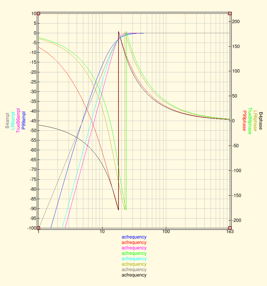

  • Elliott Sound Products Project 99: Rod Elliott typically knows what he's doing, but this seems to be a bit of an exception; it's a high-pass filter (tuned to 18Hz as designed) to suppress infrasonic noise (from vinyl records etc.), nothing wrong with the basic idea. Despite what the project page claims, however, the implementation is quite far from a true Butterworth filter; here's its frequency response simulated against some other filters:
    Infrasound filter simulation.png (65.59 KiB) Viewed 217126 times
    P99 is shown on the blue (amplitude in dB) and red (phase) traces; a true 6th-order Butterworth filter is shown on the magenta and green traces. The cyan and olive traces represent a 6th-order Linkwitz–Riley filter (equivalent to a cascaded pair of 3rd-order Butterworths, but only really meant for loudspeaker crossovers), which still performs considerably better than P99. Finally, the grey and black traces show a 4th-order Butterworth filter (suggested on the page to be “marginal”), which still manages a sharper initial roll-off than P99 (only losing ground below 5Hz, by which point it's already 46dB down…)
    Now, the true 6th-order Butterworth filter I simulated has three Sallen–Key stages, so can't actually be built on the P99 PCB. But the 4th-order Butterworth sure can (by jumpering out C1 and C4, and omitting R1 and R4), and works pretty much as well as P99 (or arguably better); while I used E96 resistances for the other filters as simulated, you can use E24 values alright (with the given 150nF capacitors, R2 = 56kΩ, R3 = 62kΩ, R5 = 22kΩ and R6 = 150kΩ).
The simulator, incidentally, is Qucs 0.0.20; not flawless, but so far seems workable enough for me. Users of recent Linux versions (Ubuntu 20.04 and similar) will need to get a compatible version of Qt4 here.

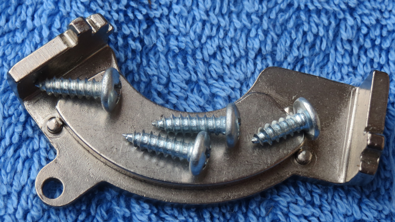

The PTC heating elements are actually in two columns (separately connectable if desired), and even at this power level, it's a pity that the opportunity was forfeited (given the small rooms it would suit, although the box sells it as a "Personal" heater as seems to be the convention for such models :silly:).
One of the assembly's 4 mounting screws is shorter than the rest (about 9.5mm vs. 12mm), with no visible justification in the casing design.
The heater frame is marked as PA66, which is not so good for the working temperatures of these unless specially stabilized (I've already seen the fate of such plastic as the top grilles on a Goldair 8050 Turbo-Convector and this operates in the same temperature realm, although may be somewhat mitigated by the limited life of the fan anyway). It is GF-reinforced going by a slice test, but IIRC so was the plastic on the Turbo-Convector.
Both the front and back housing are ABS, although at least with a steel front mesh (as on the other PTC heaters I've seen); still, I've seen in an Everdure HCC1800TB that the front shroud melted slightly as a result, and the same will in all likelihood happen here.
Both the bimetal cut-out and thermal fuse are mounted on a mica piece at the top of the heater frame. The bimetal is set at 80°C and the thermal fuse at just 98°C; this is because it's arranged such that the fan airflow keeps it cool in normal operation, while if the fan fails, the heat will rise up from the heat exchanger.
Fan from behind.JPG (443.03 KiB) Viewed 216370 times
Fan label.jpg (327.95 KiB) Viewed 216370 times
The fan has a custom frame, but is otherwise just a standard 80mm 12VDC sleeve bearing type. Ironically, the frames of these are usually GF-reinforced PBT, which (as briefly noted regarding the DēLonghi HSX3324FTS) at least according to figures I could find, is significantly more heat-resistant (up to 200°C for PBT+GF and 150°C for PBT alone, vs. maybe 140°C for typical PA66; but for long-term use, the temperature has to be lowered) :D.
Primary caps.JPG (182.42 KiB) Viewed 216370 times
The buck converter powering the fan uses "HTIANH" (?) input and Jwco output caps, and is driven by an LN8K15.
Its input is only half-wave rectified, although at least with two diodes in series (type M7) for redundancy.
At least it has a fuse, which is more than I can say for the Dyson AM05's control board :group: (no wonder Dyson had to recall it)

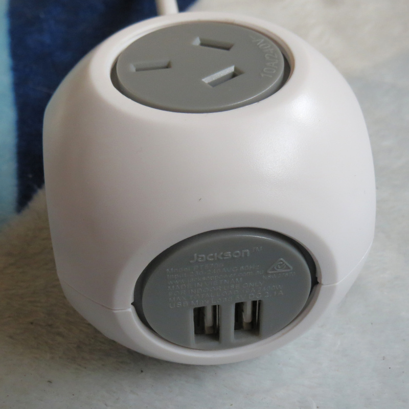

I was at Bunnings for some unrelated (and mostly non-electrical) items, when I came across this:
If you remember the original Allocacoc PowerCubes, I didn't have the best outcome with their build quality. Could this actually be better-made?
This version (also available with red or blue socket faces) provides 2.1A USB charging and 4 mains sockets (3 usable when mounted), but as is the case with the PowerCube, you can also get a non-USB version with another mains socket (and black socket faces) for AU$10 less.
They're listed at AU$32 (USB)/AU$22 (non-USB), which is similar to (or even a bit cheaper than) the Allocacoc versions.
Jackson Industries are one of the prominent name-brands for power-related end-user products in Australia (and NZ), competing with Crest (which I mentioned before as providing the lesser-evil among conventional power-boards). My prior impression of this company was so-so, but perhaps this will improve on that…
It's a sphere truncated to flat faces at the sockets, rather than a cube proper; it's also a bit bigger than PowerCubes, at 71mm flat-to-flat (85mm spherical diameter).

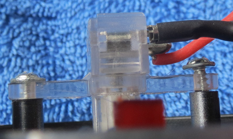

Here, the circuit breaker reset button is accessed via a hole at the top of one socket; the mounting base is screw-on instead of twist-lock. This base supports adhesive (though not as easily removable) or screw mounting, but unlike the PowerCubes, the screws are actually included. The hole pitch here is 26mm.
The finish is a more-pleasant matte texture (versus the gloss on the Cubes), but whether the plastic will last as well before yellowing is another matter (it doesn't say what type, and feels most like ordinary ABS to me). The cord is shorter at 0.9m, but at least that's stated accurately (within 2cm); it feels flexible enough.
The casing screws here, while not hidden behind a nameplate, require a notched-blade screwdriver to engage; in my case I took an old cheap screwdriver and cut the notch myself. Depending on the width of the screwdriver, you might also need to grind its sides down to fit. The two above the socket (as referred to their normal orientation at wall outlets) are slightly longer (12mm) than the two below it (10mm), although any justification for this isn't apparent in the casing design.

A few of the wire strands were pushed aside where inserted through the neutral and earth tags, although the connections remain good enough to survive 15A without scorching heat (see below).
One of the cord clamp's screws has pressed into the clamp, although it still holds onto the cord; at least nothing's outright broken here.
I added washers under the screw heads (as you can see in the above pictures) to salvage it.

USB supply
Unsurprisingly, this is the weakest part; on top of questionable capacitors, this one also has the bad glue (the PowerCube used silicone here). (Neither piece I see is on or next to a major heat source, but still.) The single-insulated mains wires (UL AWM 1007, 24AWG) are also run somewhat close to the secondary components; some heatshrink there would have been appropriate. It does have a proper fuse (T1A 250V) rather than a fusible resistor, though.
The output capacitors are 2×1000μF 10V 8mm Qunio TM series, rated for 576mA ripple each (although these are slightly shorter than specified); this isn't entirely adequate for a 2.1A flyback converter, especially with the hot rectifier diode (SVM1045V) right on the back of the PCB.
The primary capacitors are 2×10μF 400V 10mm Qunio GR and a 10μF 25V 4mm one is on Vcc for the FT839ND1.
The cramped design provides no room for these to vent, so who knows what can happen then…
There is also some flux residue around BD1 (ABS10), and a solder chunk stuck to the transformer tape.

As for the USB supply, I have five 5.1Ω 5W resistors to hand, so have paralleled two of them with three 100Ω. Measured voltage at the end of the USB cable I used falls to about +4.7V (so about 2A actual), and the nameplate gets quite warm. It seems to work, but as made, I don't trust it long-term. The ripple is pretty bad too, over 150mV at room temperature (slightly lower once warmed up); a poly-mod gets it barely within the equivalent of ATX specification.

The end socket, unlike in Allocacoc PowerCubes, is its own unit connected to the main block by wires:
End socket rear.JPG (162.52 KiB) Viewed 214475 times
End socket open.JPG (452.23 KiB) Viewed 214475 times
Versus Crest PWA04984
Contact comparison.JPG (411.52 KiB) Viewed 214475 times
The contacts here are somewhat similar to the conventional type, although made of phosphor-bronze and with curved sections for a bit more spring.
Many (though by no means all) of Jackson's regular power-boards have the same arrangement of curved sections in their active and neutral contacts, although in brass (you may be able to see it through the packaging if held up to light at the right angle).

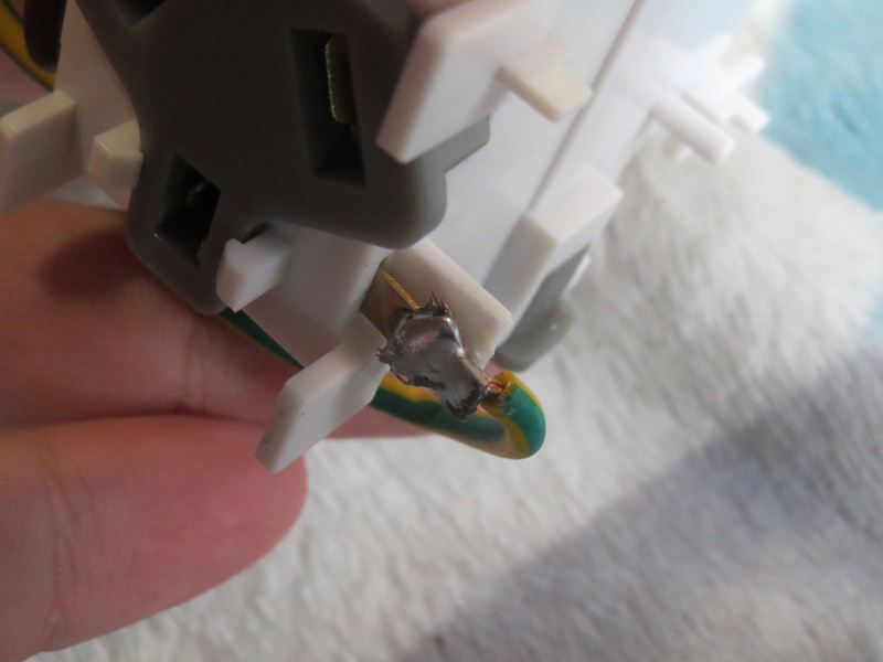

Bad joint.JPG (96.55 KiB) Viewed 214475 times
Unfortunately, one unit had a failed solder joint on the earth connection (which is a bit cramped to reach in-situ) so I had to resolder it.
Circuit breakers tripped in 28, 32 and 40 seconds with a precise 20A. The cord clamps appear to be a slightly-whiter plastic and no screws have pressed into the hole. All casing screws are 10mm long, and the provided base mounting screws are also a bit different (with some added texture on the head).
Top: (2 empty), headphone amplifier, camera battery charger, external HDD, internet gateway. Bottom: Anti‑static point (via Clipsal 463SAS) + Stylux T‑869 (with 4W 4000K LED), heating pad (Sunbeam EP5000), monitor (Dell U2713HM), PC, desk lamp (TaoTronics TT‑DL22), printer (Kyocera P2040dn)
Desk-back power outlets.JPG (411.58 KiB) Viewed 214475 times
…you can follow the lead of 1970s Kambrook: Buy enough twin outlets for the purpose, along with the same number of back boxes (with conduit ports where needed), some conduit for wire protection between the boxes, at least 3m of cable (I used 1.5mm² 7-strand TPS, but probably flexible with ferrules for any future rewiring), a 10A thermal circuit breaker (which I salvaged from a cheap UPS) and C14 inlet. If I had a 3D printer I'd design a frame enclosing the mounting nuts for the IEC inlet, but I don't so I've instead formed plastic sheets (salvaged from PSUs) to provide barriers between the wiring and screws/nuts; otherwise you could use nylon screws (which I did in an earlier iteration), or possibly make an earthed metal plate to put under the nuts (with star washers in-between).
If not mounting it to an existing structure, you'll also have to fashion your own baseboard.
