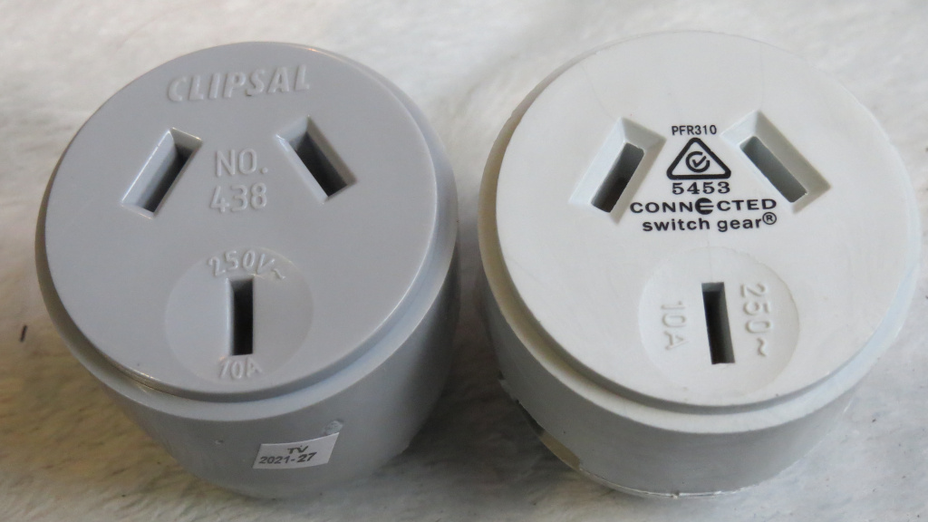

  • PR310 and PFR310: While no claim is explicitly made regarding these, they actually have more steel than their Clipsal counterparts: Both the screws and clamping plates in the plug are plated steel, and the socket has steel screws (which don't have great-looking heads either) in tunnel terminals.
  • BCA: As above, using clamp terminals with both the screws and plates being steel.

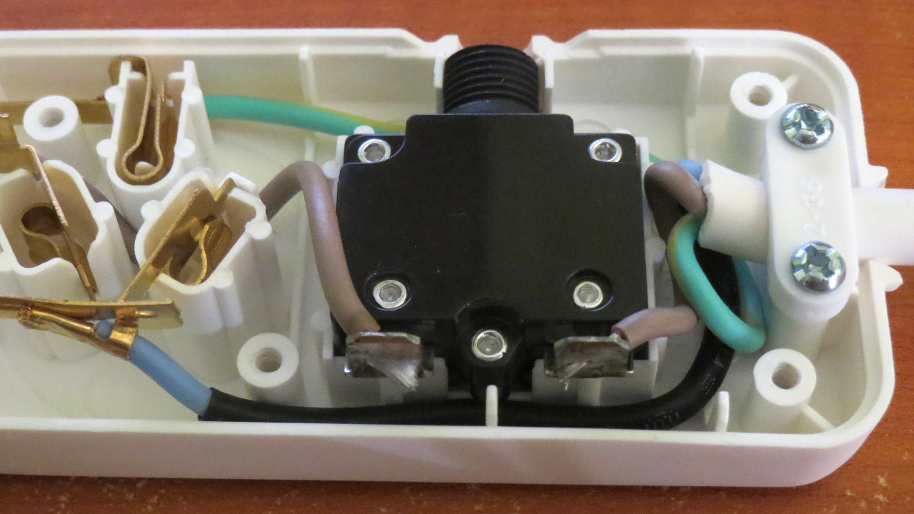

BS-POD10 inside.JPG (246.5 KiB) Viewed 175007 times
The BS‑POD10 looks fair enough, with wiper contacts formed of 0.7mm phosphor‑bronze. (Although since the incoming common active busbar doesn't need to be springy, they could have made it from brass like the terminals – just as Clipsal did in the older 25 outlet I've shown below – for higher conductivity and hence less cross-section necessary for the rating.) Switch mechanisms are little-changed from Clipsal's (the main difference being a concave curve in the rockers, making them somewhat more ergonomic), although the rockers are marked for 16A even with the 10A sockets. The barriers between busbars look satisfactory to me (when the front plate is holding them in flat). It can be easily seen that the basic structure is the same with or without the extra switch option (BS‑POD10X), only part of the plastic molds being swapped out. (Although the back of the extra switch mechanism would appear to obstruct access to the earth terminal screw :huh:)
Three screws hold the unit together at the center and bottom corners, with the top edge hooked into place.

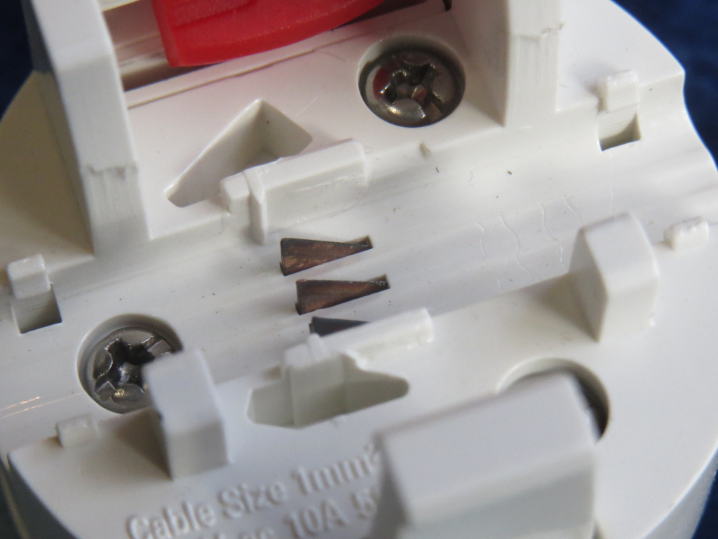

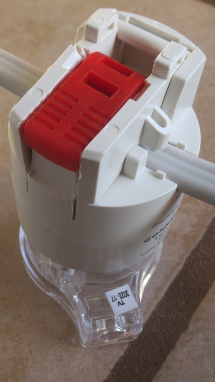

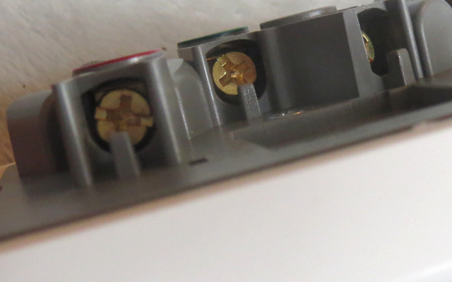

Pegs at terminals.JPG (79.13 KiB) Viewed 175007 times
Without an extra switch, the only nuisance (apart from the lack of a stripping length guide on the back) is those pegs in front of the terminal screws – I suppose the idea is to stop the screws from falling out in transit, but it obstructs screwdriver access; feel free to cut the pegs down at installation.

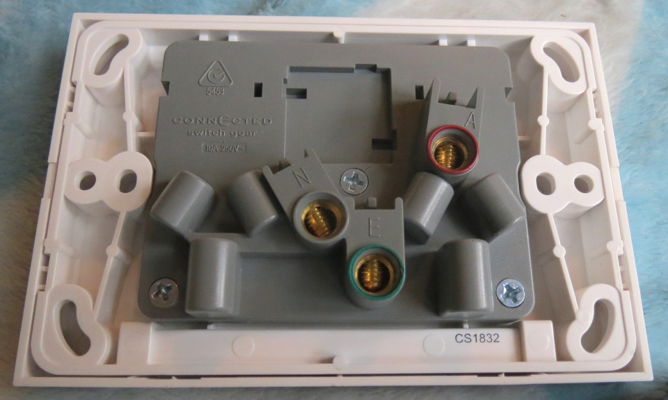

BS-POD10 (older) back.JPG (190.55 KiB) Viewed 175007 times
The active and earth terminals have about 5.8mm bores (on par with Clipsal's), neutral is a bit smaller at 5.4mm; screws with M5 thread. One of my samples is even missing the chamfered edge on the neutral bore, and another sample has a small crack near the center screw (although such cracks are not uncommon on Clipsal items either). (I swapped the neutral contacts afterwards to make one good unit.) Some factory fingerprints can be seen on the phosphor-bronze parts.
The assembly screws are obviously better-made on the newer sample, while the terminal screws look better (clearer head shape) on the older unit.

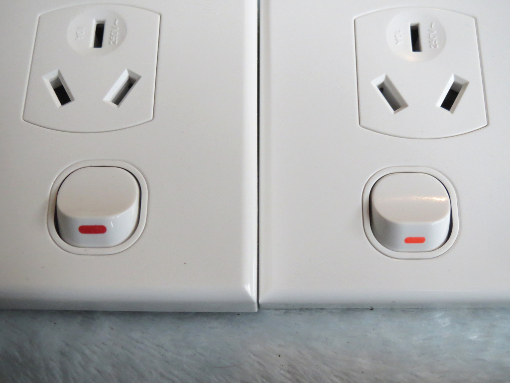

Switch marking difference.JPG (183.07 KiB) Viewed 175007 times
My newer units have deep red on marks, older units smaller marks in a lighter orange-red like on Clipsal (the deep red marks also go with stronger springs, at least among these; while those with orangey marks also have noticeable mold machining marks on the rockers).

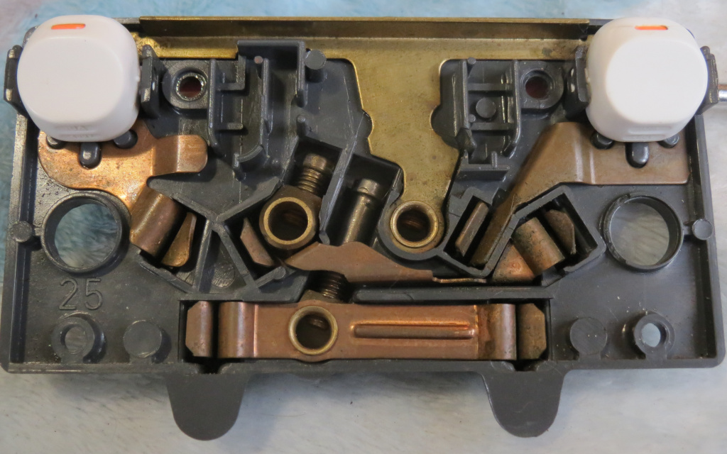

Clipsal 25 inside.JPG (246.55 KiB) Viewed 175007 times
Surround dated August 2013
Clipsal 2025S inside.JPG (278.05 KiB) Viewed 175007 times

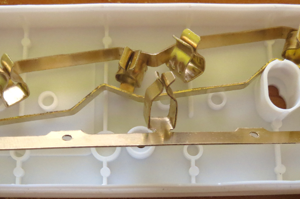

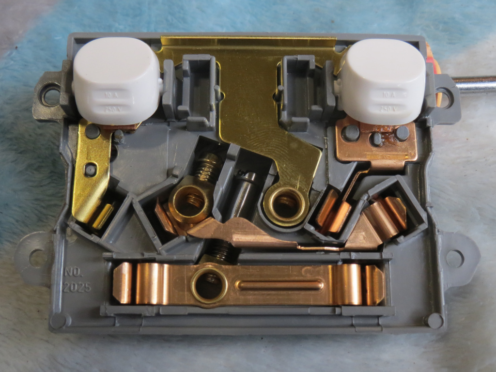

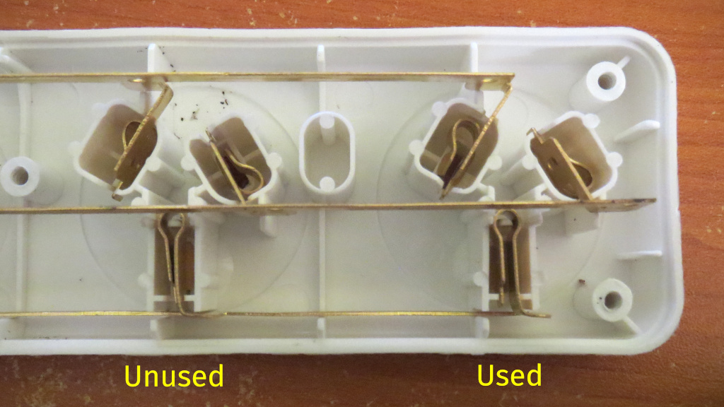

For what it's worth, the Clipsal outlets have been swapping phosphor‑bronze contacts out for brass in the meantime; while my older 25 outlet has all phosphor‑bronze socket contacts, the latest production have swapped mostly to brass and only the earth contact remains phosphor‑bronze.
(The newer Clipsal/PDL Iconic series outlets have all brass socket contacts, by the way; along with a less durable plastic-flex arrangement closing the shutters.)
As an intermediate example I have a 2025S (shuttered version), where the left active contact is brass but the others were still phosphor‑bronze.

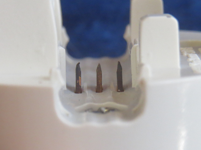

Clearance/creepage between the termination blades of the SMS1QF measures at 2.08mm when set for 1.5mm² cable, and 2.65mm when set for 2.5mm²; this calculates about right given the specified cable dimensions and 0.7mm blade thickness (being part of the same phosphor-bronze piece as the socket contact).
I couldn't get my calipers at the SMS1_1QF, but I calculate 1.665mm given the 1.13mm diameter solid A+N cores and a 7/0.4 earth; if the earth is 1.5mm² (7/0.5) this would increase slightly to 1.815mm, but of course only one can have been designed for (or maybe a compromise between the two, which would make 1.74mm).

In my SMS1_1QF the blades are heavily tarnished, not sure if this will still make a good connection.

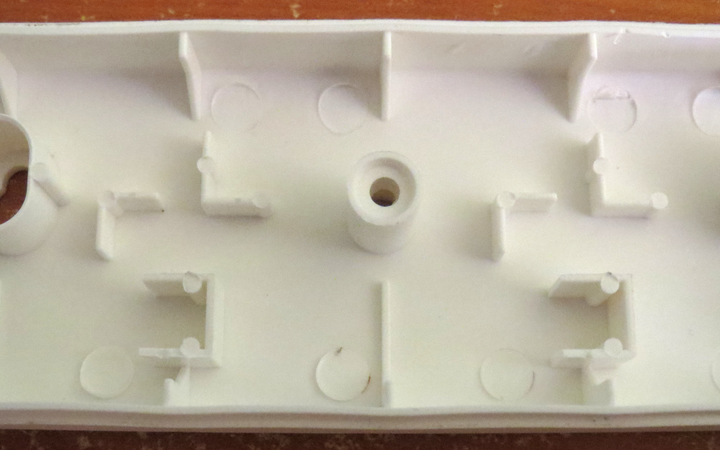

The faceplate also has a sizeable molding void; although to be fair, voids (although usually smaller) can often be seen in transparent Clipsal 418S plugs.

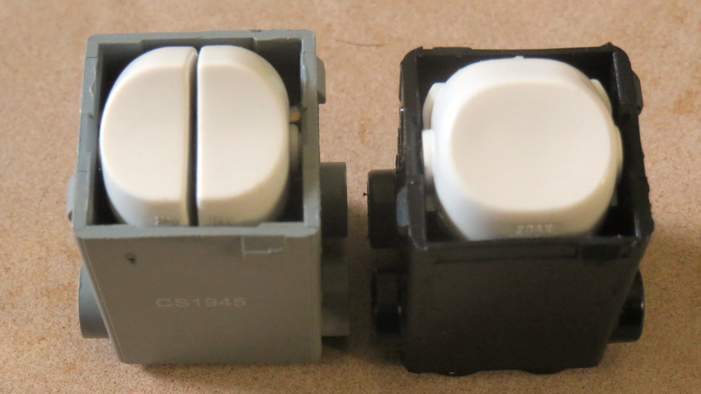

Didn't end up taking as many pictures as ideal, but they comprise most of the effort so without being paid, you can only expect as much as I feel up to :shy:

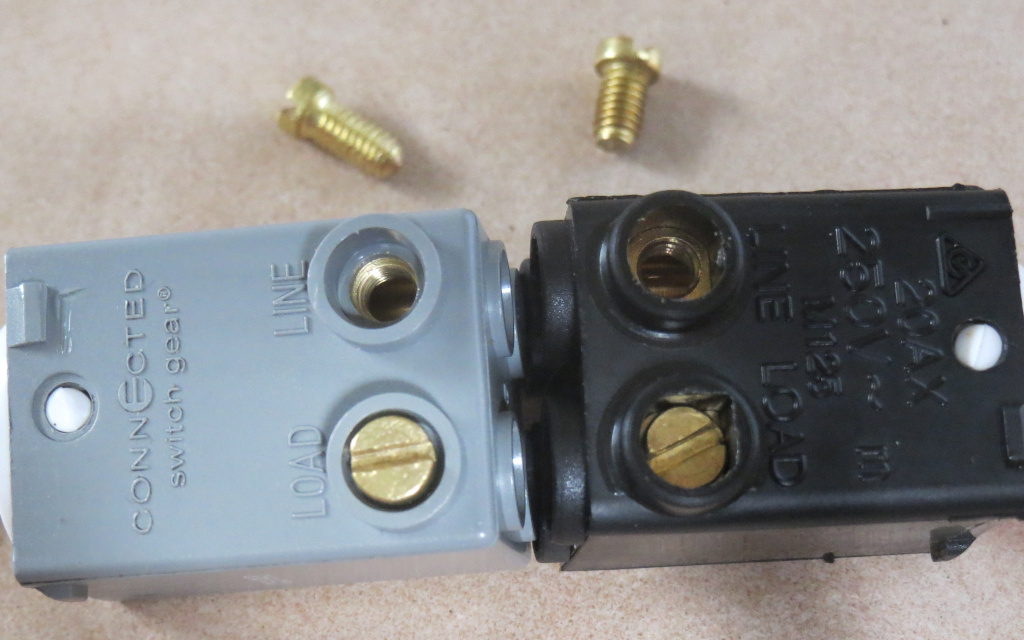

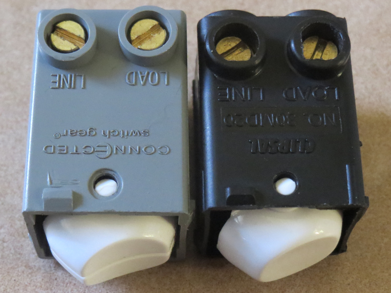

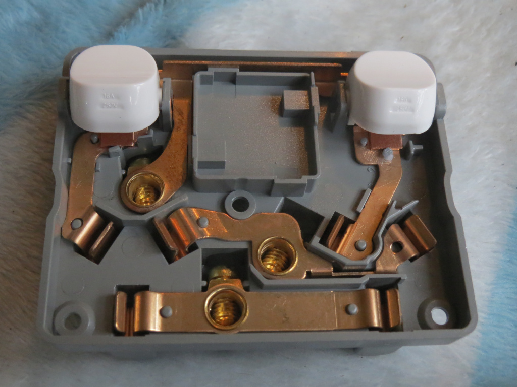

CSG M25S vs Clipsal 30MD20.JPG (184.2 KiB) Viewed 174936 times
Mechs side.JPG (170.64 KiB) Viewed 174936 times
Mechs rear.JPG (166.53 KiB) Viewed 174936 times
You can see here the under-screw flanges (which I ultimately drilled out).
Mechs unscrewed.JPG (212.95 KiB) Viewed 174936 times
The M25S has heavy enough contacts (about 4.2mm diameter or 14mm²) that I suppose it could manage the 25A rating (CSG also make a 32A DPST mechanism, M32DP); it can be seen to resemble the Clipsal 30MD20 (20A DPST) and two single‑pole switches can generally be made into the same‑size housing as a double‑pole switch of the same rating (this is standard practice in many appliance switches). However, when it's not mounted into a switch plate, the rockers seem to fan‑out and might come unclipped; when mounted into a (Clipsal) plate it seems under control though. I originally included it in the hopes of using it in an architrave plate, but in reality that won't happen as the terminal screw collars make it as wide as an architrave plate itself; Australian wall‑size plates can accommodate up to 6 mechanisms, so a split mechanism is rarely necessary there. As a result, it's more a curiosity than a genuinely useful item.
Both mechanisms have M4 terminal screws, the M25S with 5.0mm bores (versus 4.5mm on the 30MD20); either would fit up to a 10mm² core in theory (or 2×4mm², or 3×2.5mm² as Clipsal more-conservatively suggest).

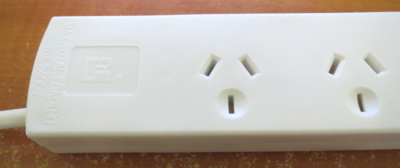

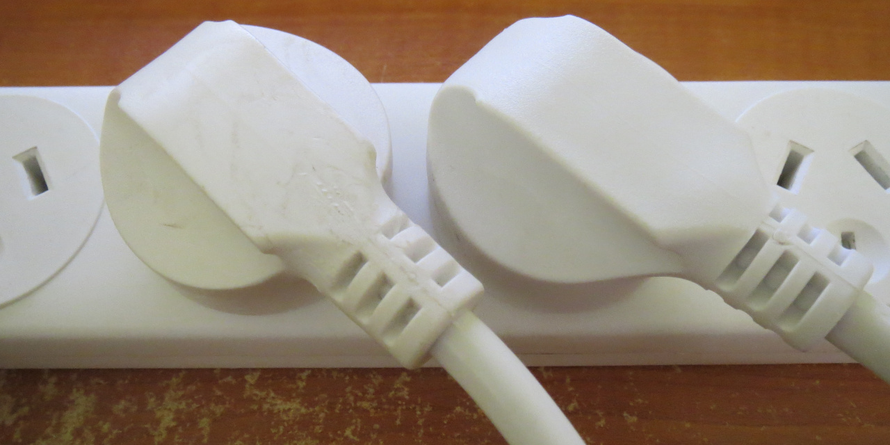

Socket covers.JPG (206.87 KiB) Viewed 174936 times

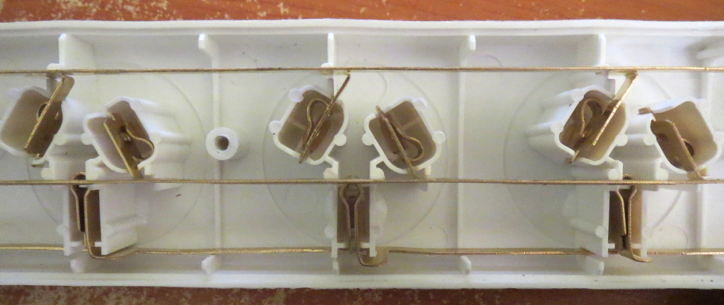

Sockets front.JPG (149.55 KiB) Viewed 174936 times

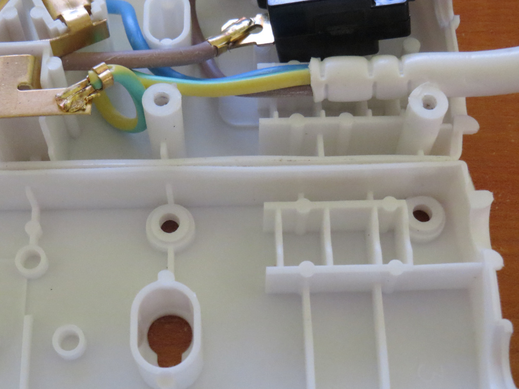

The wire channels are also a bit narrower on the CSG, so H05VV-F3G2.5 (which can fit into Clipsal 438XHD, 438/15HD or 438S15HD) would be a squeeze.
Sockets rear.JPG (177.41 KiB) Viewed 174936 times

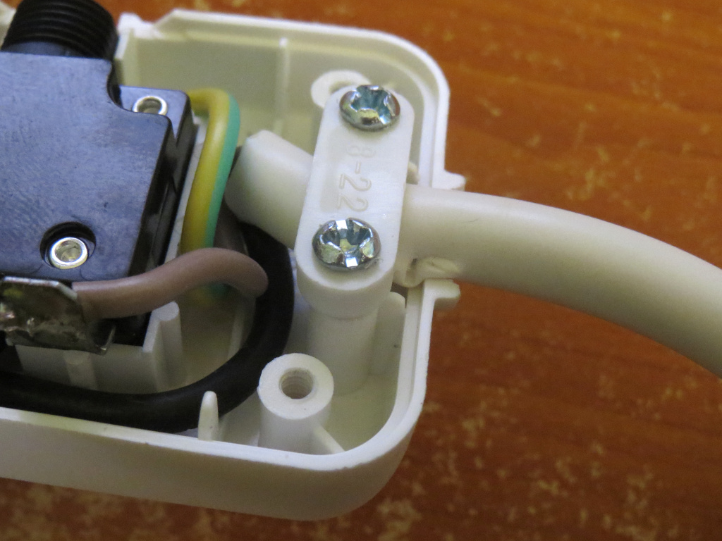

The stated minimum cable diameter is 8.0mm, which would rule out pretty much everything below H05VV‑F3G1.5 :silly:.
The PR310's cord entrance measures 9mm (not too far off from Clipsal's stated 8.7mm) and the PFR310's measures 10.1mm (same as for Clipsal 438HD); maybe this was revised at some time observing that my PR310's cover isn't noticeably aged (so presumably newer).

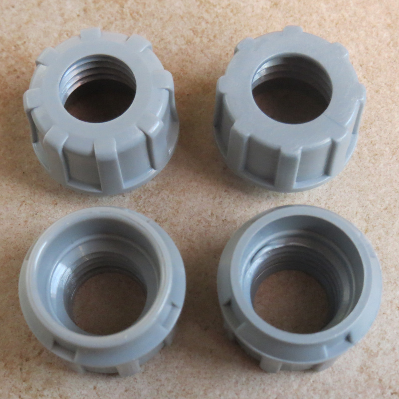

Cord grip nuts.JPG (222.14 KiB) Viewed 174936 times
On top of that, the nut's thread has a larger diameter (despite appearing as the same external size).
Test-fitting suggests that the PR310 really is designed for cable 8.0mm and larger diameter (so H05VV‑F3G1.5 is OK and maybe H05VV‑F2X1.5, not H05VV‑F3G1.0 and smaller); and the PFR310 fares even worse, only gripping heavy-duty flexes (and H05VV‑F3G2.5 if you could squeeze the cores into their channels). Borrowing a Clipsal nut improves both results somewhat, enabling the PR310 to grip H05VV‑F3G1.0 and PFR310 to grip H05VV‑F3G1.5.

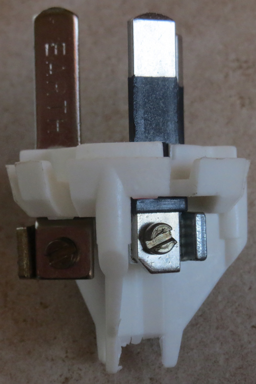

The plug does have nickel-plated pins, although the screw heads are smaller in diameter (4.1mm) than Clipsal's (4.8mm).
Also, the earth clamp's thread is on a bit of an angle (though probably not cripplingly badly), and the active and neutral pins seem angled a few more degrees (from vertical) than they should be (making it hard to insert into Clipsal 463SAS, for example). That said, the plug frame may be of a better (glass-fiber reinforced?) plastic than Clipsal's, so since my remaining Clipsal 439S has a partly-melted frame and loose earth pin (albeit probably from an overload test), I may actually swap the Clipsal cover and nut onto the CSG base. Observing the (lack of) sheath grip, though, I won't bother with either of these again (you could get away with fitting them on heavy-duty cord, or maybe if you have a few leftover Clipsal nuts to use; but the covers don't seem stable enough for my liking anyway). If I do end up using the PR310, I think I'll also replace the terminal screws with some wider-headed types (they're M3 so easy enough to substitute, indeed what I have to hand should work fine). Observing that no wiring instructions are even provided, these items seem to be an afterthought. Even the Deta counterparts (while of worse general quality) often grip the cord better than this (and are available with opaque covers to avoid yellowing/clouding).

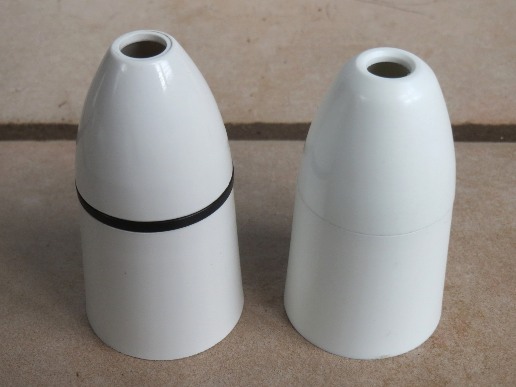

Clipsal 501 vs CSG LH01.JPG (207.51 KiB) Viewed 174936 times

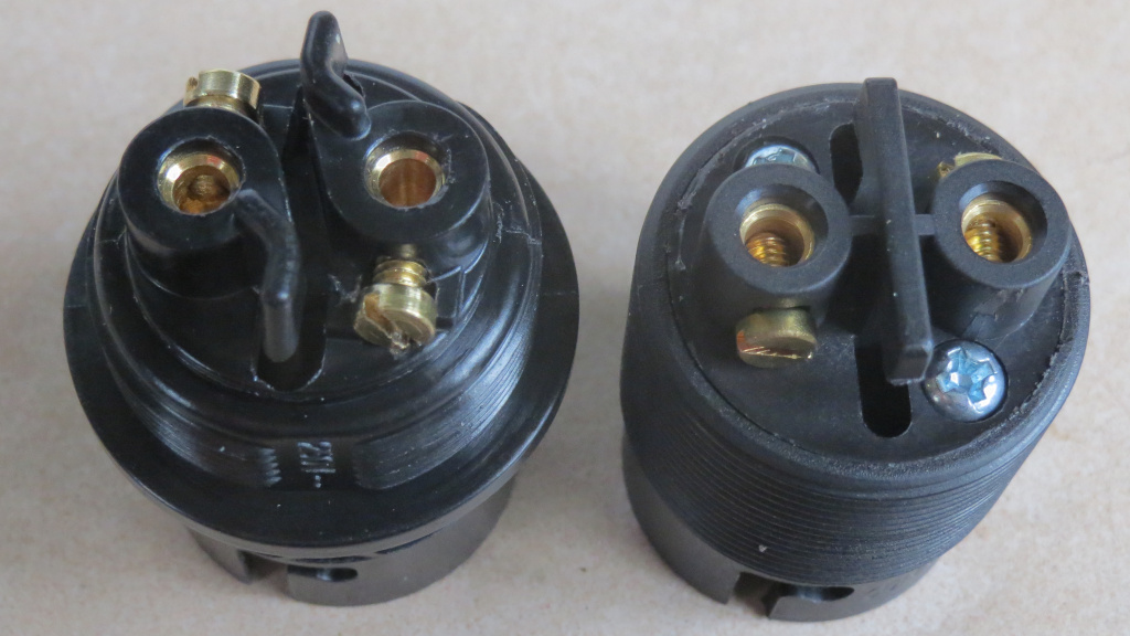

Lampholders inside.JPG (193.52 KiB) Viewed 174936 times
Lampholders back.JPG (193.19 KiB) Viewed 174936 times

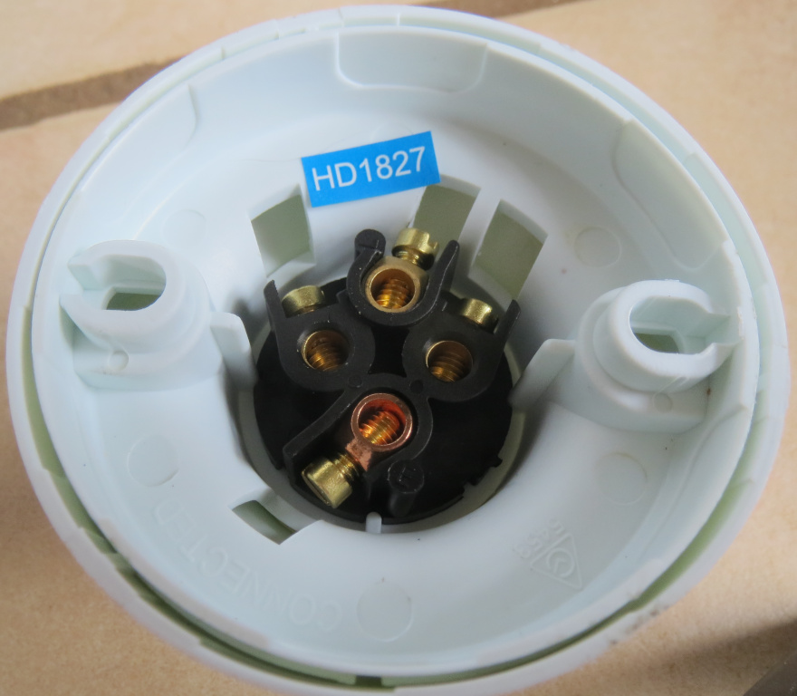

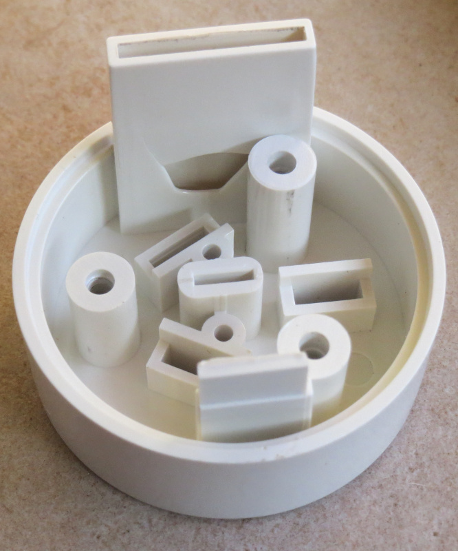

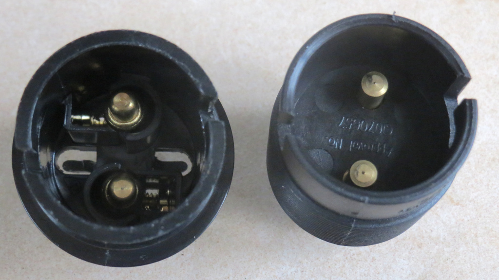

Compared to the Clipsal 501, the CSG LH01 lacks the flange in the middle of the body (to stop the skirt from being screwed on too far and stopping the terminal cover from screwing on fully); the body itself is 2-piece (held together with 2 screws) instead of 1-piece like Clipsal's, which has an advantage in holding the spring pins straighter. Clipsal's is marked T180, CSG's doesn't state the temperature rating.
The cord entrance is slightly smaller (8.4mm vs. 8.9mm) but still enough to accept H05VV‑F2X0.75 or H05VV‑F2X1.0 (even H05VV‑F2X1.5 if you have it for some reason). Both have hooks for inner core support, but no outer sheath grip; the same goes for the CR01.
Even with doubled-back ends I don't really trust the CR01 on 1.5mm² (the screw barely makes a dent), let alone the earth core of 1mm².
The flex side has M3 screws in 3.4mm bores, the fixed-wiring side has M4 screws in 4.8mm bores; both screw sizes about 6mm long.

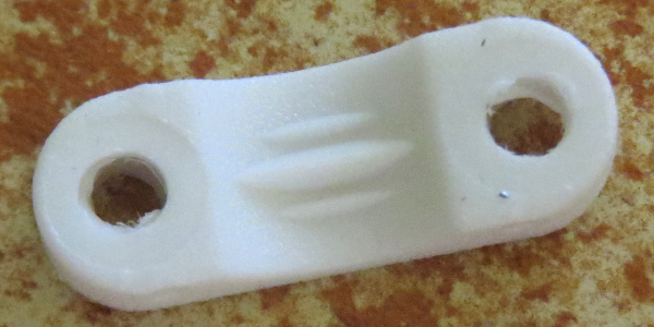

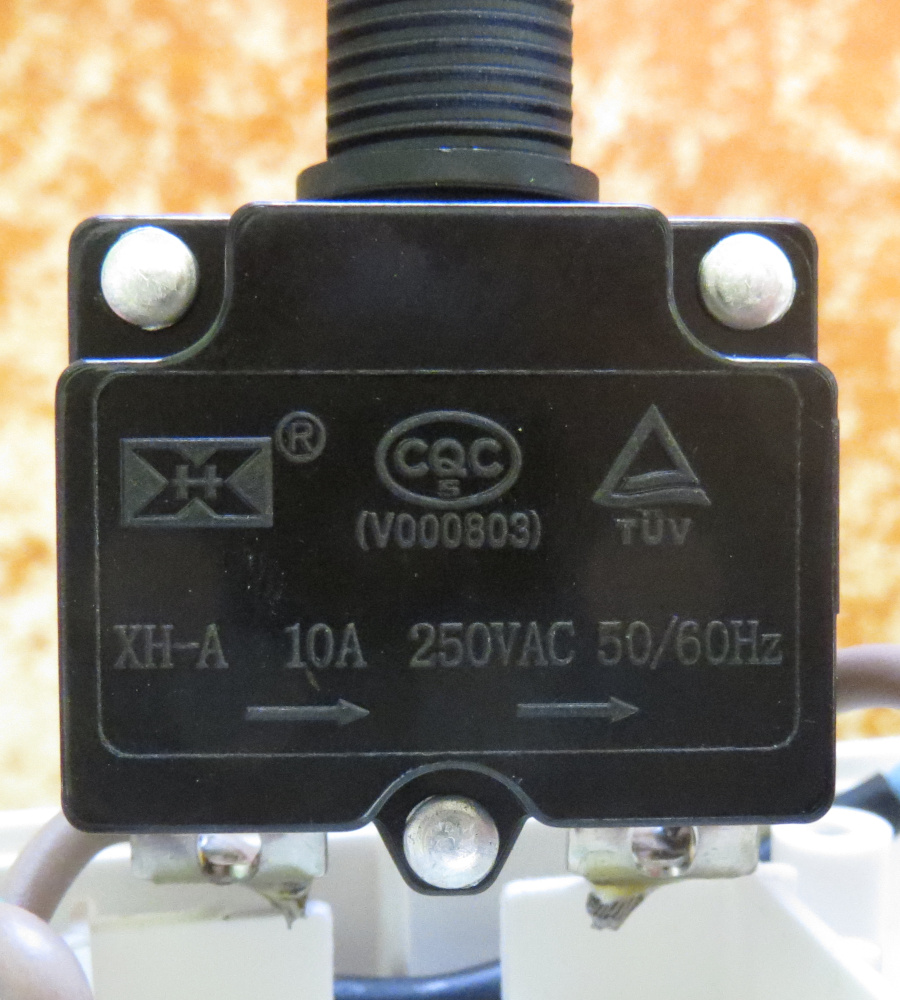

Current testing
My modified MPT‑301 will be handy here as well; I've wired in 2m of H07RN‑F2X4 cable to (what was originally) the +5V output (and ground via my current shunt), and will then connect this (previously using the MJ, now Wago 221-613 terminals) to wires of the normal size used for the items' circuits. I've prepared for this by also buying 1m each of 4mm² and 6mm² TPS cables (both sizes have 2.5mm² earths to Australian standard) which I can strip and cut apart as needed.
While the MPT‑301 is label-rated for 30A on the +5V, this is rectified by 2×SBL3040PT in parallel so can manage a bit more for some time (the design was later uprated to 400W and 35A on +5V, with only the +12V rectifiers being visibly upgraded).
I will first apply the rated current; then if the item remains cool to the touch after 1 hour, gradually step the current up until it gets too hot to touch comfortably. I'll consider 25% overload as a baseline (it also makes a nice reciprocal to the irksome American "80% rule" for sustained loads); if something melts at or below that current, it'll receive a warning from me. (Well, a 45% overload test for 1 or 2 hours would better-correspond to circuit breaker trip requirements, so I'll also do that.)
Where flexible (finely stranded) cores are used under terminal screws, I will test them with and without bootlace ferrules (I don't know if Australian Standards require ferrules in these situations, though I believe VDE regulations do). Rising-clamp terminals will not use ferrules.
To start with, the BS‑POD10; I was concerned that the main active bar (4.0mm wide in the same 0.7mm phosphor-bronze as the other contacts; i.e. 2.8mm² of phosphor-bronze, which in conductivity is equivalent to 0.42mm² of copper) may get hot at 16A (or potentially 20A) combined. (I don't know if the official standard allows a lower combined rating, but even if it does, that won't stop me from testing all the way.) Just changing it to brass (as suggested above) would bring it up to 0.78mm² Cu equivalent, while the Clipsal 2025's active bar is 0.7mm brass with 6.5mm width at the narrowest point (1.27mm² Cu equivalent). Anyhow, testing with shorted plugs in both sockets, it wasn't as bad as predicted; it seems cool enough at 16A, lukewarm at 20A, still under control at 23.2A (16A+45%), a bit hot to touch but not unreasonable at 25.6A (16A+60%), and very hot but still surviving at 29A (20A+45%).
So it seems that 16A combined is fine (after all there is a version with 15A sockets) and 20A combined is still kind of OK.
The M25S passes 32A without getting too hot, as does the Clipsal 30MD20 it appears inspired by (then again, for AU$58.18 you'd damn well want that Clipsal mechanism to); that said, new switches will invariably survive a greater overload than they will after the contacts are eroded by thousands of on/off cycles.

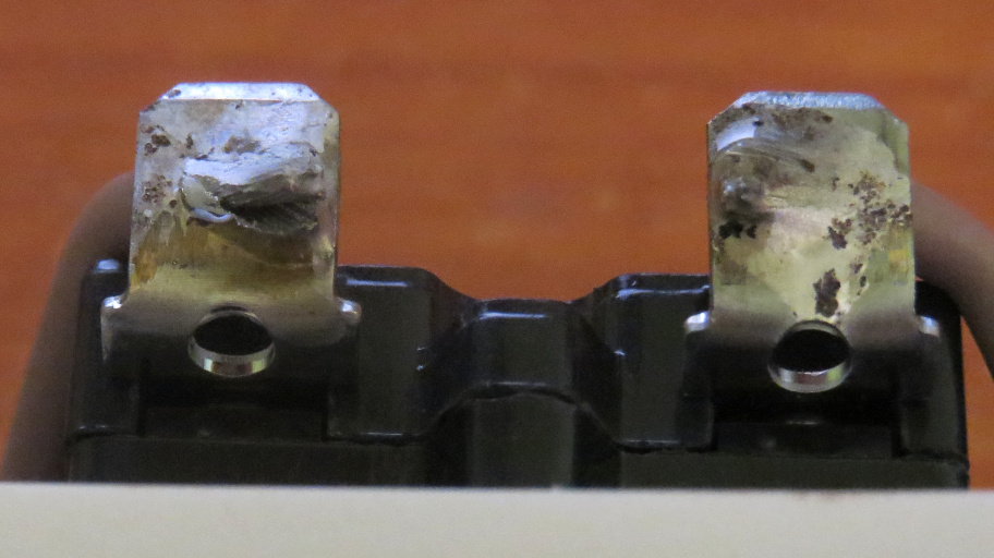

Then the CR01; given its simplicity I didn't expect any drama during the load test itself, and indeed none occurred. Despite the PR310 and PFR310 cover concerns, I couldn't see anything wrong with their actual contacts either, and they survived up to 24A when wired with 1.5mm². (Well, the PFR310 did; I haven't actually loaded the PR310 yet, but provided the wire clamps hold solidly – which they do – and the pins are correctly dimensioned, not much else can go wrong in that regard.)
Tarnished terminal blades notwithstanding, the SMS1_1QF still works, even overloaded to 16A. But I can't directly guarantee that this will work every time, so it's your call if you have enough confidence in it (and CSG's proclaimed in-house warranty).
Still, for a challenge, I decided to reconnect in another place on the cable – only for the frame to break (it's for one-time installation only); but it still made contact, so let's continue under load :mrgreen: Even over 30A for a few minutes, while the cable got very hot indeed, didn't send it up in smoke. I think I'll keep the SMS1QF around, rather than also sacrificing it for test's sake (the contacts aren't very different in design, and in better condition on my SMS1QF sample).

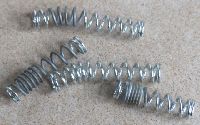

Toasted springs.JPG (136.76 KiB) Viewed 174936 times

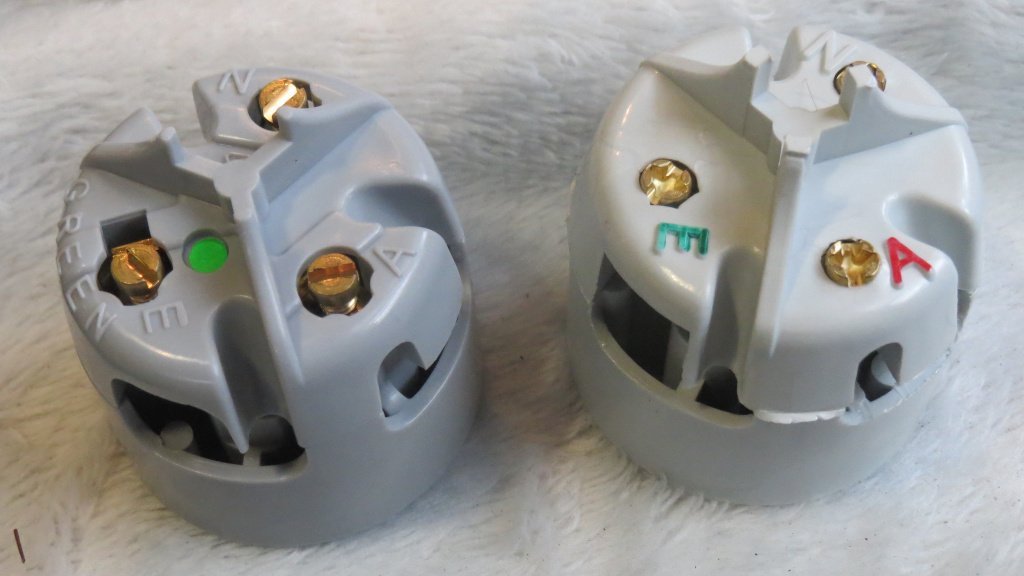

But the BHC and LH01 (well, strictly speaking I borrowed the LH01's springs for a second test of the BHC) failed under 3.75A (B22 springs overheated and annealed), and even at 3A they're right on the edge. (For comparison, the Clipsal 530 and 501 are also rated 3A but have no problem surviving 3.75A.)
Either thicker springs should be used, or the rating dropped to 2A. Their catalogue says 10A :group:
After this, I tried the BHC's terminal screws (8.5mm long) in place of the CR01's (6mm long). Only now they're too long to close the cover, unless screwed in most of the way :silly:. It would have been better to orient the terminals differently, so the screw length wouldn't be so cramped.

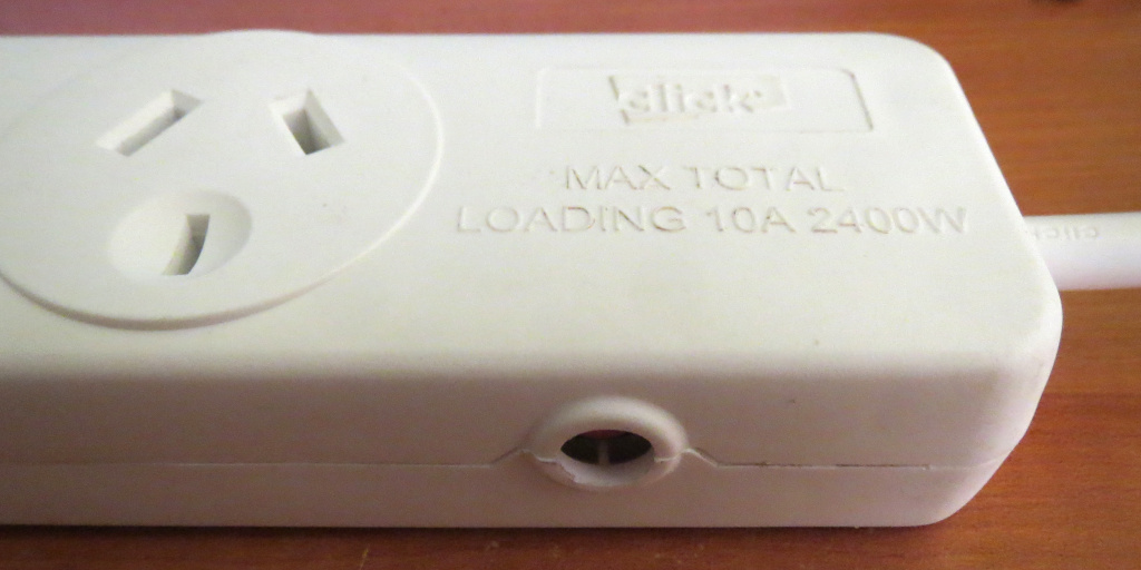

Power-boards (or power-strips in the USA etc.) don't generally get much attention to their build quality, largely because they just don't have enough to go wrong (though they can be quite dangerous when it does, and I had one dodgy model short out the mains when bumped). In my experience, their main weakness is socket contacts loosening after repeated plug insertions; therefore, more-robust contact designs are something I've been looking for in them.
So far I haven't thought much of the “Click” brand (although they've been around for decades, I've not been overly-impressed by their prior products and they don't have a website), but I noticed in Bunnings (though I mostly go there for non-electrical items) that some (but not all) of their power-boards have decent-looking contact designs, despite being among the cheapest on the Australian retail market:
CLKPB4, CLKPB6
(Note: My units are a different version to those pictured by Bunnings; look for the cord centered on the right end, and reset button on the bottom edge.)

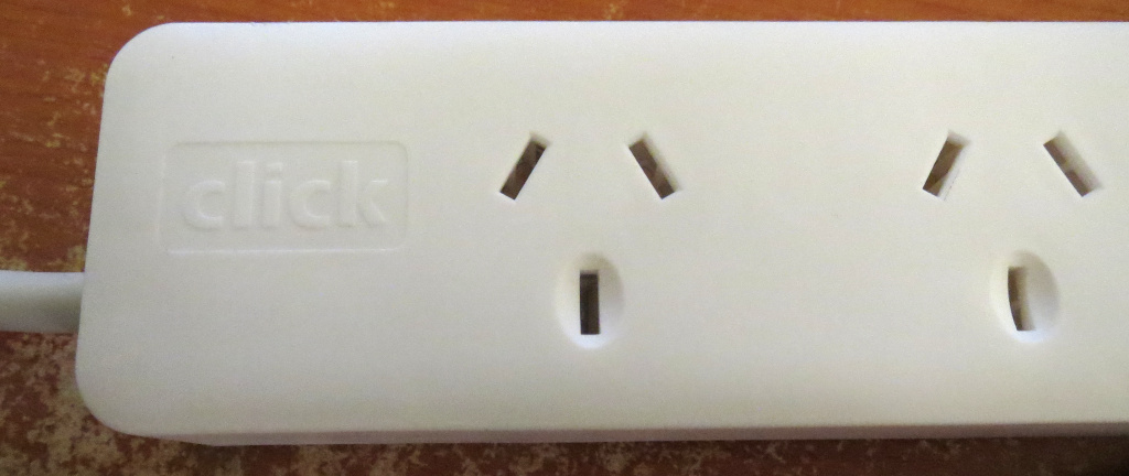

I actually rather like the diminutive casing; many power-boards have unnecessarily bulky casings seemingly just to look more “substantial”, but to me that's just a superfluous waste of plastic (especially if the contacts aren't beefed-up to last).
CLKPB4 front right.JPG (152.29 KiB) Viewed 173562 times

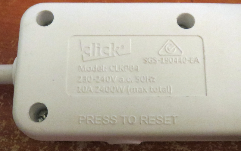

Tag front.JPG (237.36 KiB) Viewed 173562 times
Tag back.JPG (276.33 KiB) Viewed 173562 times
For AU$2.74 and AU$4.98 respectively, I figured them worth checking out even if there is a catch. Of course, at prices that low you get no real packaging; just a tag around the cord, and a pair of twist ties holding the cord in a bundle around the board. My CLKPB4 is dated August 2022, the CLKPB6 from September 2021.
Approval number shared with CLKPB6 (and some Arlec models of the same general design)
CLKPB4 back.JPG (121.88 KiB) Viewed 173562 times
Like most of today's cheaper power-boards, the casing is polypropylene (which I actually prefer to ABS in this application, as PP is more resistant to heat and UV; polycarbonate as on wall switches and outlets would be better again, but more expensive). It's not so weak either, I've felt flimsier models before (some of which are sold for a few dollars more). The circuit breaker is recessed quite deep (even when tripped the button barely protrudes), but if this is the worst inconvenience then we're doing alright. The screws are a divided-slot type (or whatever the proper name is), the CLKPB4 has 7 and CLKPB6 has 8 of them.

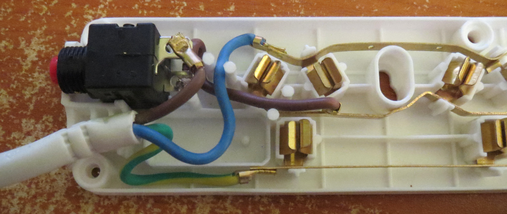

Yes, the busbar is a bit twisted at the neutral weld; the casing presses it back into shape when assembled, but I straightened it anyway.
CLKPB4 inside.JPG (320.72 KiB) Viewed 173562 times
Seems to be enough guides to stop anything from going where it shouldn't.
CLKPB4 inside back.JPG (178.67 KiB) Viewed 173562 times
Cord clamp.JPG (82.44 KiB) Viewed 173562 times
At least the clamp itself didn't do the damage here.
CLKPB6 pinched cord.JPG (244 KiB) Viewed 173562 times
The cord clamp is actually a separate piece with two screws (rather than comprised of the two casing halves), which is virtually a luxury at this price :mrgreen:; although my CLKPB6's cord was pinched a bit in the casing. The cable itself seems adequately flexible, with proper copper wires; both measure within 2cm of the specified 0.9m.
CLKPB6 unused socket contacts.JPG (173.82 KiB) Viewed 173562 times
The circuit breaker connections are soldered (not so well in my CLKPB4, although not an outright fail), while the busbar connections are made by brass crimps on the wire which are then spot-welded to the bars (these look fine). The socket contacts are sideways-wiper arrangements, although some were formed so tight that the first insertion spreads them out noticeably (it's probably better not to overdo it like that); but they do appear to contact the plug pins over a good area.
The bar section is about 3.5mm by 0.5mm, i.e. 1.75mm² of brass (equivalent in conductivity to 0.49mm² of copper, although heating is mitigated by the larger surface area and surrounding free-air space).
Your standard thermal-element circuit breaker
CLKPB breaker.JPG (302.94 KiB) Viewed 173562 times
Overloaded to 20A, the CLKPB4 and CLKPB6 breakers tripped in 21 and 19 seconds; going up to 25A gave 9 and 6 seconds, then 30A gave 5 and 4 seconds.
For the normal-load test I set 11A to ensure a tolerance margin; over 2 hours and no trip.

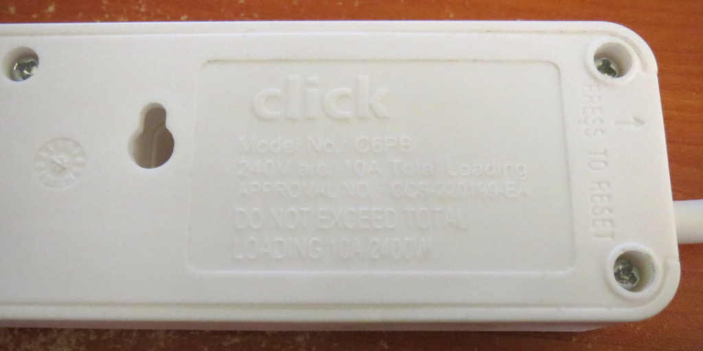

There's also a bundle of a 6-outlet power-board + 4m extension cord, although this power-board (C6PB) has a different design:
C6PB (not found on Bunnings' site)
C6PB front.JPG (128.89 KiB) Viewed 173562 times
C6PB back.JPG (143.65 KiB) Viewed 173562 times
This model has a less-cluttered look, although that has a side-effect of making molding distortions (a drawback of polypropylene) more noticeable.
The screws here are tri-wing; the date code is for March 2022.
C6PB inside.JPG (190.31 KiB) Viewed 173562 times
This time the cord grip is entirely integral to the casing.
Unusually for a modern power-board in Australia, the contacts actually have a full wiper arrangement; their alignment is a bit off in places, though, so might not maintain contact along the whole width. Still, since they have a larger back area to rest against the casing, they won't press into the plastic (as could be the case with other contact designs). The earth and neutral bars are 0.5mm thick, the active 0.6mm for some reason; all are about 4mm wide.

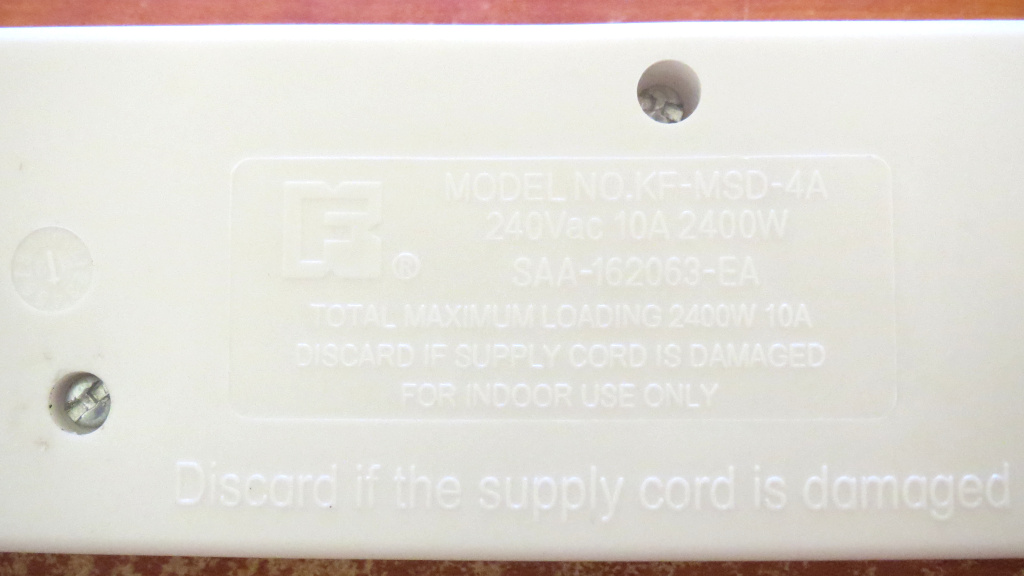

Ningbo Kaifeng KF-MSD-4A
Postby LongRunner » January 26th, 2023, 11:40 pm
Update 2: BizLine has switched to a cheaper look-alike; those French jerks :dodgy:
:exclamation: Beware of cheap power-boards which are made to look the same from outside, but are NOT built to the same standard. :exclamation:
Arlec/Click have been guilty of playing dirty in this manner – their look-alikes had ordinary low-life contacts, and worst of all, had to be recalled in 2017.
So if buying these under any rebrand, you must look for the same approval number (SAA-162063-EA).
During one final time at the second-hand store, I found this among the new items:
It was packaged as “Handy Hardware” (a brand of PJ SAS Trading) item number 76802, and sold at $11.50 (on the expensive side for a 4-outlet board with no extra features). But I could see through the packaging that it has full wiper contacts, and a normal breaker (which can't be just held on), so let's give it a chance:
Dated April 2019
The casing is again polypropylene (with the normal slight distortions).
Here's the category page, by the way (the individual product pages add little of relevance, other than to volume customers).

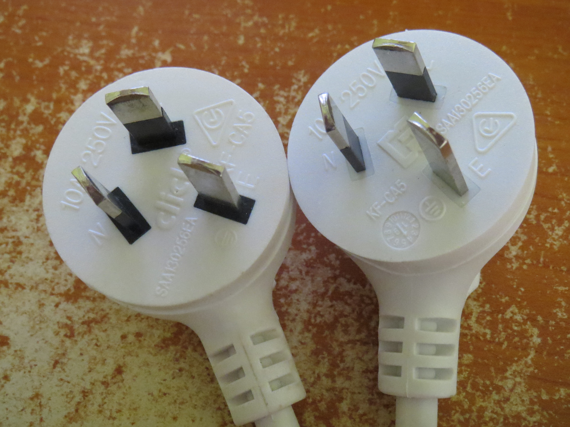

Plugs 1.JPG (225.32 KiB) Viewed 173048 times
The plug has a cleaner molding than that on the CLKPB4; the cord feels flexible enough, though at 90cm it falls a bit short of the “1 metre” on HH's card.
But take a look at the plug faces:
Plugs 2.JPG (346.64 KiB) Viewed 173048 times
Evidently the Click CLKPB4/6 are also manufactured by Kaifeng, albeit with a different design.

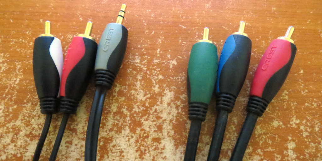

While at the same store, I also found a decent-quality 3.5mm to RCA cable (an older Crest model) to replace the Con Cord. Here are the plugs so you can identify it (and also a component video cable of similar design, which I found the previous time to also replace an unshielded, stiff generic):
Crest AV cables.JPG (270.21 KiB) Viewed 173048 times
