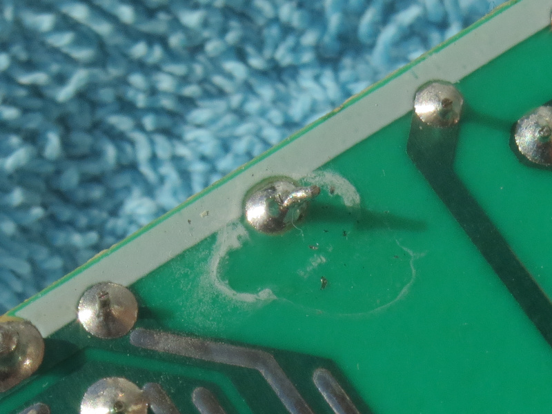

It's a bog-standard flyback SMPS, driven by a TOPSwitch-JX (going by the package and pinout; can't reach the clamp screw to reveal which variant) with the +24V output rectified by an MBR20200CT with insulated tab. No PFC, no MOV, though at least the NTC thermistor is present (but unsleeved).
Could be worse I suppose, but it's quite bad enough (especially being before the fuse).
Soldering mess.jpg (266.23 KiB) Viewed 34600 times

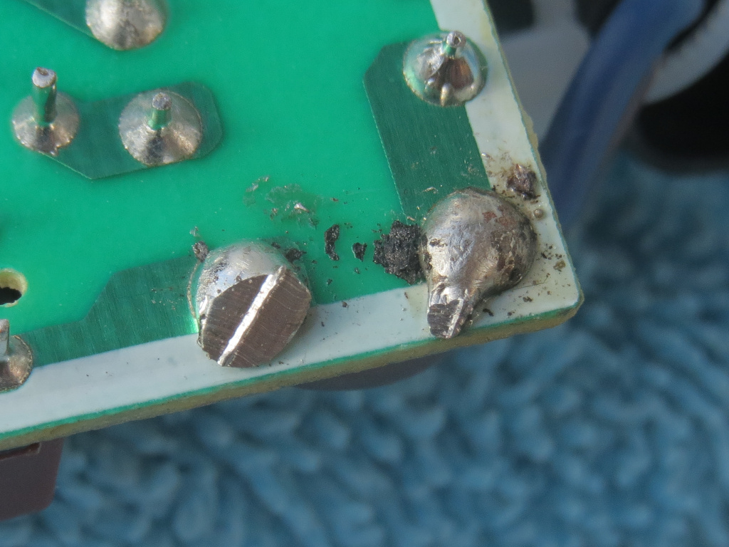

Mess 2.jpg (181.03 KiB) Viewed 34600 times
There's quite a mess of flux where the cord wires are soldered in (and a bit at the junction of the two Y1 capacitors), so I cleaned that up after taking these.

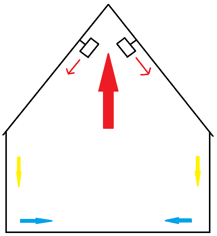

another option I can think of is some 30cm tube fans, those should also be able to force the air reasonably down, when mounted on the aprox. 45° angled halfs of the roof, facing down - would suck the hottest air from the middle (where they have furnace, assisted with ACs in heating role on the sidewalls, but those could also be directed to blow the air towards the midle of the hall) as per the cutaway image I drawn; could use some like these https://www.ventilatory.cz/kovovy-potru ... -mm-x12741 which are still reasonably priced, could be speed-regulated and they provide simple metalic mountings struts for them too (as they are often used as simple blowers, without actually being in any piping)

Yeah, those tube fans look like a decent option for the circumstances.
In the worst case, if they still have a far corner or crevice that's colder than the rest, it could then be filled in with a portable heater (depending on the size of the cold spot, even one of those precious little 500W types may suffice; if you want better quality, DēLonghi also have 360W models with a thermostat)…

I guess its not like its actually cold, but it takes a lot of energy to get it comfotable near the floor when they are heating like 70 % of the total volume above their heads; I guess I made the walls taller than they actually are relative to the roof, its like 12 meters in the middle where it's tallest, the side walls are barely above 2 meters
