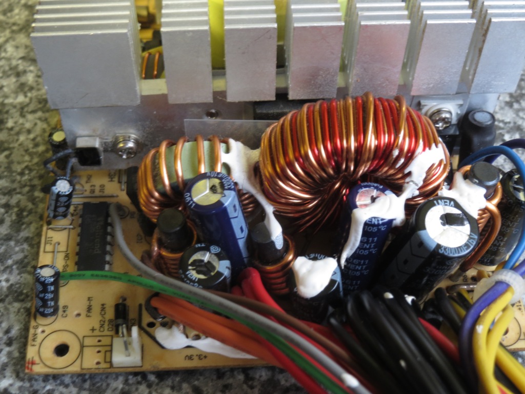

Continuing with the MPT-4012...
The +3.3V and +5V have the same rectifiers as in MPT-xxx. The +12V now has 2 x MBR20100CT in parallel. The +5VSB has an SBL1040CT.
This time there are pi coils on all the rails (except -12V which uses a 7912 as previously mentioned), and the one on the +12V is massive. All of the main rails have OCP. +12V is split into two - one for the CPU (15A, black stripes) and one for everything else (14A; the combined limit is unspecified).
The main switchers are 2 x 2SK2765 in parallel and the 5VSB switcher is a KHB4D5N60F.
Unlike the older MPT-xxx units with their distinctive colour scheme (purple for +3.3V, orange for Power Good, brown for +5VSB and grey for on/off), MPT-xxx2 uses the standard colours.

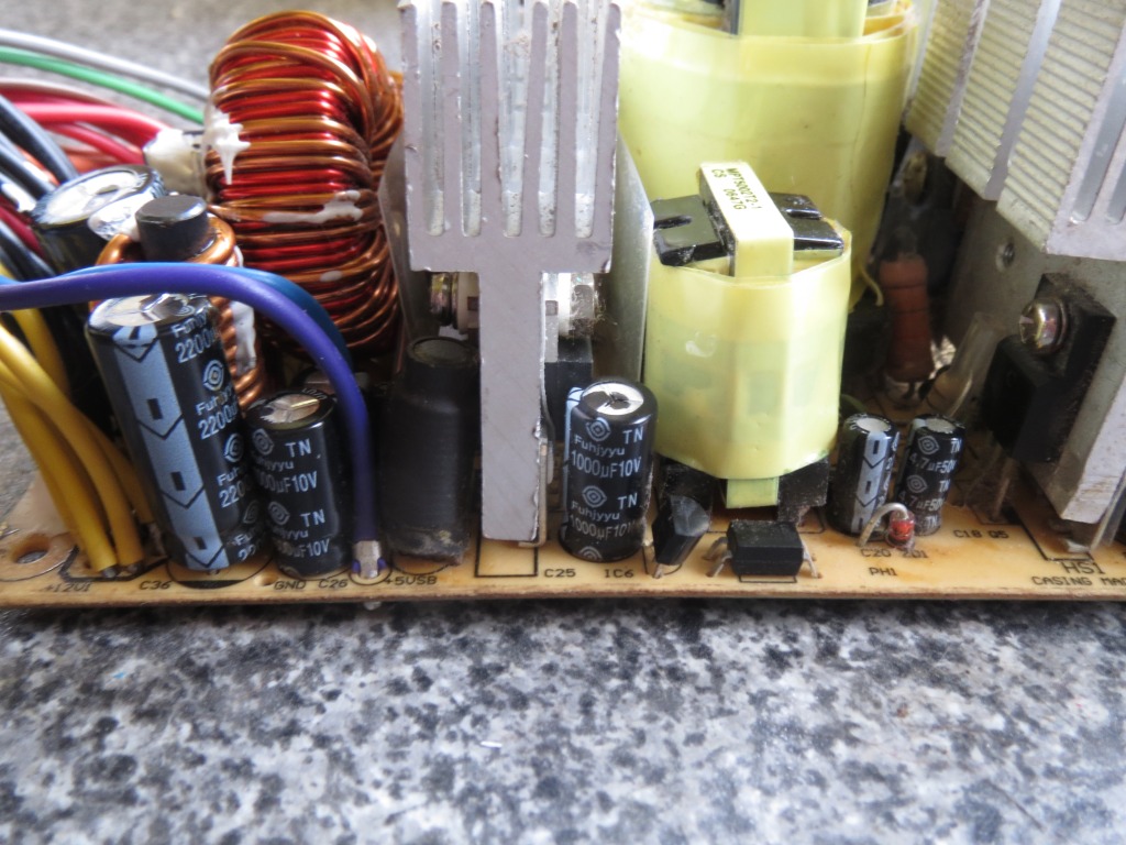

The location of the smallest capacitor in the unit, which is also the only one not made by Fuhjyyu (not that GoldLink is any better).
Optocouplers and surroundings.jpg (194.19 KiB) Viewed 50565 times

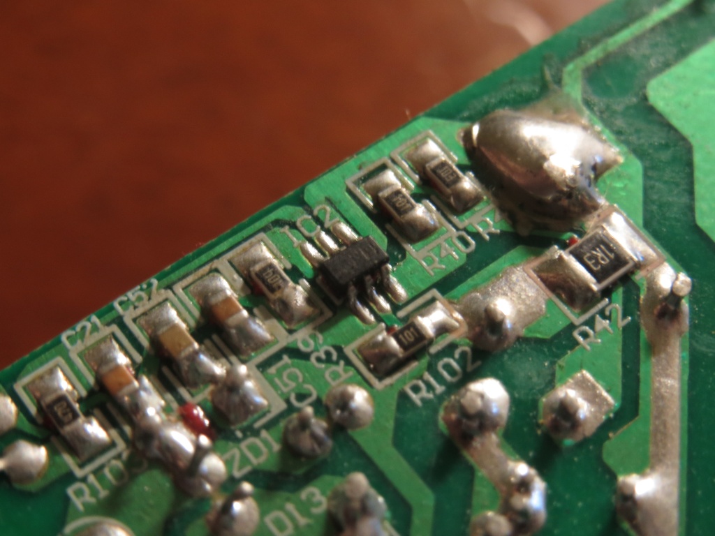

Tiny, isn't it??? Too bad it doesn't have a legible ID :(
+5VSB IC.JPG (203.92 KiB) Viewed 50565 times

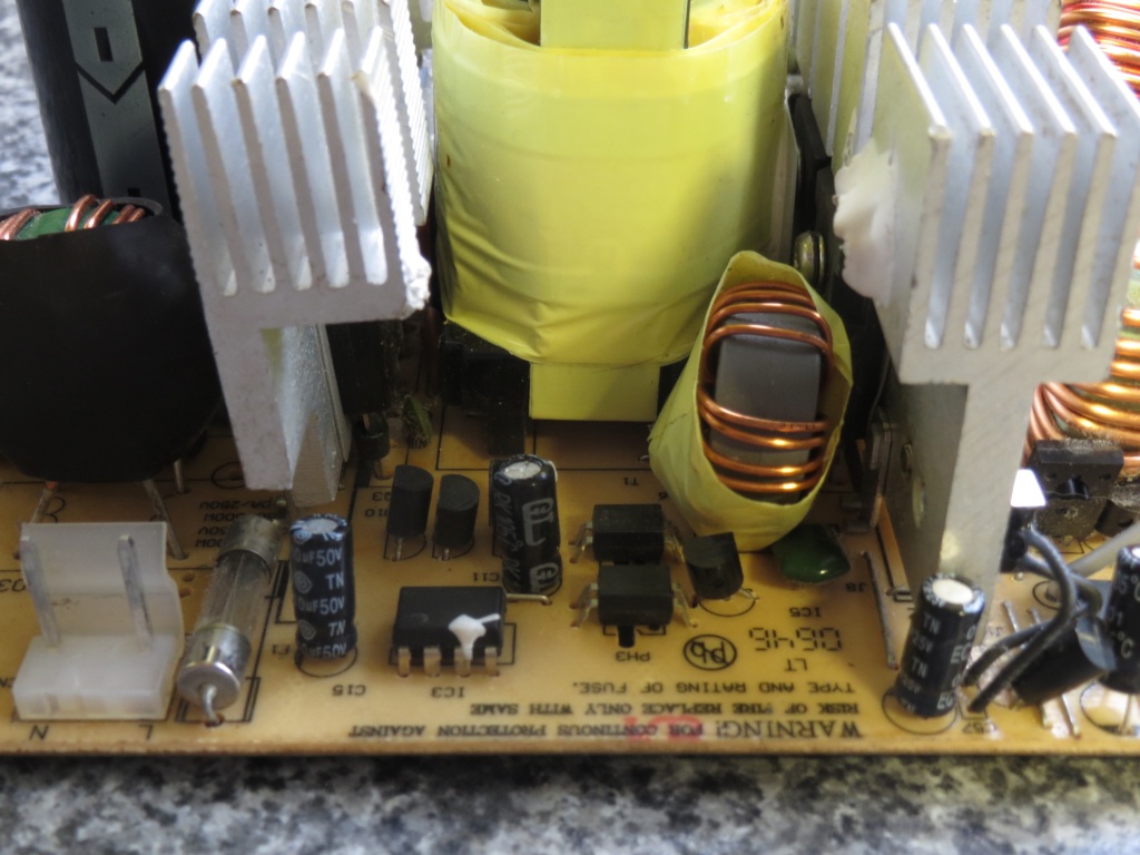

On the left side of the heatsink is the -12V regulator and on the right of it is the +5VSB rectifier.
+5VSB area.JPG (206.78 KiB) Viewed 50565 times

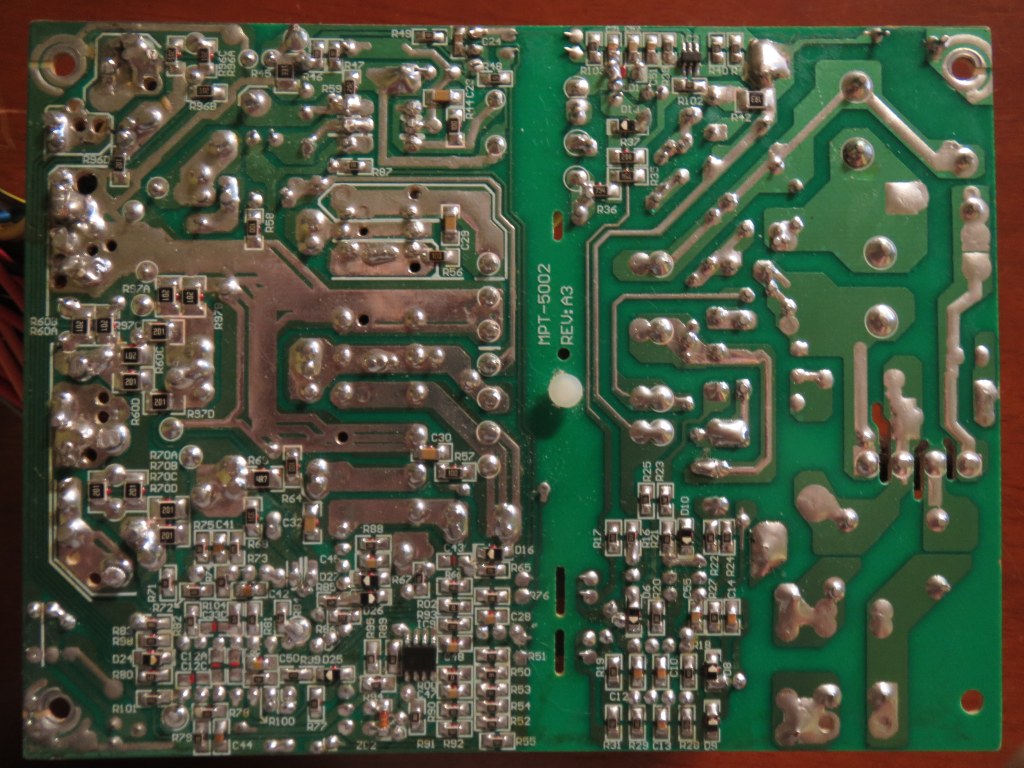

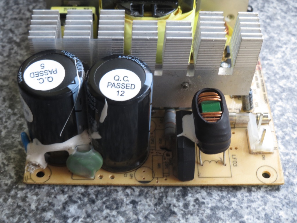

The second set of attachments is here (due to the 3-per-post limit). As for the circuit used by CWT and a few others (including Jou-Jye IIRC) that blows 2.2µF 400V electrolytics by putting them next to hot resistors, read this review. I severely doubt a circuit with two hot resistors is going to improve efficiency, though and it won't boost the voltage noticeably with the main supply running anyway.
The MOVs are between the primary capacitors and the heatsink. The two unlabelled through-holes are seemingly for the PFC coil terminations had it been installed, which would require cutting a PCB trace between them (odd that they didn't just use a jumper for the no-PFC version).
The minimum load resistors are 4 x 200Ω on +3.3V, 8 x 200Ω on +5V, 4 x 1.0k on +12V, 1 x 2.0k on -12V and 1 x 330Ω on +5VSB.
Solder side.jpg (204.42 KiB) Viewed 50565 times
Some pretty beefy coils here ;) There is also provision for a tachometer fan, which would go with a cable carrying the speed signal to a motherboard header. All main rails have the larger cap before the coil.
The PCB is provisioned for that same circuit used by CWT that, while intended to improve power factor, ends up being one of the best ways to dry out 2.2µF 400V caps.
