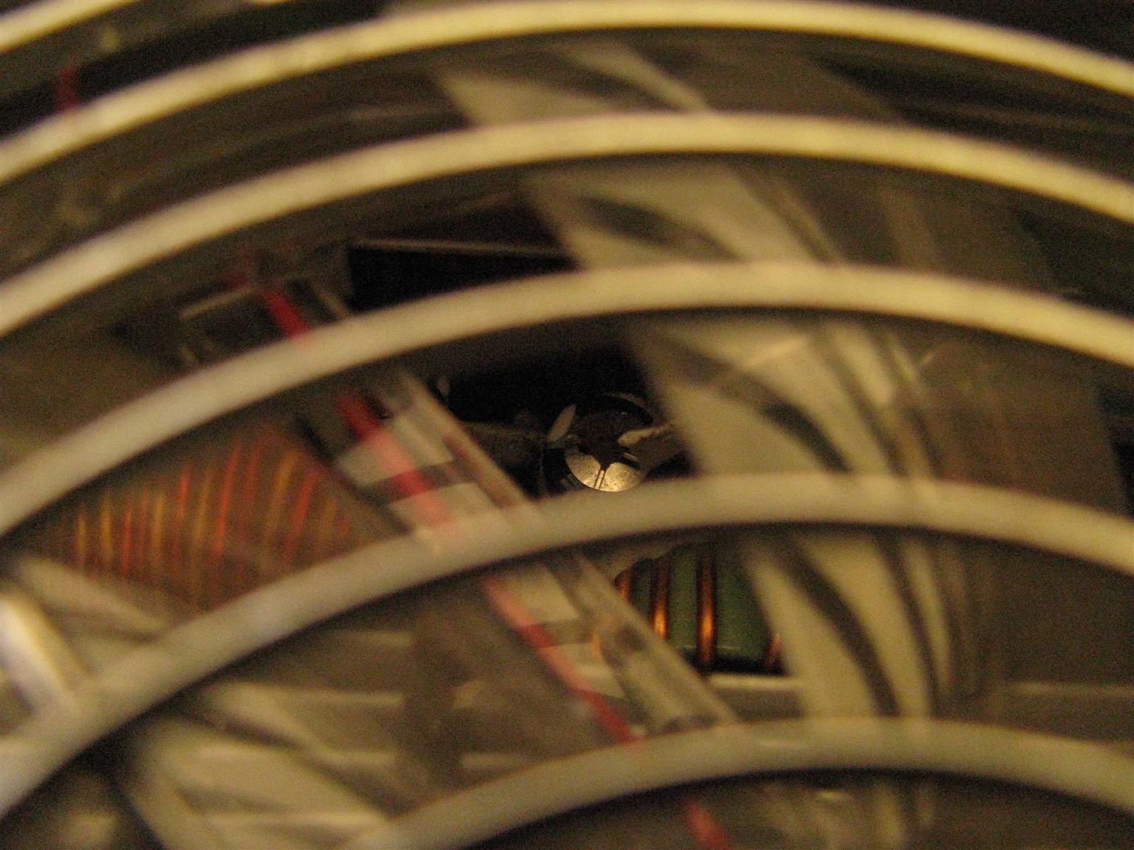

Postby c_hegge » November 17th, 2013, 10:31 pm
Darn it! Looks like I'm going to have to have a word with the fleabay seller and find a more reliable source. The MPT-4012 arrived with bad caps.

Postby LongRunner » November 18th, 2013, 2:34 am
I knew it was going to happen...by the way, what's the brand and series of that cap??? I'm just curious...
The fan is still in good condition, right??? And surely it's worth recapping...
But it's disappointing to get something to review and not be able to. :(

Postby c_hegge » November 18th, 2013, 2:50 pm
The bad caps were all GoldLink. I can't remember the series. The fan is a Ball Bearing Power Logic, and it seems to spin freely, and yes, I will be recapping it.
