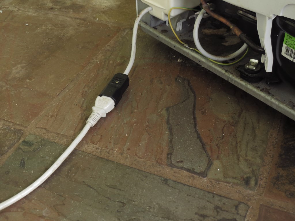

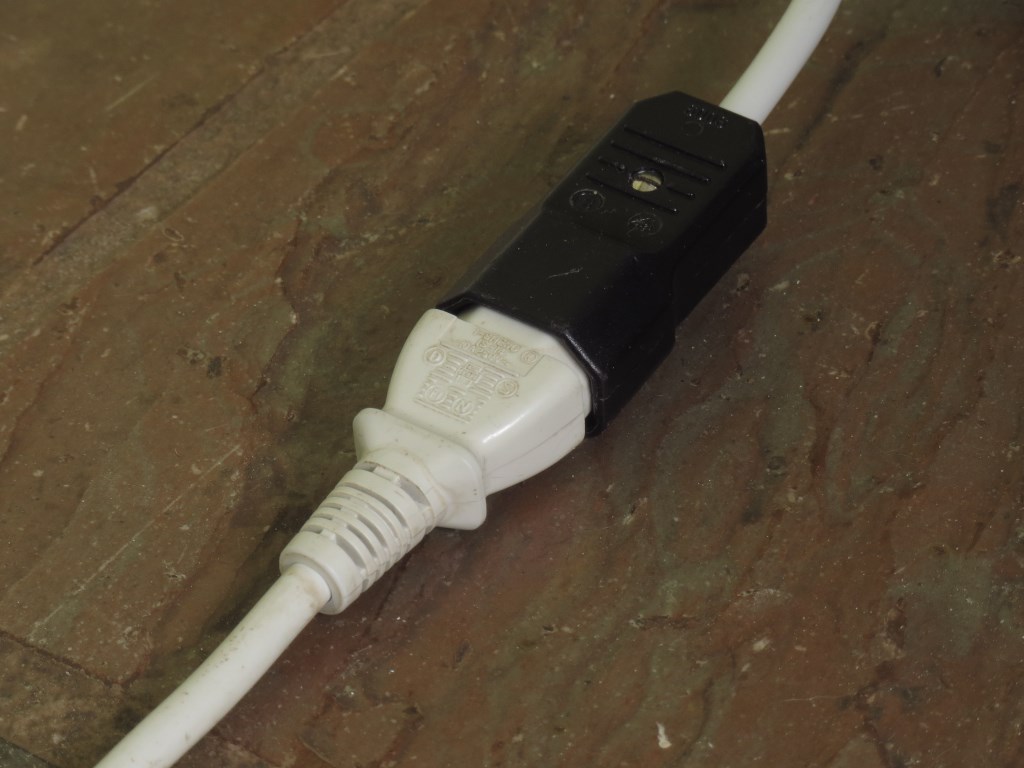

So, what do you do when those rascally rodents have chewed up most of the power cord on your refrigerator (despite having two cats in the house), but you just happen to have a spare cord with a rewireable IEC male plug (among your huge stash of other cords saved from the landfill)?
Fridge power cord mod (at a glance).jpg (139.2 KiB) Viewed 60583 times
Fridge power cord mod (hero shot).jpg (111.26 KiB) Viewed 60583 times
Courtesy of yours truly.
(Unlike many home-grown emergency "repairs", this one should actually be safe enough – provided that a counterfeit cord is never used and the plug is wired correctly, obviously. The only notable omission I had to make is the strain-relief sleeve; that's because the plug shown is, unusually, designed specifically for cords with light-duty insulation – which are not allowed on major appliances, which are required to use ordinary-duty at least. But I figured that the cord on a refrigerator won't take much strain, and it's also worse for wear anyway; and I was at least able to mount the internal clamping bar, which is enough to prevent the cord from pulling out of the plug. One other thing I have to note though is that many refrigerators in North America use an SPT-3 ribbon-type cord, which is unlikely to fit into the common rewireable IEC connectors that are designed for round cords. As a matter of curiosity though, that particular plug is able to solidly clamp a common European H03VVH2-F2X0.75 cord or its Australian Standard equivalent, and it even has removable pins so you could leave the earth pin out and effectively convert it into a G type [often referred to informally as C18, as denotes the functionally equivalent panel inlet] plug. But practically speaking, the only precaution you have to take for this arrangement beyond those needed for the original cord is to avoid accidentally unplugging the arrangement and potentially losing your groceries.)

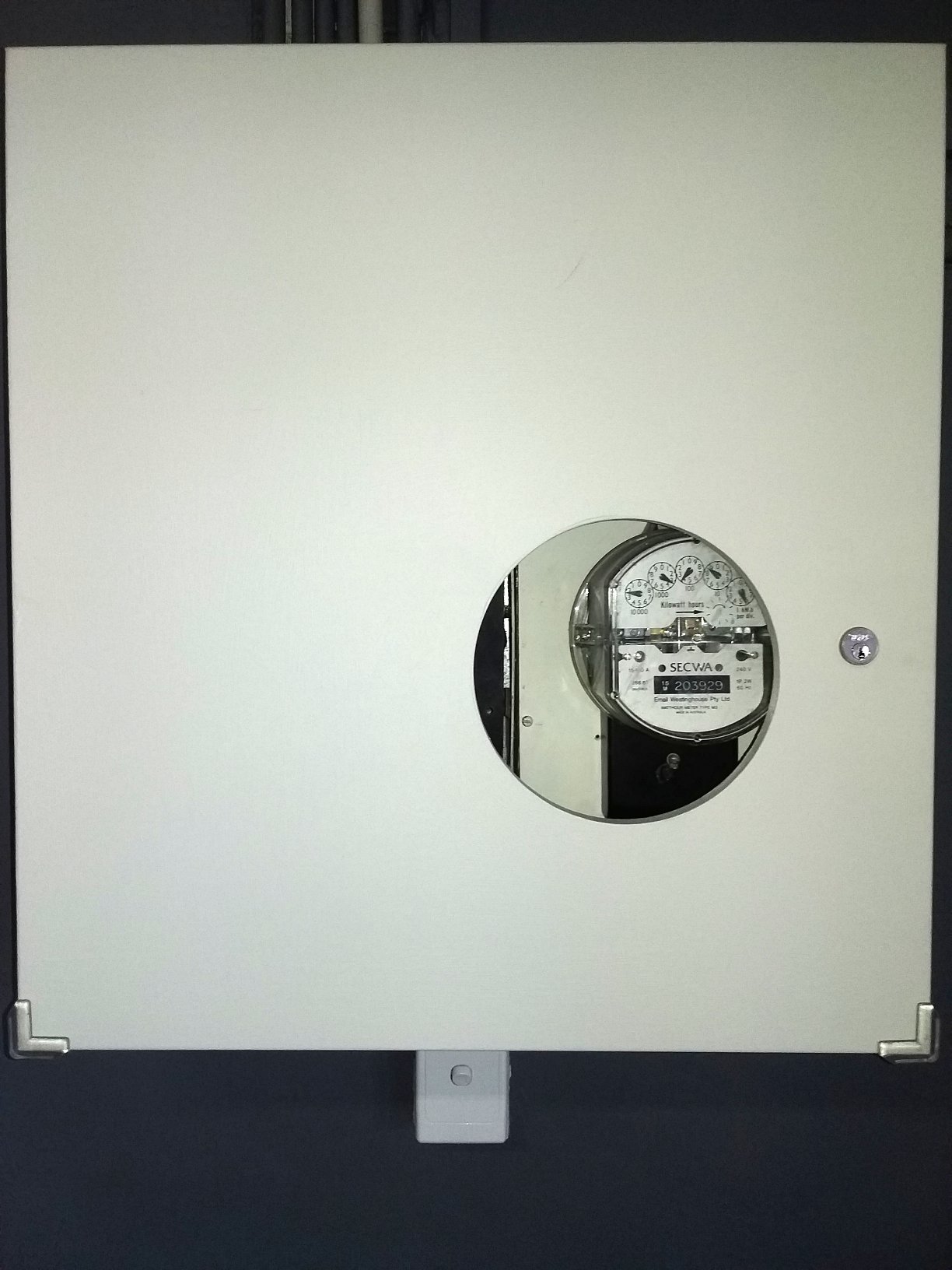

Dodgy meter box
Postby LongRunner » June 22nd, 2020, 1:27 am
(The opening is supposed to be in front of the meter.)
Dodgy electricity meter housing.jpg (221.61 KiB) Viewed 51766 times
And since it was installed by a "professional":
Then again, "qualifications" don't seem to prove a damn thing anymore anyway, so how surprised can you be? :rolleyes:
