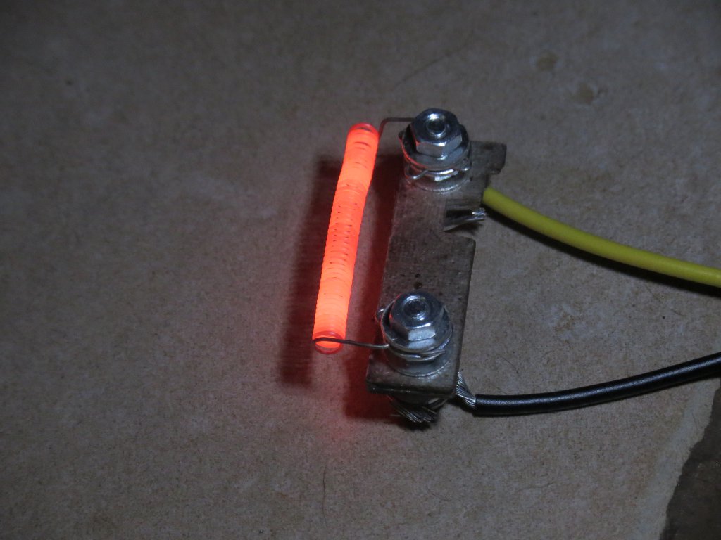

Here comes my glow wire ignition tester:
12V 5A (60W), wound with 0.5mm FeCrAl wire (salvaged from the KFH200, together with the mica supporting pieces) around a 2mm screwdriver shaft (removed before applying power, obviously)
Glow wire tester hot.jpg (43.08 KiB) Viewed 151149 times
(And yes, I piggy-backed it off my PC PSU. :D)

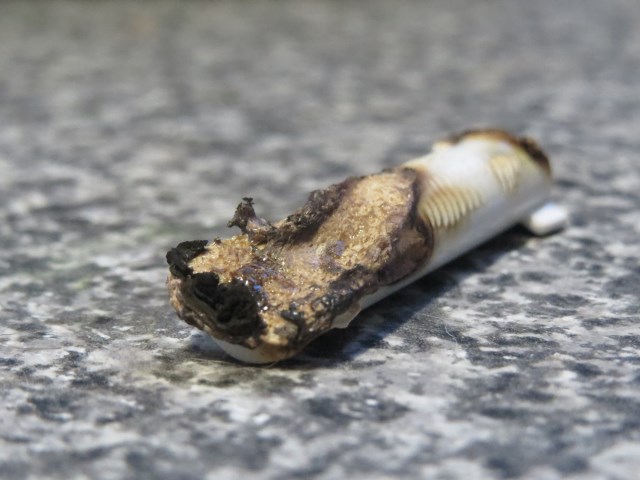

So, I used it to test the broken-off pillar from the GSFH110/FH-07A. But while it ignited easily enough, it self-extinguished shortly after the heat was removed (I'm almost disappointed :-/):
Pillar burn result.jpg (60.83 KiB) Viewed 151149 times

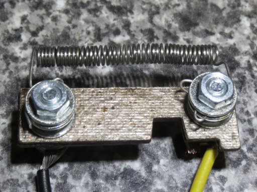

So, I've swapped it out for some NiCr wire salvaged from a different fan heater (which was very battered, so I decided against continuing to use it); that straightens out well enough with a good tension. I then dragged it between a pair of kitchen scouring pads to remove the residues of burned dust (and hair, etc.), after which it looked almost as good as new. Here's the coil I wound (I remade the terminations while I was at it):
(The apparent 'wetness' isn't an illusion; to get the element as clean as I could, I dipped it in boiling water and then in isopropyl alcohol.)
New element.JPG (56.48 KiB) Viewed 149331 times

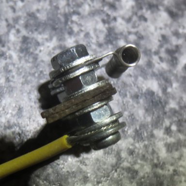

(OK, this still isn't perfect…)
Termination side view.JPG (29.16 KiB) Viewed 149331 times

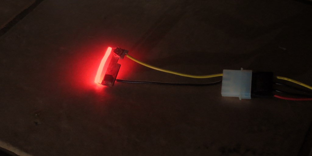

Because this wire is ever-so-slightly thinner than I thought when calculating the length, the resistance ended up a tad higher, giving power in the realm of 54W (or thereabouts). It still seems quite hot enough, though :-)
Glowing again.JPG (95.8 KiB) Viewed 149331 times

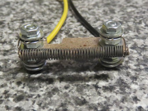

Not a bad performance, given the temperature (I've successfully melted aluminium foil at the end of the previous FeCrAl element, so it must be >660°C); it's not noticeably brittle yet. (And given that even radiant heater elements can last for many years, I suppose the sky's the limit for a well-made convector…)
After endurance test.JPG (47.35 KiB) Viewed 149331 times
I plugged it into my PC PSU and gave it an endurance test of (just over) 1 hour; it passed easily enough (albeit with more oxidation already, than it ever developed in the original fan heater). It holds its shape a lot better than the FeCrAl wire did, too.
