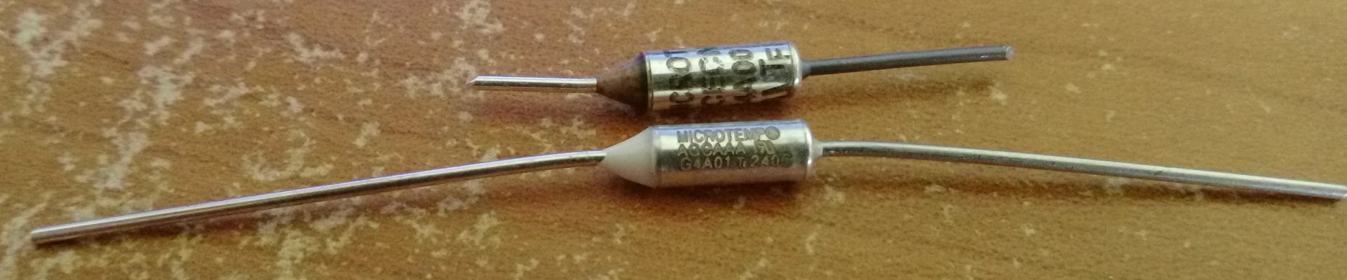

Counterfeit Microtemp?
Postby LongRunner » July 7th, 2020, 5:18 pm
Well, even the thermal fuse from the Euroflex Monster SC3X1 is dodgy. It was meant to cut off at 240°C, but my thermocouple read all the way up to 417.8°C peak (producing smoke, melting part of the PFA thermocouple wire insulation, and even discoloring the silicone insulation on the earth wires) by the time it cut off; here's it compared to a (hopefully) genuine Microtemp (same temperature even; previously ordered from element14, to repair the Sunbeam EM6910 later):
(removed fake is on top; genuine below)
Thermal fuse comparison.jpg (121.59 KiB) Viewed 127799 times
Did they even try? :facepalm:
Perhaps bought through a middleman who tried the well-known tactic of supplying genuine samples, but switching to counterfeits for the actual bulk order.
I've upgraded the recall to High risk and will think about what else I can do (perhaps try to notify Therm-O-Disc, maybe even mail it off if they'll cooperate; and if their communication fails then that's their problem)…
EDIT: Looking at the Microtemp documents again, this one does appear to match the style shown there (perhaps they changed it recently).
That still doesn't rule out the possibility of counterfeiting, though.
But yeah, you can hardly trust anything these days. Red Dwarf is more relatable than ever (quoting from Demons & Angels):
Lister: The whole ship's full of fail-safes anyway. Coolant systems, containment panels, vacuum shields. The actual chances of it blowing are about one in…
(Red Dwarf explodes)
Lister: …one.
Anyhow: Stick with established reputable brands where you can (even if you have to buy used), otherwise inspect for yourself.
And whatever you do, don't rely on the consumer magazines…
Further update: A batch of 10 of the smaller Microtemp G7F (rated for up to 5A loading) are still printed in the old style, but the print is much clearer than this.
This seems to affirm my suspicion (and is probably indeed why Microtemp changed to etched text on the regular-size models).
I don't have my Kambrook KFH660 to hand, but its old-style Microtemp G4A also appears to have clearer printing in what part I can see from the photo.
