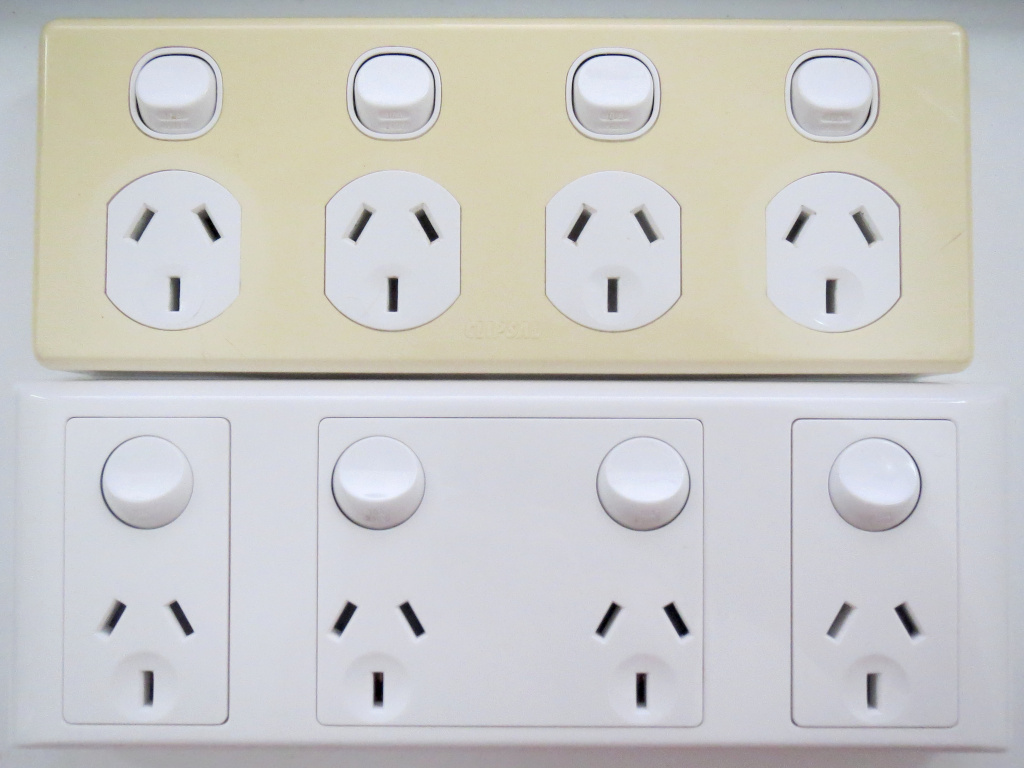

WBP4S quad outlet
C2015D4 versus WBP4S.JPG (201.61 KiB) Viewed 99356 times
One of the first Hager accessories in the local Rexel (AU$53.20), and a welcome substitute for Clipsal's C2015D4 (my unit having a very yellowed cover).
Being designed to retrofit in place of a double outlet (largely for convenience but also helpful in heritage-listed houses like the one I'm now living in, where you need to minimize any irreversible alterations), their profile is raised to accommodate the outer sockets over the wall surface. It of course has its own longer surround (thankfully also polycarbonate), with additional columns covering the standard (84mm) mounting points. Just be aware that it's slightly wider (211mm) than the Clipsal (196mm) and the optional corner fixings are further-out accordingly, so check the space before you rush out to replace your old C2015D4…

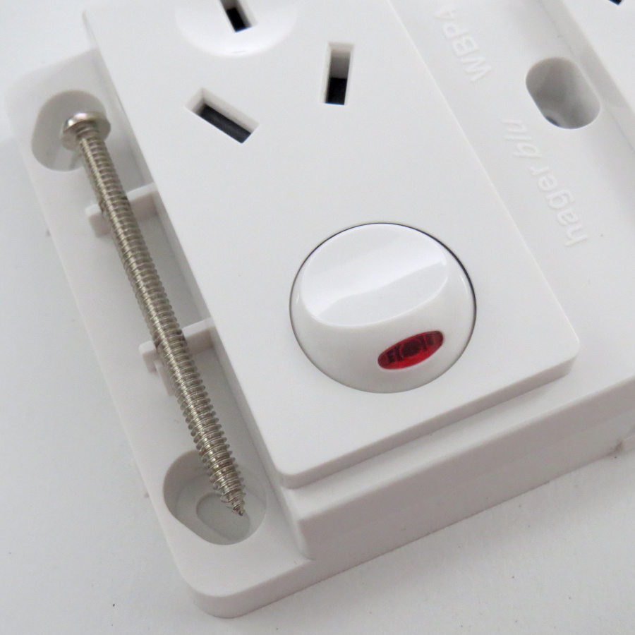

End screw storage.JPG (183.27 KiB) Viewed 99356 times

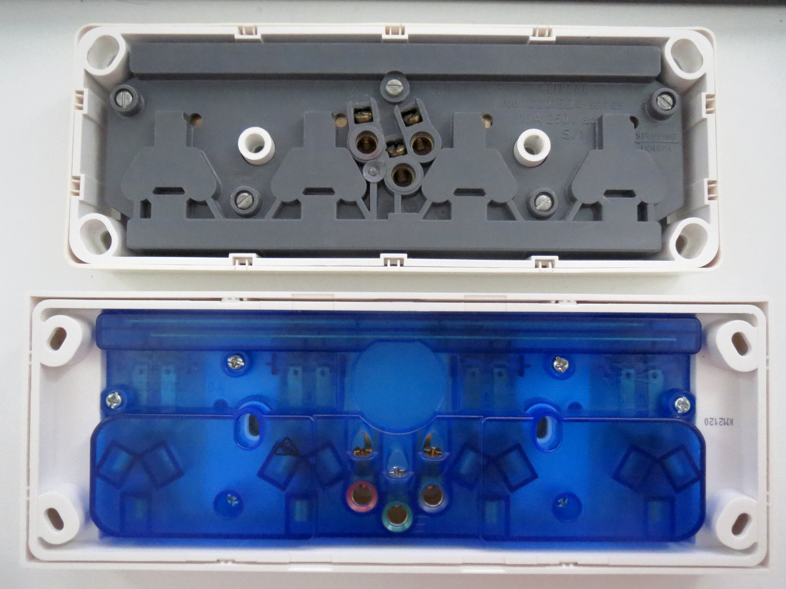

Quad outlet backs.JPG (641.84 KiB) Viewed 99356 times
Hager have chosen a distinctive translucent blue (or “blu”) for the rear frame; while the iMac was 25 years ago, this does reveal that the switches are double‑pole as in the Clipsal, Trader and Deta models (perhaps because the quad-outlet layout doesn't make single‑pole switching much easier anyway).
So to apply Hager's model-numbering scheme consistently, it should really be called the WBP4DS. Like the C2015D4, no part protrudes from the back.
The circular recessed area is where an extra switch goes in the WBP4XS; this pushed the terminals quite low, and indeed the inner sockets had to be spaced-out to accommodate them. Unlike Clipsal, Hager opted to keep the terminals symmetrical (as befitting the overall layout).

The screw heads do bottom-out on the terminals before their tips reach the bore, but will still grip a single 2.5mm² core solidly (provided it's twisted well) so this isn't a crippling flaw (but do verify the grip if connecting already-flattened ends, or if you do have smaller wires in some location).
The thread appears to be M4.5×0.75, in 6mm bores.

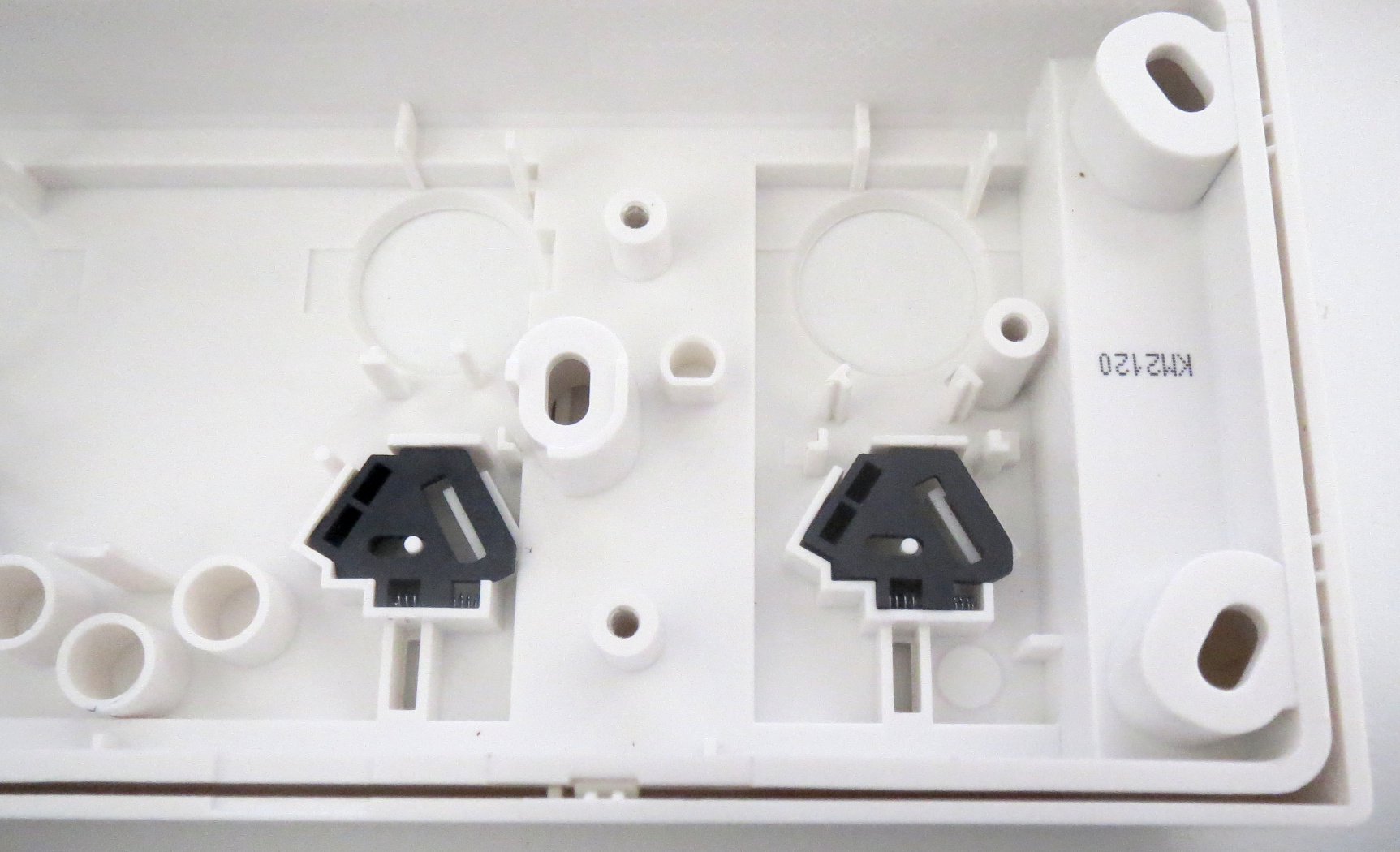

As usual in Australian outlets, the shutters are opened by the neutral pin so only protect the active.
Thankfully they are closed by proper springs, not the unsatisfying plastic-leaf arrangements in Clipsal/PDL Iconic (and many older Kambrook power-boards).

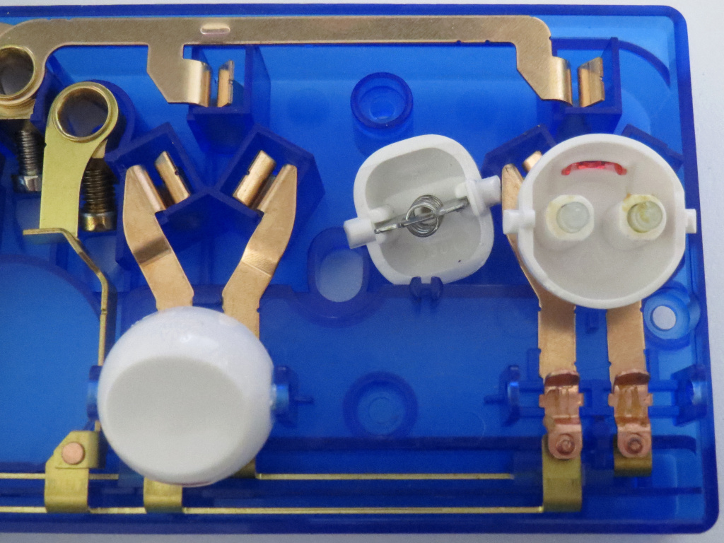

WBP4S inside, Clipsal 30M rocker for comparison.JPG (308.91 KiB) Viewed 99356 times
The red dot is an insert rather than surface marking (an approach common on UK sockets, but previously unseen here in Australia), so can never wear off; although I wonder if it affects the physical integrity (Clipsal rockers are thicker but still often cracked where the dot was stamped deep enough to create a weak point).
At least Hager have thickened the rocker plastic immediately around the insert. Stationary contacts are 2.6mm diameter (5.3mm²), moving contacts 3.1mm diameter to tolerate some misalignment. The barrier between switch poles could be taller (like in Omron's A8L appliance switch), but is no worse than Clipsal's. The incoming active and neutral busbars are 0.7mm brass, 4.6mm wide at the narrowest point (but 5.7mm across the top part); calculating to 0.9–1.1mm² Cu equivalent, which may seem low for up to 20A combined but should suffice (the CSG BS-POD10 survived with less than half the Cu equivalent).

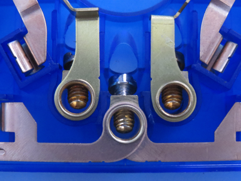

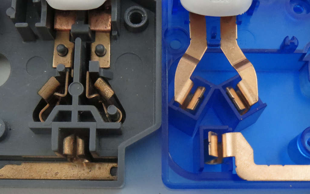

Socket contact comparison.JPG (235.1 KiB) Viewed 99356 times
Socket contacts are all 0.7mm phosphor-bronze in full-wiper formation (where the C2015D4's active and neutral are a half-wiper, half-scraper hybrid which might scratch away at plated pins).
It handled 2×11A fine and survived an overload to 2×16A (at least for the 10 minutes I tested) on top of that.

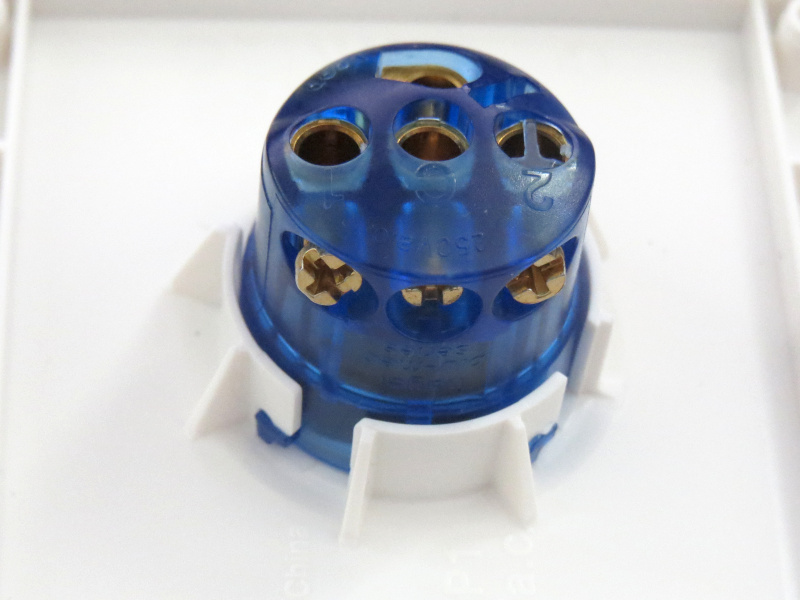

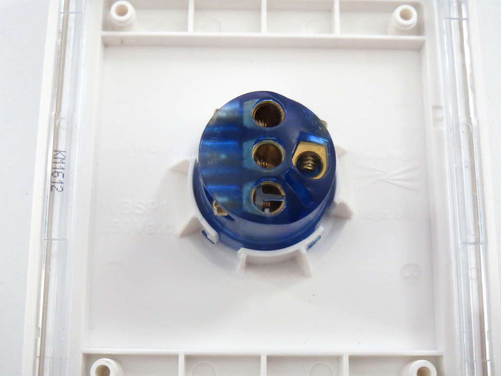

WBSV1 back.JPG (209.56 KiB) Viewed 99356 times
Hager's switch mechanism(s) are mounted by their nifty (and patented) Roto-loc system, which you can lock/release with either a dedicated tool (WBMS, as shown in the catalog) or 5.5×1.0mm bladed screwdriver in the provided slot; preventing push-back by vandals, without the fiddly screws traditionally added for that purpose.

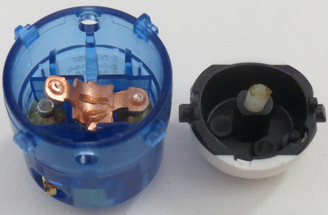

WBM16AX open.JPG (96.8 KiB) Viewed 99356 times
The rocker has a two-layer construction (some black plastic behind the white polycarbonate) presumably to provide the stated chemical-resistant pivots and arc shield; the outlets have simple one-layer rockers.

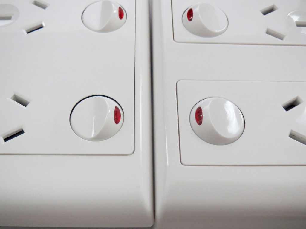

WBP2S left, WBP4S right
Rocker comparison.JPG (165.27 KiB) Viewed 99356 times
This was ordered online among three Clipsal items. The rocker shape is a bit different (two adjoining flats instead of the concave curve) for whatever reason.

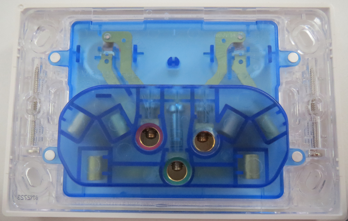

WBP2S back.JPG (300.81 KiB) Viewed 99356 times
The two sockets have 48mm between centers.
While riveted together (so I can't disassemble it without damage), the blue tint is light enough that I can see the active and earth contacts are brass here (only the neutral remaining phosphor‑bronze); so not quite as robust as the 4-outlet model, but still on par with recent Clipsal 2025 production (which has brass A/N, phosphor‑bronze E and is clipped together) – and the WBP2S doesn't use the solid neutral terminal as half of a socket contact, if that helps.
Shutters seem to be the same design (I can locate their springs with my magnet stack), although a bit rougher to open initially (these can take a bit of a break-in).
